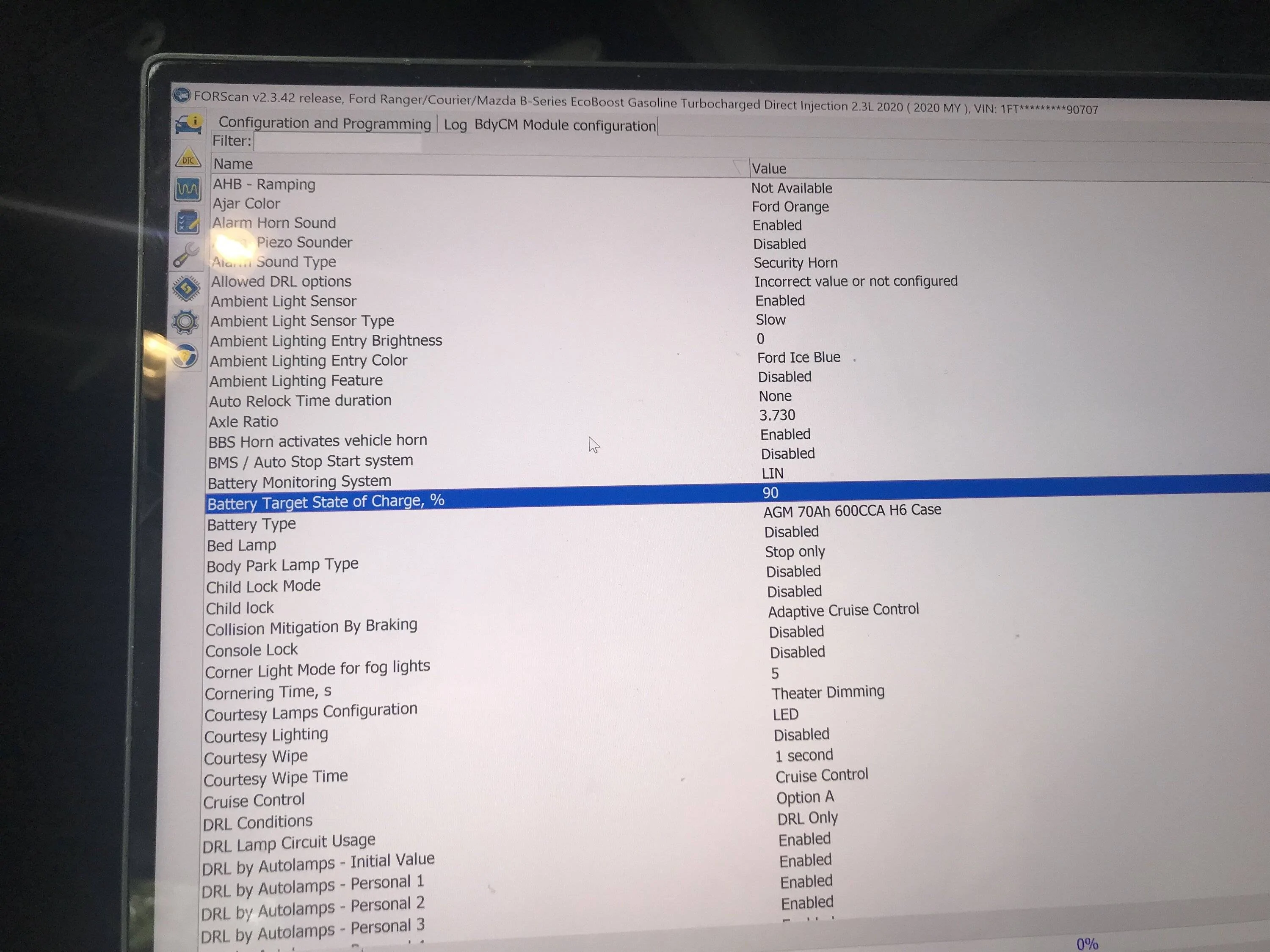

Just played with forscan for the first time. Enabled bambi mode, got rid of the double honk when exiting, disabled fake engine noise and lastly upped the battery charge level to 90%
I couldn't figure out how to up the battery charge level? Could you possibly help me out?

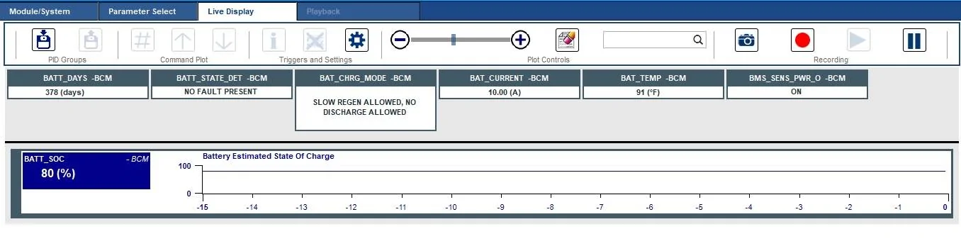

I do have a question for you, just a curiosity question, I have an Autel scanner and Forscan but neither will display the actual PID Battery SOC, does IDS display that PID for the Ranger like it does on the F-150?
I am just wandering if the PID is available or just not programed withing the BCM like the F-150 and other platforms are.

As for the battery pid i will check fdrs next time I have the truck in

So yes FDRS does show battery soc see the attached screen shot for all the battery pids.

OK, thanks, all I can get to display is battery voltage, temp and amp along with the other related PID's, but I was just curious if I could get the SOC, Since I know it is an available PID, I just need the correct software or scan tool to do it. No big deal as just have to convert the voltage over to the SOC chart.
