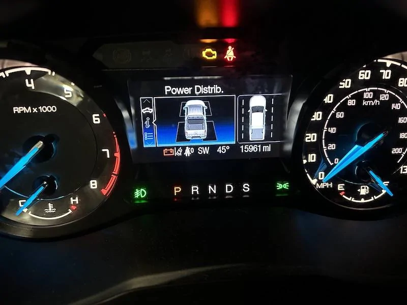

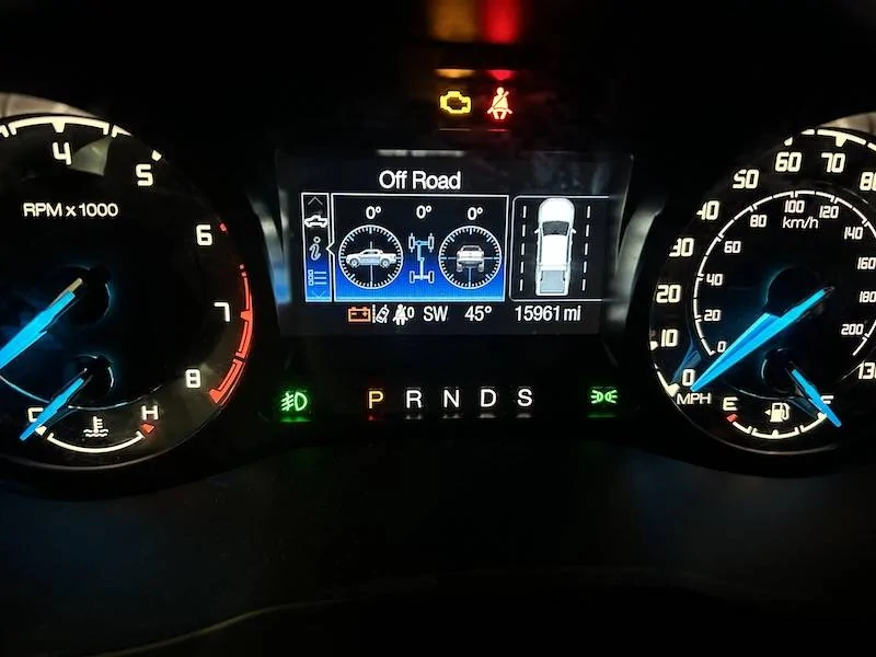

You should have both off road (angle) and power distribution screens active and working with the factory FX4 package. Both screens work fine on my 2020 XLTFX4 and all other FX4's I'vs looked at.
The power distribution screen will only show distribution between the front and rear axles. It will not show distribution to each individual wheel.
Here are the screens again.
Both screens should be available and fully functioning with all Rangers with the FX4 package.

The Power Distribution screen on a Ranger is a useless function. In 2wd you will see 0% to the front and 100% to the rear. In 4x4 you will see 50/50. My 21 Lariat Tremor does not have the power distribution screen.
Since there is no center differential like an AWD vehicle 1/2 the power goes to the front axle and 1/2 to the rear all the time in 4x4.

For whatever reason, I do not have power distribution screen on my 2019 Lariat FX4.
I am at a loss on why some of you do not have the power distribution screen with your FX4 since it should be available and working.
