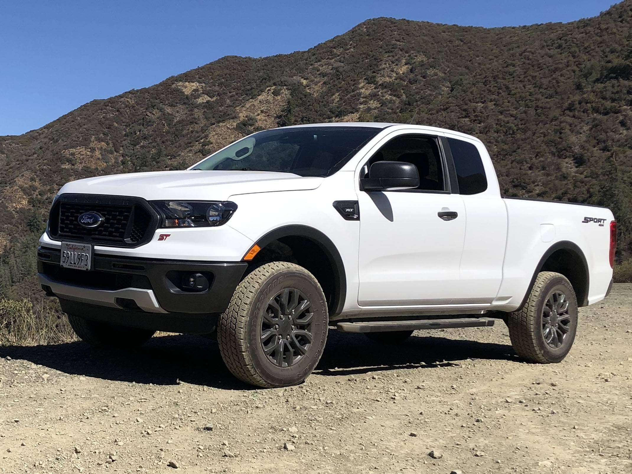

I did the same as you, just minimal changes.
I added the courtesy wipe (extra sweep of the wipers) after you use the windshield washer. I too paid for the license. It's only fair if you plan to keep the changes.
I chose the ST splash screen as I had some extra ST badges when I did the ST Octane Academy with the purchase of my Focus ST3.
I've got a fake badged Ranger ST. When I took it in for the first service, the dealer said he'd never seen a Ranger ST. I told him how I came to own and install them.
