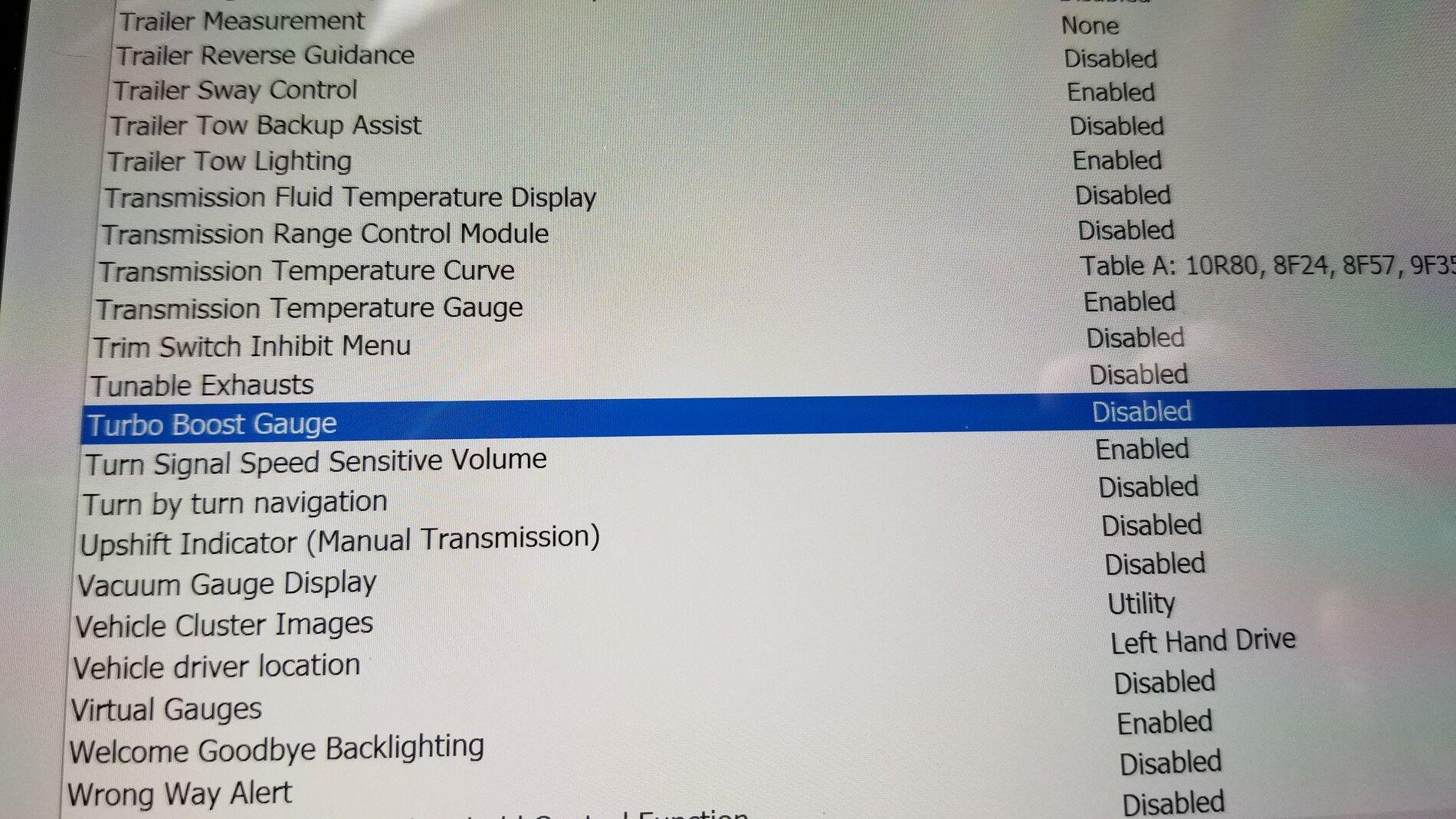

ah I' don't have the FX4 package. I cannot scroll on that screen. I'll take a look.
I edited my response, I meant up and down, not left and right, but without the FX4 package I think the gauges aren't on from the factory.

ah yep - i tried everything. only button that responds on that page is left, exiting. Will enable it and give it a try.

I turned on the off road screen for showing incline an hillside degrees of the angle. I don't have the fx4 package. I think I just threw away the cheat sheet I used. I displayed the screen once after activating it but I didn't drive it so I don't know if it actually displays any real data.
I've used it pretty regularly on my non-FX4 truck, it does work by showing the appropriate information, which is really helpful offroad.

Software Engine Sound EnhancementDisables the "piped in" sound through the speakersACM
