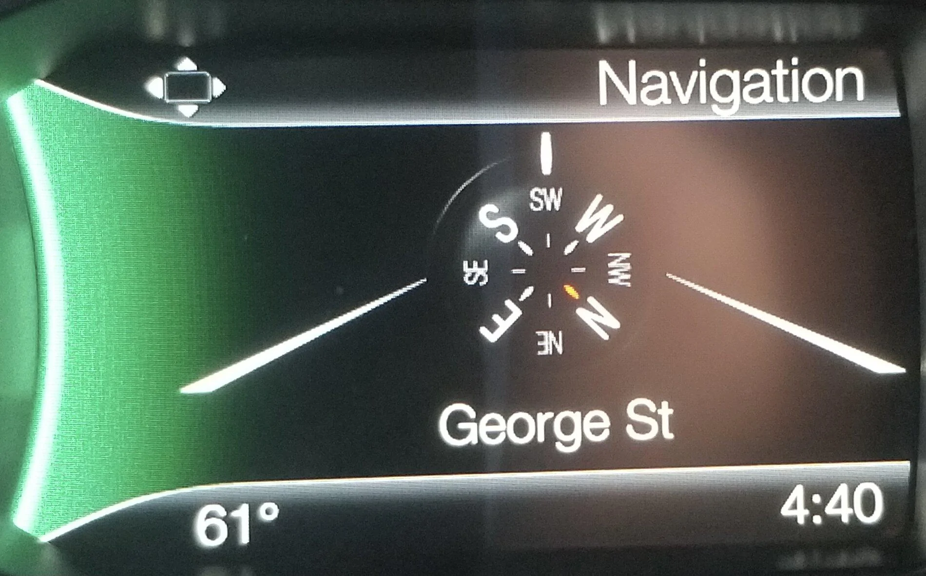

Lets try this again!! When I made the mod for traffic sign recognition to show speed limits, it took the speed limit sign off of the navigation on the right side (See pic below) of my dash. Can you get both to show up?
Before
After
Before View attachment 74973
After View attachment 74971
Your after pic does not show a street name like the before pic. I would not expect a speed limit to display unless the system is also displaying the street/location and nav knows the speed limit. So, I can’t see how the two compare......
in this right upper corner no speed sign.

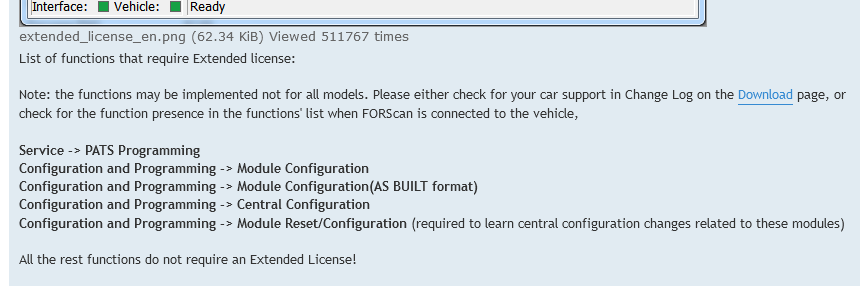

so here is a copy and paste of Forscan text, also a screen shot. My question is- if i only want to toggle off or on certain OEM features (kill all horn honks, enable Bambi mode, adjust my speedometer, kill the fake engine noise etc) do these items require the extended license ? in other words are they considered module configuration,AS BUILT, central config or module reset /config? I do not mind buying license if i have to but i don't want to waste the money if i do not need it. I ordered the module off Amazon, should arrive soon, i have yet to download the windows software.
Service -> PATS Programming
Configuration and Programming -> Module Configuration
Configuration and Programming -> Module Configuration(AS BUILT format)
Configuration and Programming -> Central Configuration
Configuration and Programming -> Module Reset/Configuration (required to learn central configuration changes related to these modules)
All the rest functions do not require an Extended License!
Screenshot_2021-03-17 Standard and Extended licenses for Windows - FORScan forum.png
Basically, if you want to make any changes such as those you mentioned you need an extended license. Without the extended license about all your can do is check and reset error codes that turn on the check engine light.
You can sign up for a free 2 month extended license or you can buy longer ones. Your choice, but we'll worth it. Cheap and support continued development.
And the license is NOT tied to your truck so you can use it on any Ford vehicle.
