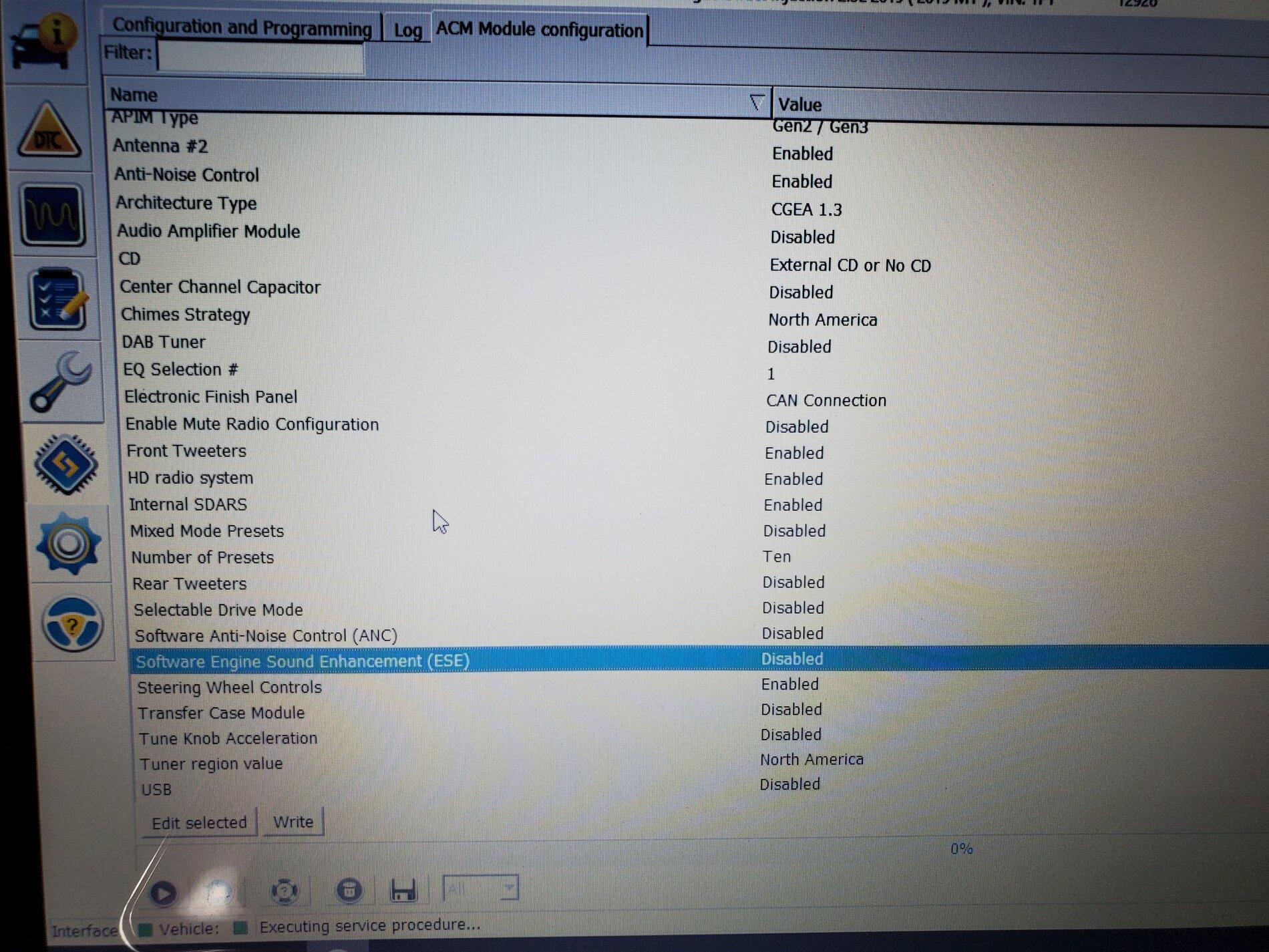

I used Forscan for the 1st time this weekend... among all the little things I changed, the most important one by a long way was this:
I don't know if this is new to this release, but it definitely works and my subwoofer now sounds like it's supposed to.
