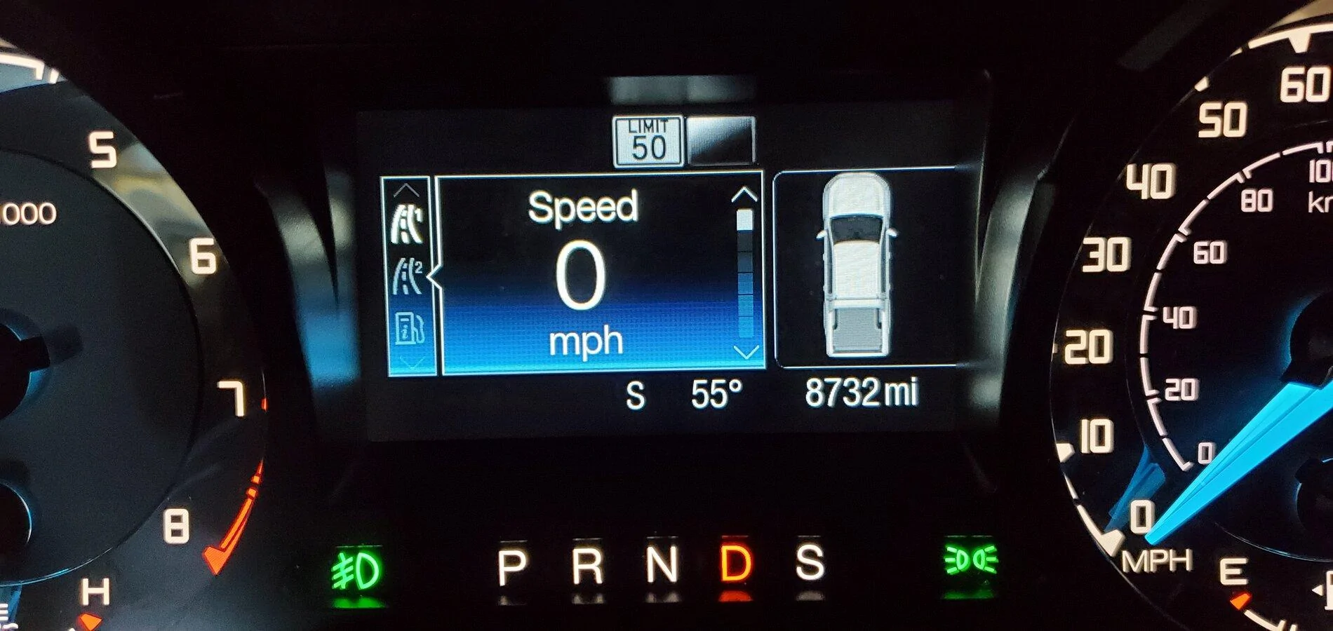

Areospace
Interesting, I haven't seen anyone post seeing NA signs like that! Wish I could get mine to do it. Does it flash at you if you go over your tolerance setting?
Setup it up this morning and I have the NA signs. Yes it does flash when you go over your tolerance setting. I have a 2020 XLT Sport with the 301A package.
Thanks, must be a 2020 MY thing to get the NA signs, looks cool though. Which I could get them on mine. Probably an IPC firmware update.
Mine also sounds a single chime.
