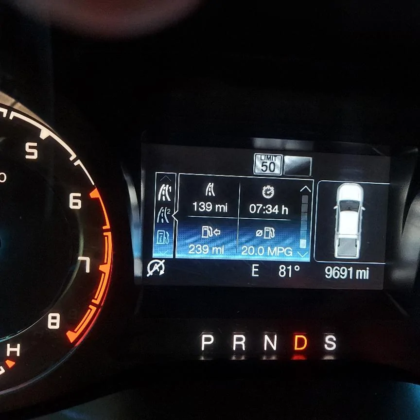

I did the change, and now I have US signs on the display. I have two questions: 1) is there any way to make the sign brighter? It's hard to see in the daylight (at least for me), and 2) what is the 2nd block on the right for?? (Picture attached)..
