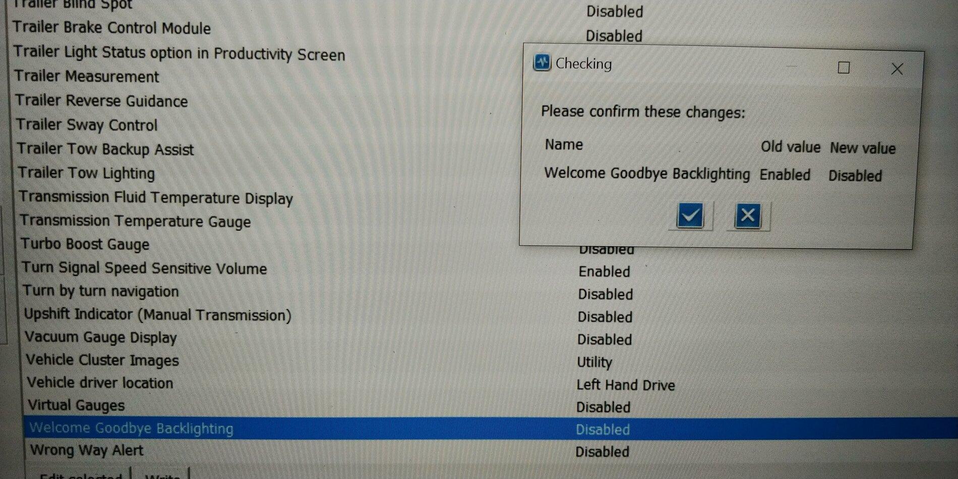

How did you get all the chimes to turn off? I can't seem to get rid of all of them
In Forscan;
Load IPC:
Chimes Veh run door open enable/disable
For startup chimes click, in IPC 'As Built' line 720-01-02 XXXX X2XX (change to 2 from 0, all 'X' stay unchanged)
I also got rid of the piped in engine sound, changed the splash screen to 5 (Raptor), got rid of the start-up Goodby backlight, enabled 'Bambi mode', turned off auto start/stop, and enabled the auto relock to 45 seconds.
