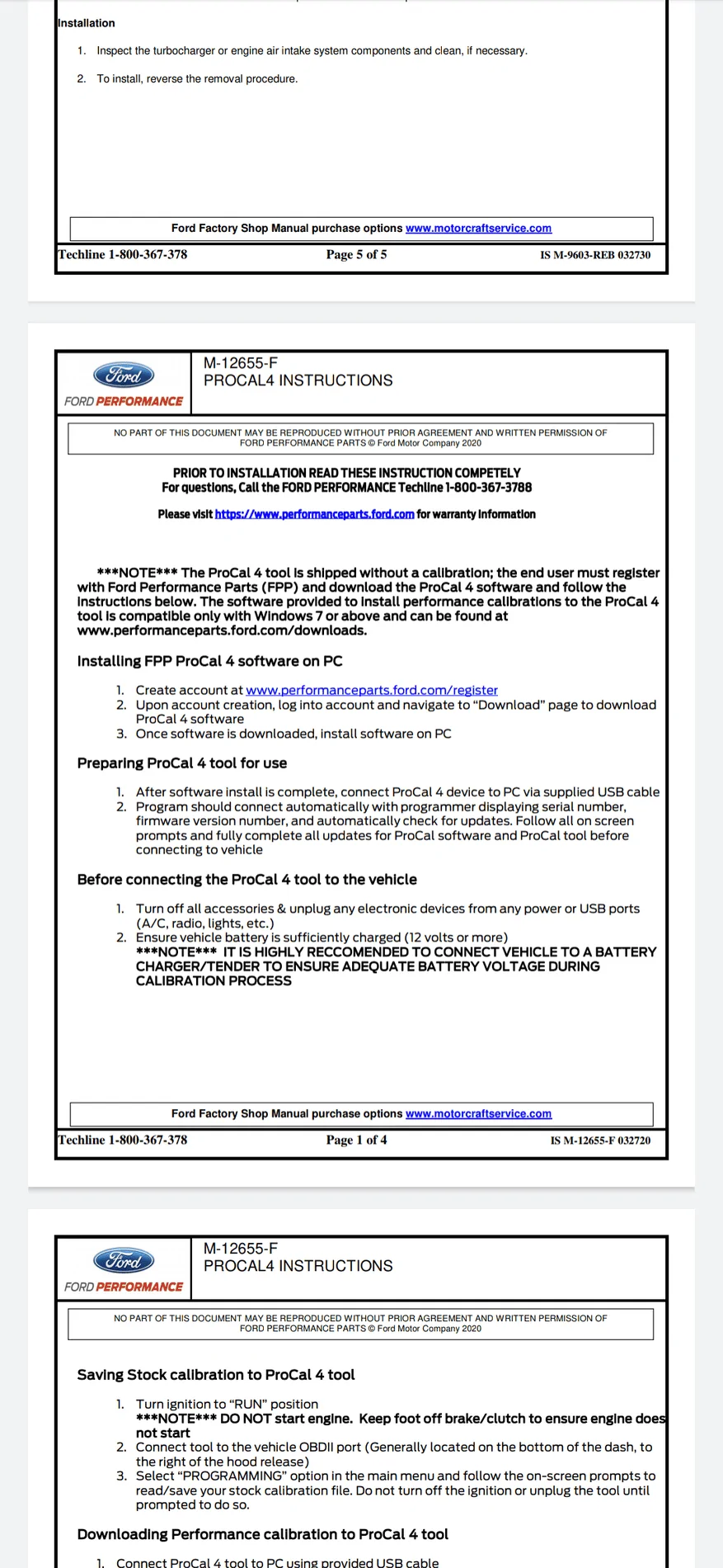

So here is a page from the instructions on the Pro Cal 4. Most likely similar for the Livernois my touch calibrator. With that software on your computer you should beable to refresh your Pro Cal 4 and beable to revert back to stock with no problems.
Again been trying all this for months and the problem is on Ford's end! They can't figure out how to resign all my original files to the new pro Cal they sent!
Try all this every weekend and they've still got no files for me to download!
Just gotta wait till they figure it out!
Wish they would've used Cobb accessport as it was zero problems on my RS!
This was email from Ford 3 months ago!
Second, our engineers are working on getting the stock calibration “assigned” to your new tool. They are experiencing some difficulty at the moment, because the original stock file was already assigned to your stock tool, and they have never had to “re-assign” a calibration before, so they are having a bit of difficulty. They will get it accomplished, and it will be all set for you.
