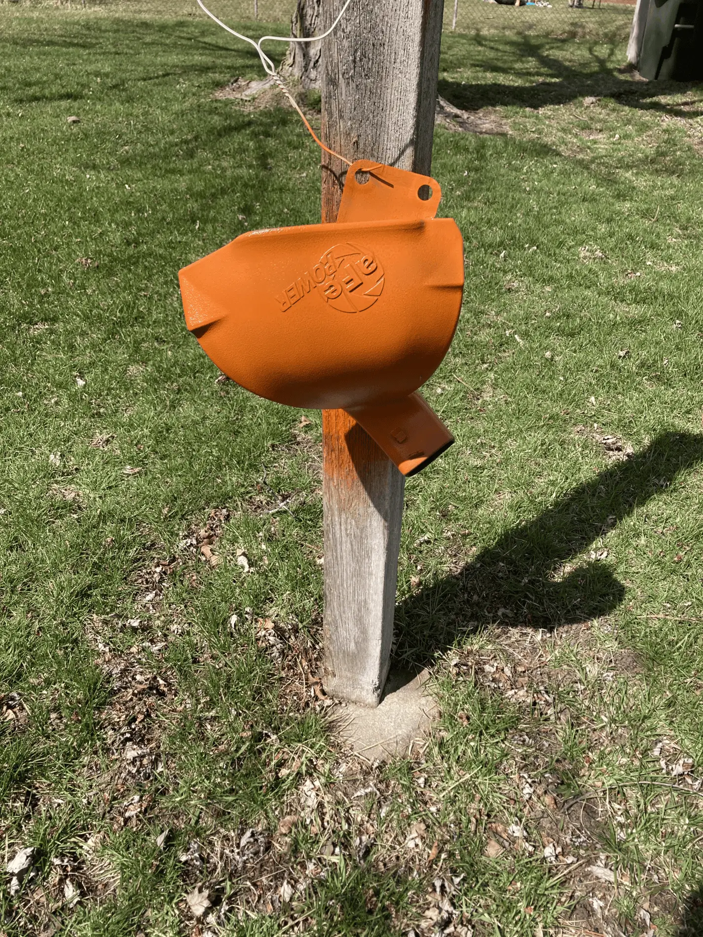

Thank you Sir. I was all caught up on my mods and now it's a beautiful day in the neighborhood so I'm spray painting my aFe.
