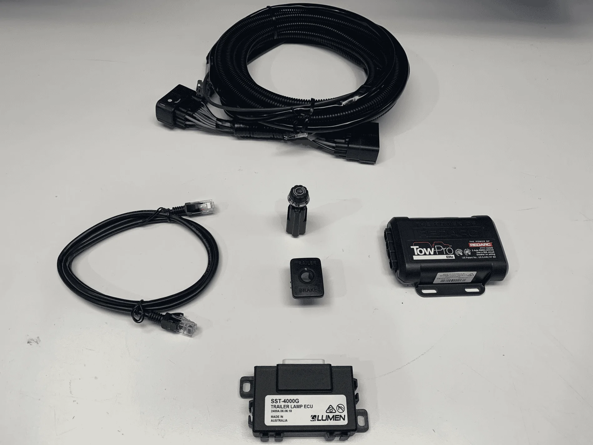

I just recently had the Ford Ranger model VKB3Z-2C006A Lumen NA electric brake controller installed. I have not had a chance to test it out but I think I am going to like it. It seems pretty slick and easy to use. I still haven't paid for it yet but it should only be about $340 with the install being $150. They cracked the plastic on the side of the entry way so they had to order that. The dealer originally installed another brand not the one I had special ordered especially for the Ranger. So I had them take that out and install the Lumen NA one and install the correct one. I go back this afternoon to pick it up as they got the plastic piece in. I am going camping with my Tent Trailer next week so that will be a good test.

Seems the new redarc one supports this: EBRH-ACCV3-NA
From what's in the manual for the new RedArc v3, it doesn't seem like anything's actually changed in this regard. They mention AEB but the wiring diagram seems to indicate that you would still require something like the Lumen module that Ford's OEM package includes, which is used to source the brake light trigger.
Right on - just a heads up though in case it might be confusing to others reading: the VKB3Z-2C006A isn't a Lumen brake controller, but a standard RedArc TowPro Elite brake controller packaged with a Lumen module and harness:
In theory the Lumen module could be used with any brake controller, if it could be purchased on its own. All it does is tap the brake lights, sending a 12V signal to the brake controller when the brake lights are on, and 0V otherwise. The wire from the brake pedal works similarly.. it sends 12V when the pedal is pressed, and 0V otherwise. The difference is that the pedal doesn't get pressed when AEB or ACC are the ones trigging the brakes. The brake lights on the other hand, get activated no matter what triggers the brakes.
