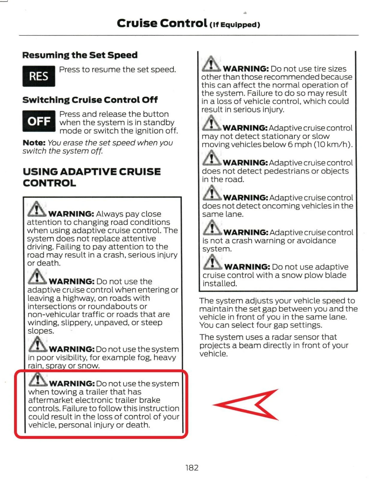

Page 182 of the 2019 RANGER Owner’s Manual (3rd Printing, April 2019) the following warning appears:
USING ADAPTIVE CRUISE CONTROL
WARNING: Do not use the system when towing a trailer that has aftermarket electronic trailer brake controls. Failure to follow this instruction could result in the loss of control of your vehicle, personal injury or death.

Does anyone know the location of the AEB Trigger wire?
