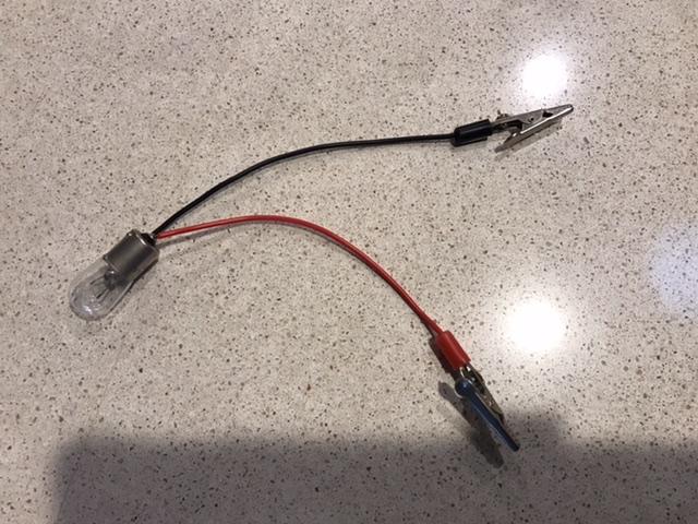

I agree. The Redarc installation instructions include a test process to make sure it activates without having a trailer involved. It involves a jumper across two of the 7 pin connectors and a simple brake application. If it is functioning properly the Redarc knob will light up. This and the bed sheet would be a safe way to try it out and settle the debate.
I can not seem to find this test procedure in the manual. Can you paste in into this thread please.
