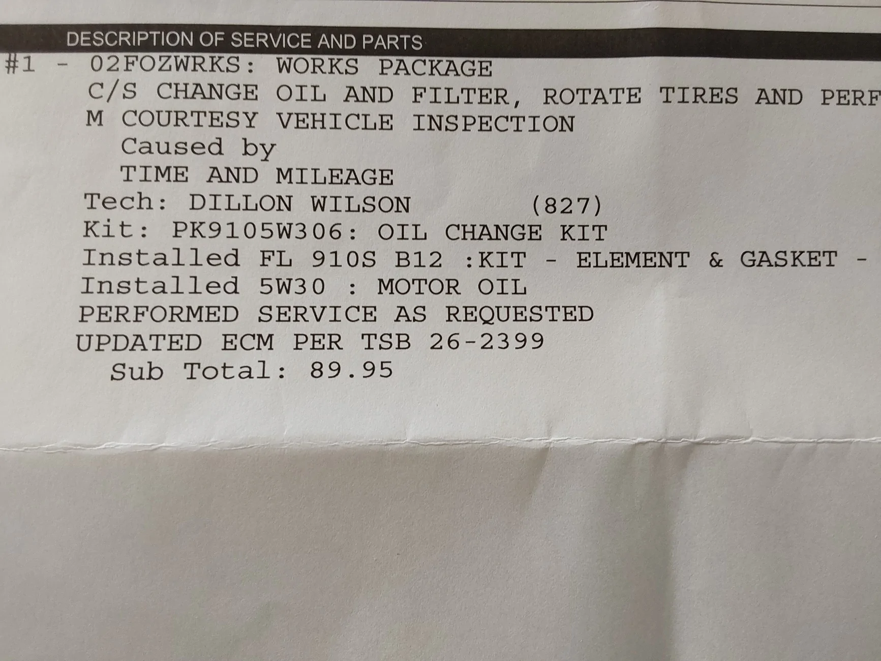

Eeewwww. It would be interesting to see what that tests at. But it’s obvious there’s something going on. Make sure the dealer sees it likes this. Maybe you won’t have to do the 1000 mile ā€œverification ā€œ step. I’m almost certain it’s the HPFP.
Well, this dealer looked at it and documented it. They drained about 1/2 quart extra and contacted Ford. They were instructed to update the ECM per TSB 26-2399 that addresses injecting too much fuel on startup that should solve it. If it doesn't then I bring it back. Atleast it's documented now.
Glad they’re paying attention to it. Can’t find anything on that TSB on Ford or NHTSA sites.
I couldn't either. They said it addresses the problem of injectors putting too much fuel in the engine on cold starts. Sounded like it came directly from Ford. Atleast the exhaust doesn't stink like gas when started now. I like this dealer, they didn't blow it off as normal and said bring it back if it still happens. They also are $30 cheaper on an oil change/ tire rotation then the dealer I bought it from.
They were unloading a new white/tan F150 King Ranch while I was there and luckily it was a special order and sold. It was beautiful and I probably would have bought it šŸ˜†. 10 steps up in quality over a Ranger.
That’s good you found a better option in a dealer. Really curious to read up on that TSB. Especially a ECM software change. I mean how could a calibration go bad ? Unless they know something we don’t ( like the 10R80).

This is what they did. Was yours updated when they replaced the fuel pump?
If they did it wasn’t stated on the repair order. But I didn’t have the gas smell in the exhaust either so maybe they’re two different things. Has your exhaust had the gas smell always or did it just come on recently?
It seemed to start at about 4k miles when the oil level started rising.
