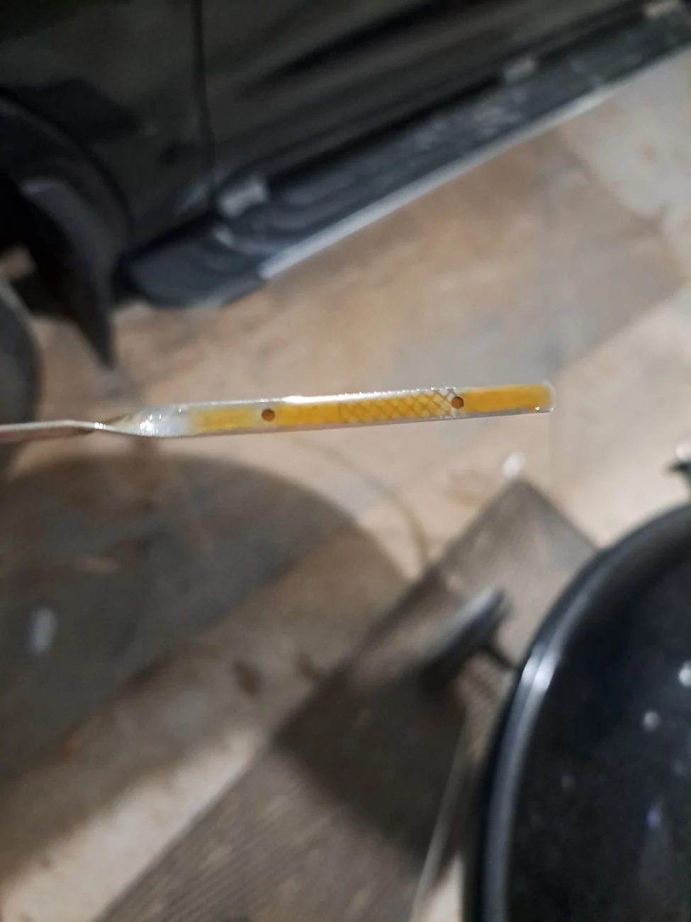

Mine was around 1/8” plus over and it tested at 8% fuel which equates to around 14 oz.
Just checked it again today after sitting in the garage 2 days so it's cool and drained back. Up about 3/8 inch and stinks.
Eeewwww. It would be interesting to see what that tests at. But it’s obvious there’s something going on. Make sure the dealer sees it likes this. Maybe you won’t have to do the 1000 mile “verification “ step. I’m almost certain it’s the HPFP.

Last oil change they said that's normal for these engines at Vanbortel ford. I'm trying a different dealer this time.
Elevated level that much with 2000 miles is NOT normal. Sadly you have to force the issue. When I showed my dealer my oil sample at 8% fuel with 534 miles on the oil they tried the same crap. One of the service advisors handed me this “ fuel dilution guideline” sheet. When I told them that mine was double of the severity level 4 with only 534 miles I got the deer in the headlights look. They didn’t know what to do. Long story short what got them to do something was the elevated level at low mileage on the oil. They still had to get Ford to ok the process.

Got an appointment for the 17th at a different dealer. They will look at it, didn't sound like a common problem to them.

It’s not a common problem but it does exist. My dealer and the tech hadn’t seen it before on the Ranger. I had even messaged Mason at Flying Wrenches YouTube channel to see if he had seen it before and they hadn’t. But there’s been a couple other forum members here that have had this happen.

That's the cleanest looking oil I've ever seen being that it has miles on it. Almost bizzare.
I must agree, but I own a diesel. Even the 3.2 Ford powerstroke in my Range which is actually a pretty clean burning diesel, the oil is black about 5 minutes after a change.

I think it's 25% gas. Ford synthetic was put in it when they changed it. Basically went from almost clear to amber.

Does that engine temp ever run hot? It's almost like the oil isn't circulating the in the engine.
I don't know, there is no temperature gauge. Seems to run fine, just makes oil. Only about 1800 miles on the oil.
