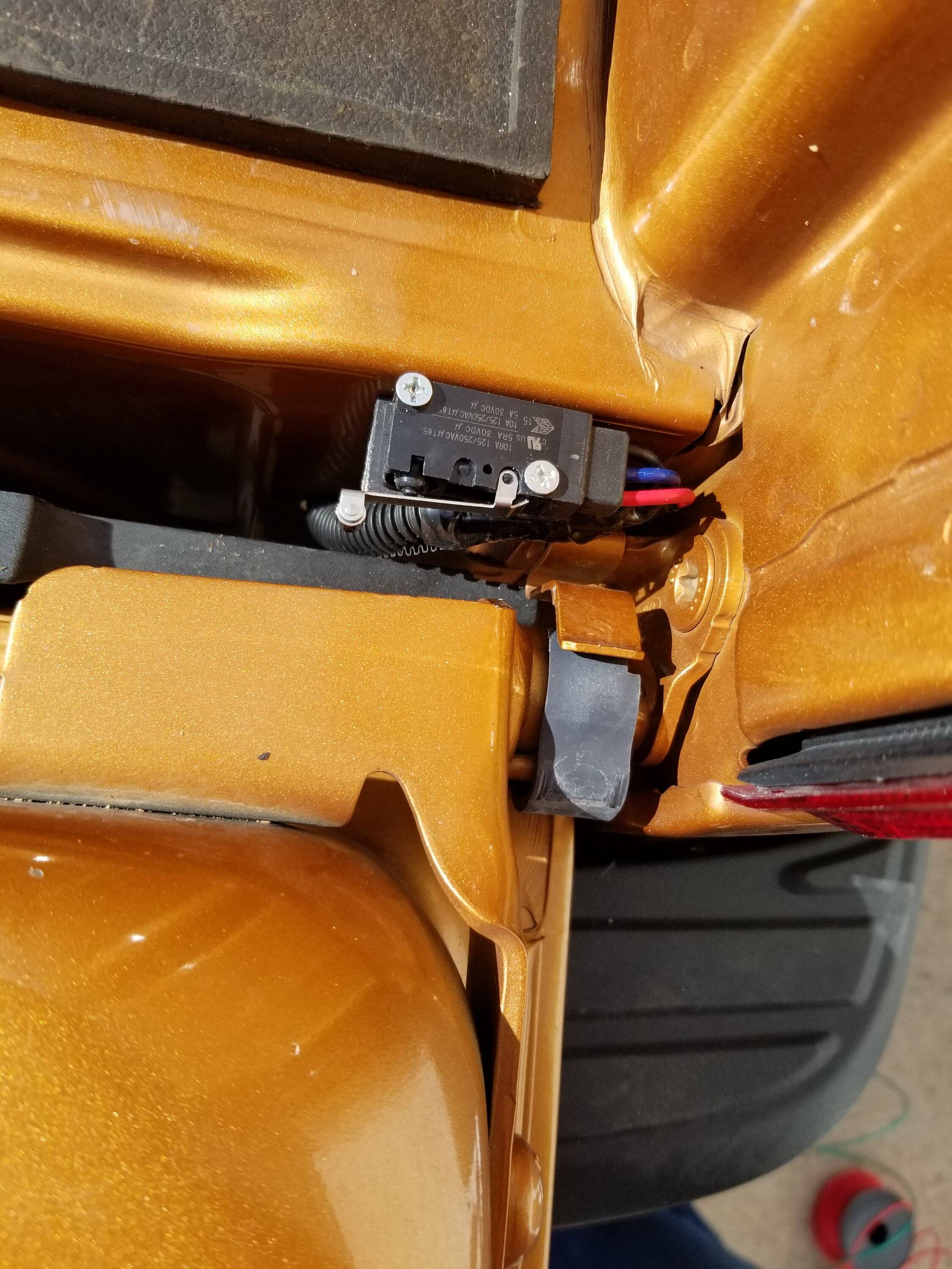

Switch to activate perimeter alarm if Tailgate is opened

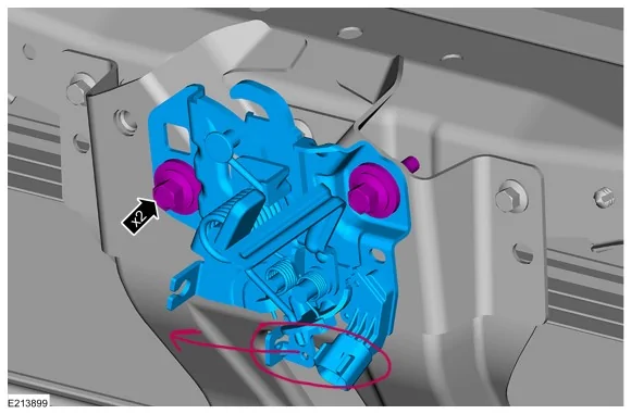

Yes, that was the tought I had. I will add, that if you are wanting to make an easy to install kit for others to use, I would look into the idea of just getting male and female connectors that are compatible with C127 at the hood switch, then just make a T-harness that you plug inline between the hood switch and the harness there.
Code:
hood        2 ---------- 2     harness to BCM
switch      1 --      -- 1     harness to ground
         to new switch at tail gate.
If you have no plans to update to a Pi for selective control of that (only allowing the tailgate to activate that open signal if opened after arming) an even simpler way would be to use a ground at the back and have that replace the ground going into the hood switch. Also, if you can get pins for the connector you disconnect when removing the tailgate (maybe C411) you can add those to pin 7 (if it is C411) so it looks almost OE if you wrap that wire with the harness. But if you remove the tailgate you may need to update the dummy plug for when the tailgate is removed to jump pins 5 and 7 (again if C411) so that the hood switch still works while the tailgate is removed.
