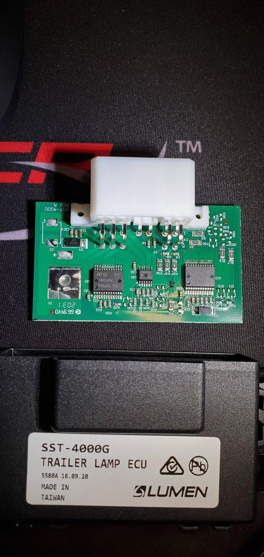

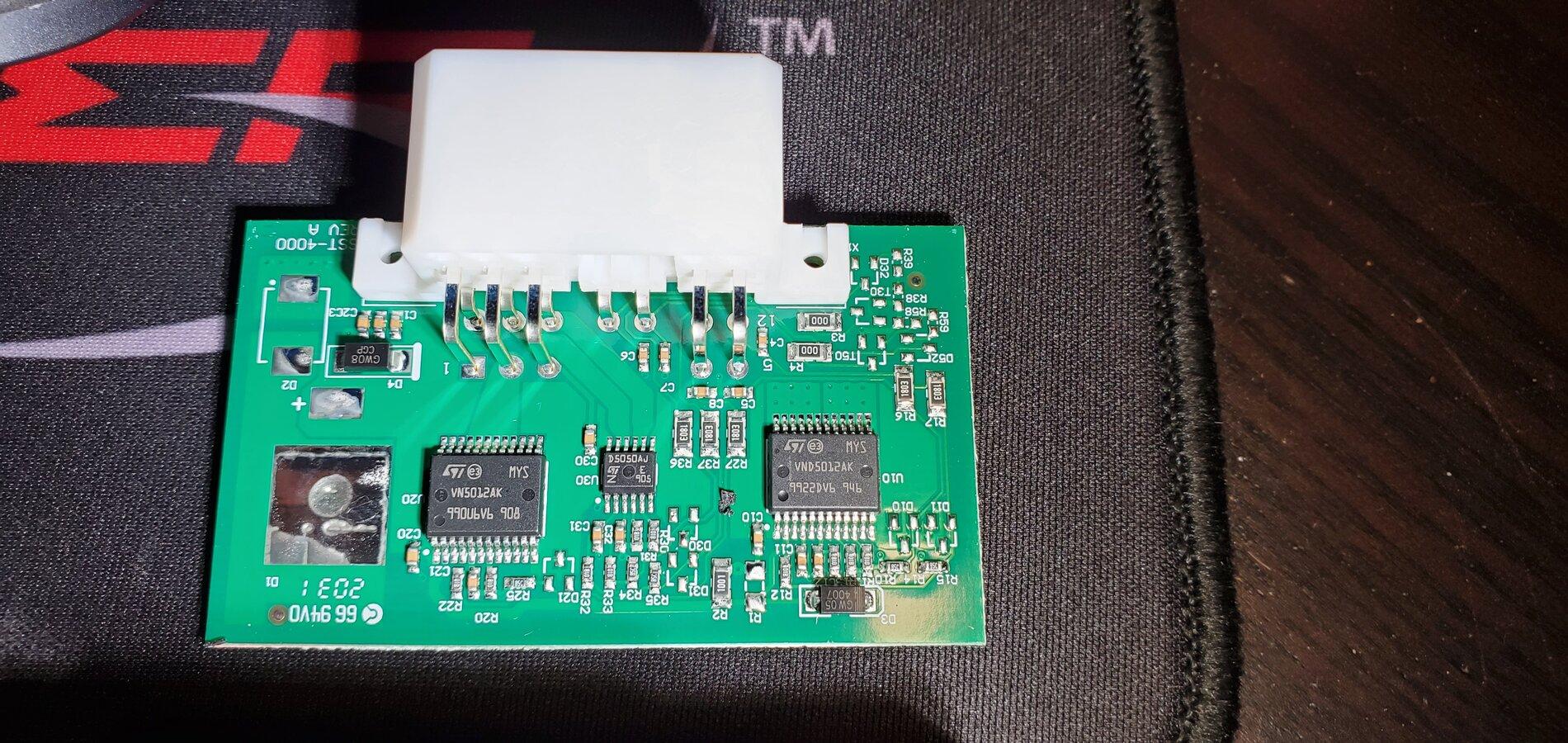

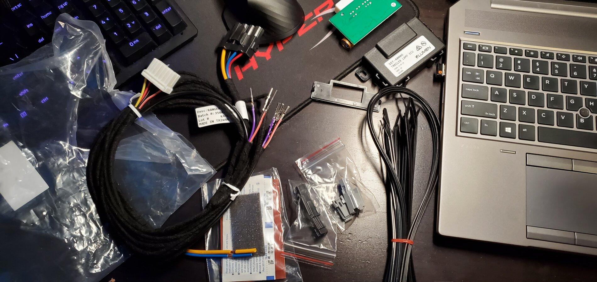

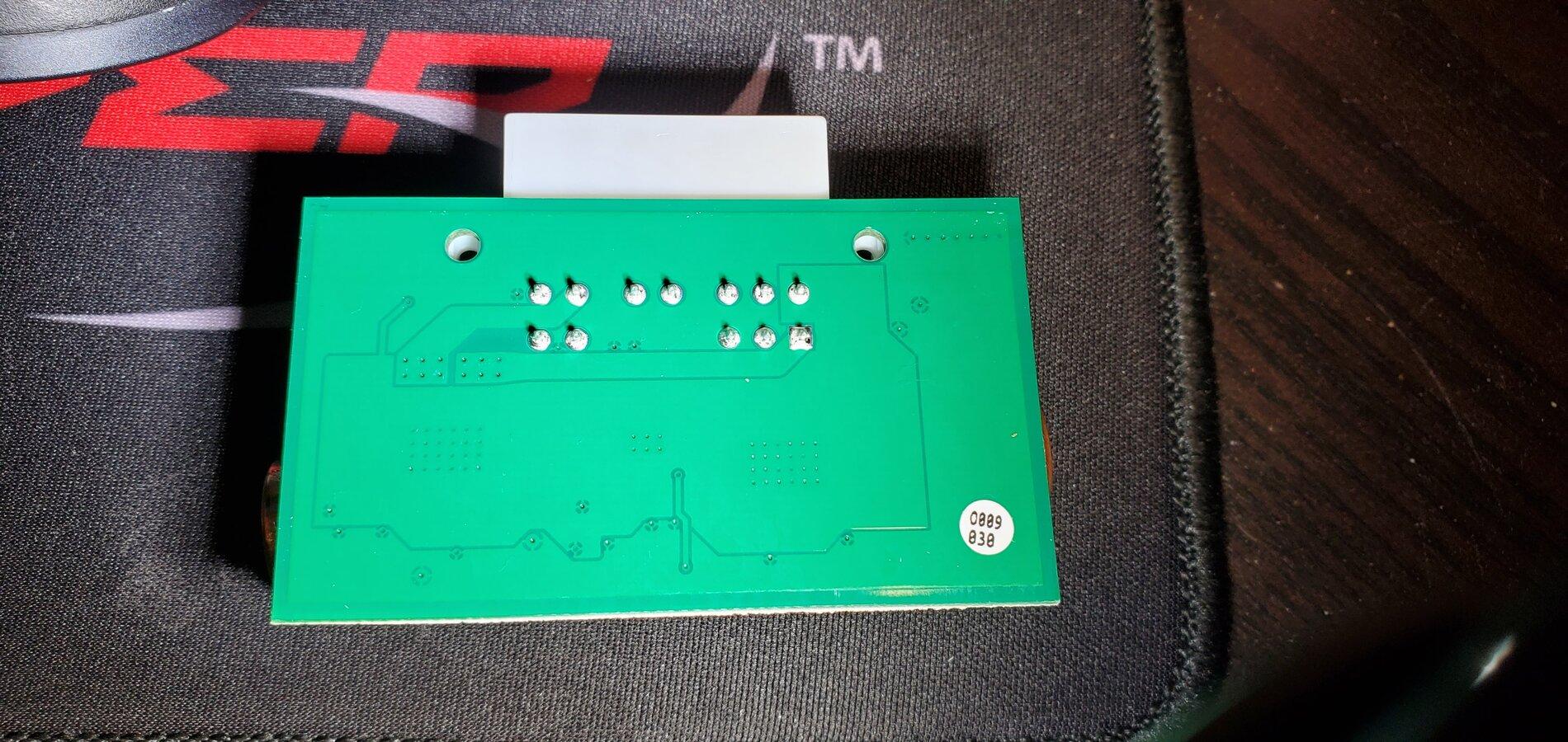

I tore down the inline module that comes with the Ford version of the kit. I put my notes below from a post i made on FB...
Trailer Brake Controller Kit (Official) info --
For those interested, I got one of the ford official RedArc kits. I already have one, but they don't sell the "brake light interface" part of it standalone. Luckily my dad needed a brake controller for his 2014 Pilot, so I'll give him mine, and install the full official kit in the Ranger this weekend.
Otherwise, I figured I'd take a detailed look at it since I was curious as to how they built the inline brake light interface. Honestly the whole system seems needlessly complicated, but at the same time, the only option since someone at Ford obviously forgot to figure this out before production.

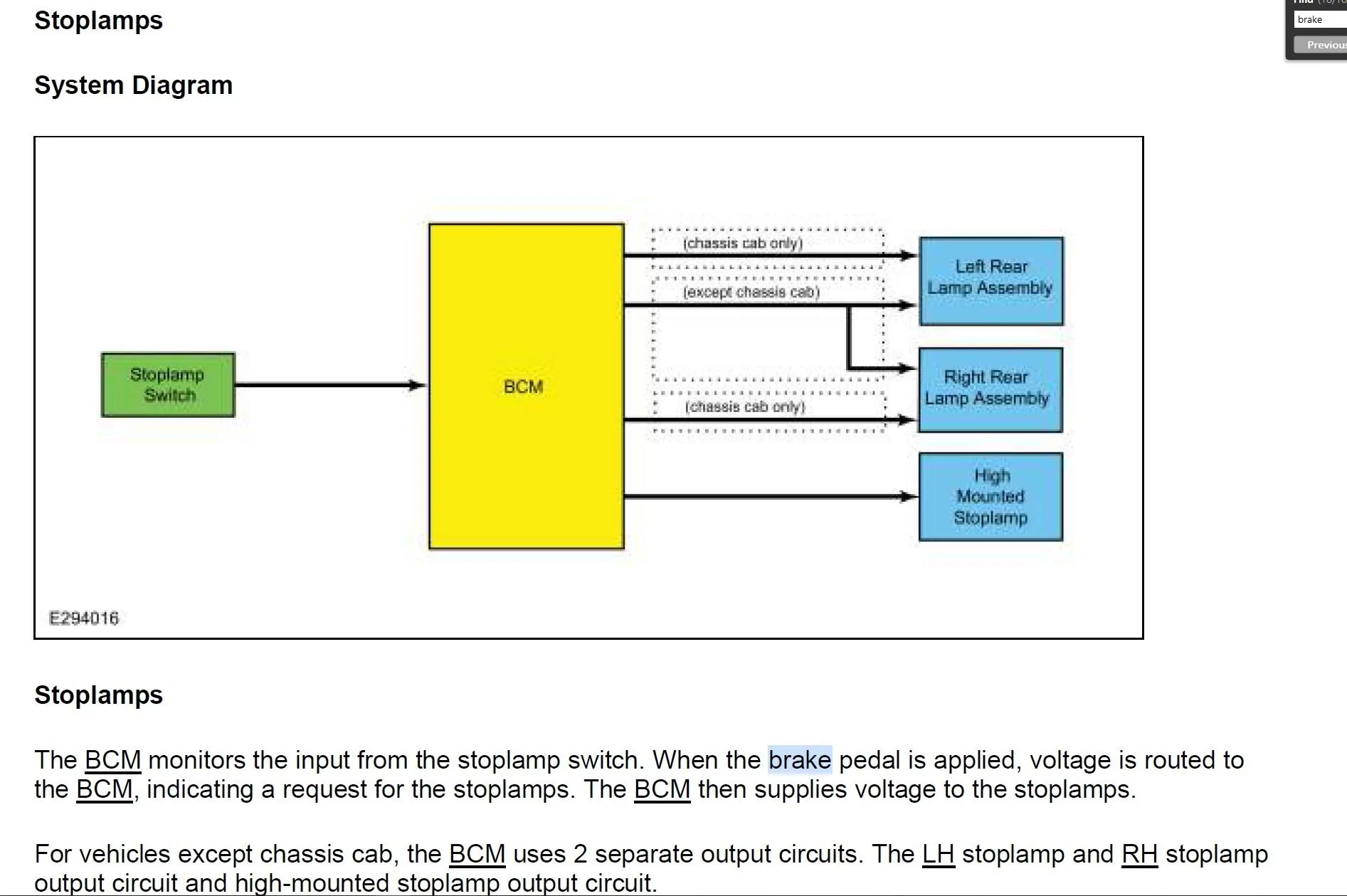

Essentially what the kit does, is instead of taking the BRAKE signal directly from the pedal (which is what the current "Red Wire" out of the 4 does) it pulls the "Brake Activation" signal directly from the rear HRMBL (high rear mount brake light).
Why does it pull from that one? Well, it appears that it is the easiest way to get that signal, without going outside the cabin, and without spending more $$$ on building a CANBUS interface to read the activation.
What's inside the little box that connects between the brake light harness and the brake controller?
I figured it woudl either be a simple Opto Isolator or transitor setup for the signal. But it turns out it's a bit more complicated than I thought. They are using a "Digital Switch" N-Channel Mosfet chip and another Power Driver chip to basically read the signal from the light, and switch the "brake" input into the RedArc. So with this setup, the original "Brake Input" wire under the dash is not used, as that only took its signal from the brake pedal directly, and thus wouldn't know whne the vehicle automatically aplied the brakes.
The harness literally goes in-line with the rear brake light, just to get the signal.

Thanks for the additional information, it helps. I agree Ford really screwed up on this one. I just hope they learn from this and don't repeat it in future trucks.
I have the official Ford kit too, but I haven't installed it yet. I'm not looking forward to running the wire to the third brake light, so I procrastinate... That and i haven't figured out which brand of trailer to buy yet, so nothing to pull yet.
Thank you for sharing. I assumed there was some logic to using the CHMSL wiring, but what I'm missing is why we need to tap that wire at the end of the wiring loom at the actual light instead of closer to the BCM. There must be eight feet of wire been the CHMSL and the BCM. I'm not looking to leverage the factory tow wiring just looking to find a shorter path to attach the lumens box. The wire has to come from somewhere.
Likely Ford/Redarc went for the place where the wire was already exposed and not likely to be mistaken for the wrong wire, I get that. My engineering curiosity just is looking for a better path. ?
Because ford doesn't trust dealer mechanics to cut into the wiring loom. Given all the horror stories we've seen, that seems like the correct decision.
