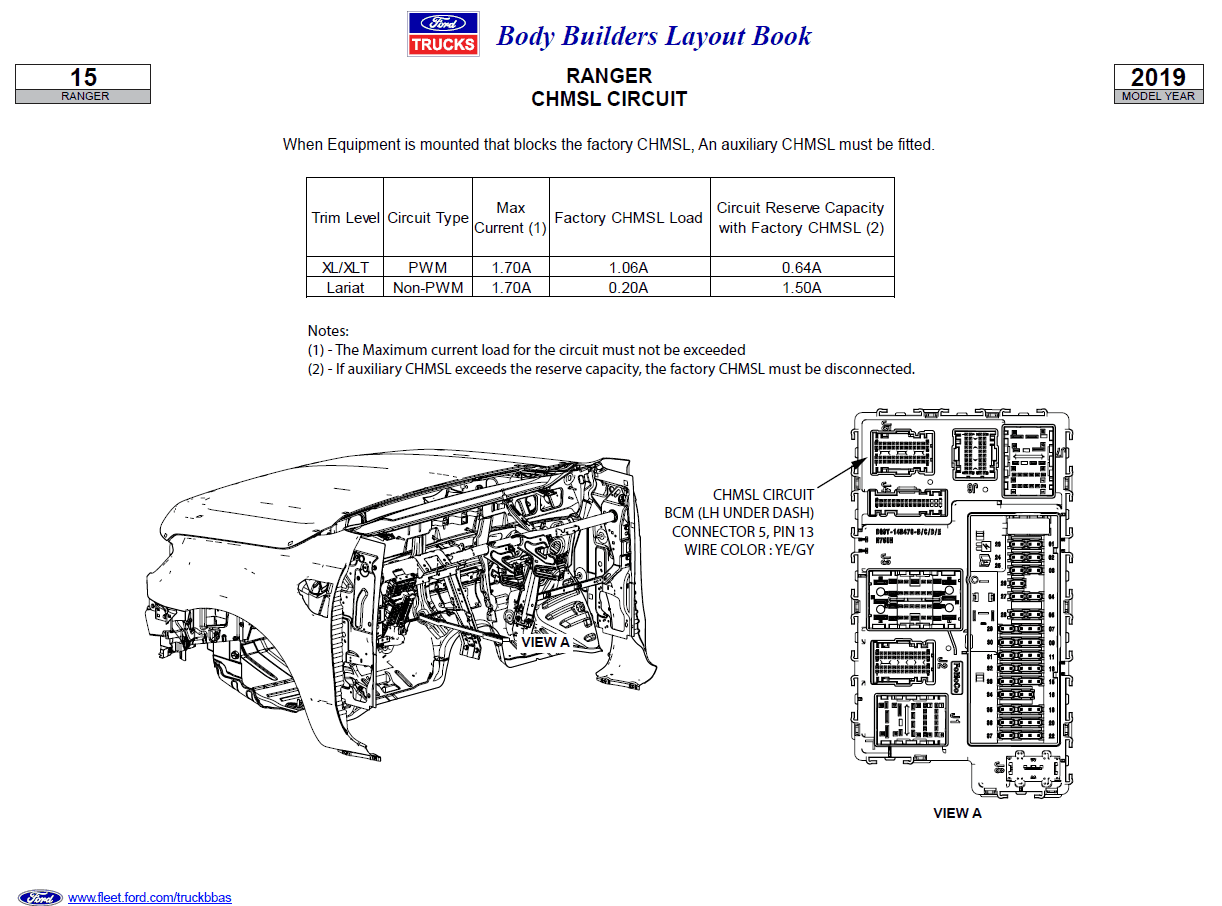

I just found something that will help you guys about to tear your interior apart to access the CHMSL feed. This is straight out of the Body Builders handbook (think service beds, etc). Now you know what line to connect to, under the dash, rather than going to the back of the cab. source
When I saw this my first thought was "Why did they go for the CHMSL?" Well, there has to be a reason because whoever designed this surely knew about the feed point at the fuse box. My guess is that the wire lengths, loads, etc. are such that they had to do it at the box for it to work correctly, unless they are total dumbasses (certainly possible).
That all said, whoever tries this and gets it to work, please post ASAP :like:

If you are doing the VKB3Z-2C006-A install anyway, it is easy enough to test this concept without tearing up the trim to get to the CHMSL. Of course, you might blow out a module...
PS
I'd guess it's because they didn't want to cut a wire, or put something inline to that entire connector. But then there are also three wires going to the ECU...CHMSL, ground, and...? Maybe the bed light? But why run that all the way back and forth? So strange.
Good point, but there are all sorts of piggy-back and knife-edge adaptors to tap into the FB fairly easily and cleanly.
Could also have to do with some obscure DOT regs because it involves an automated safety system. LOL, we may never know!
Ford is probably (rightly) nervous about screwing with big multi-pin connectors after the recalls.

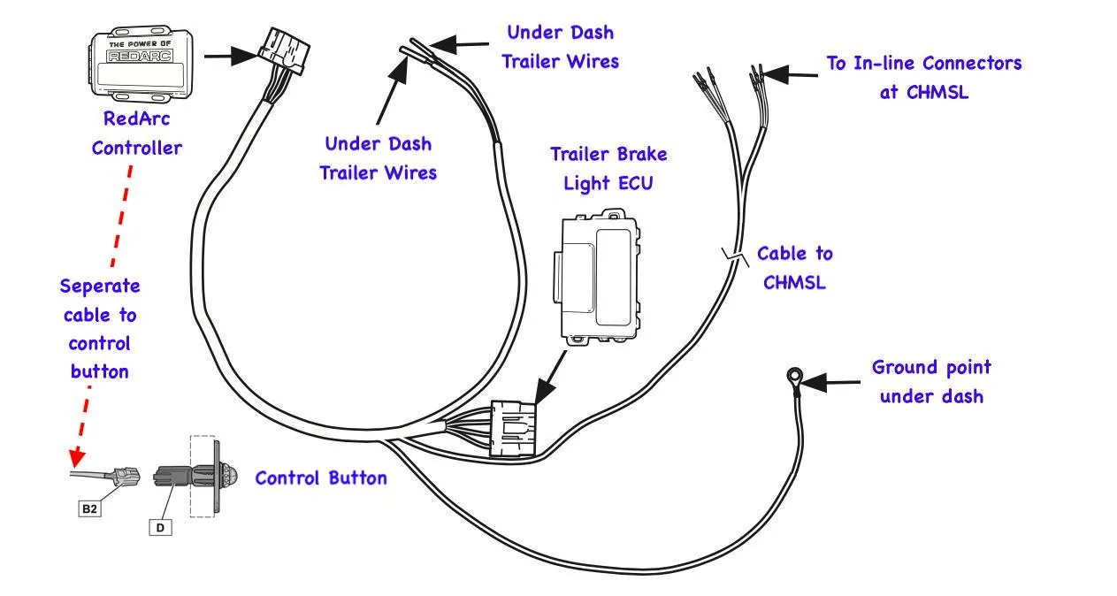

OK, yesterday I picked up my new '19 Ranger.
Today I ordered the TBC kit (from Levittown) and spent quite some time reviewing the install document posted here earlier.
(BTW, wifey is apoplectic over me "tearing up my brand new truck" to install the TBC--women, sheesh!)
Basically you install a Redarc Tow-Pro Elite and then 'add in' a Lumen 'Trailer Lamp ECU'. The latter sends six wires back to the CHMSL (Center High-Mount Stop Light) where you disconnect the three-pin connector that is feeding it and jumper in the wires from the front based on which color connectors Ford used at the factory.
'Why this lunacy?', you ask. Well, the reason is because the CHMSL is a very special kind of brake lamp. Since Ford failed to think about an integrated TBC in time, they had to work out this Rube-Goldberg solution to provide a fully integrated, factory-look install that would meet all of DOT's very complex rules when it comes to automated systems in autos (AEB & FCWS). Everything is plug-and-play with the exception of two wires that have to be spliced--but those two wires were meant to be spliced as they are terminated and hanging loose behind the trim panel.
So, once you jump through the hoops of installing the fool thing, you have a 'factory installed look' as well as what many are calling the most advanced TBC out there, the Redarc Tow-Pro Elite AND it plays well with your AEB and FCWS!
You have to admit that one little knob/button that blinks different colors and has sense enough to control your trailer for you trumps the huge "squeeze me' paddles on the older integrated systems.
I'll report back after I 'tear up my interior' and y'all will want to know if divorce happened.

The more I study it, while waiting for my kit, the less complicated it looks. I poked around the headliner back at the CHMSL and it looks like it just pops off. It also looks like, from the instructions, that you just pull it back at the center and pull the wires out with the connector to be jumpered. It looks complicated because there are two different sets of connectors to be attached depending on what color (black or gray) the trucks connectors are.
Anyway, one of these $10 kits will make the whole thing much easier than it appears. I pulled the headliner out of a '66 VW Beetle once (to Baja it) and that was a nightmare beyond belief. Automotive manufacturing has learned a lot from young engineers that played with Legos as kids!

Is there enough cable to mount the knob (B2 in the pic above) in the center console by the 4wd knob instead of on the left hand side where Ford suggests?
