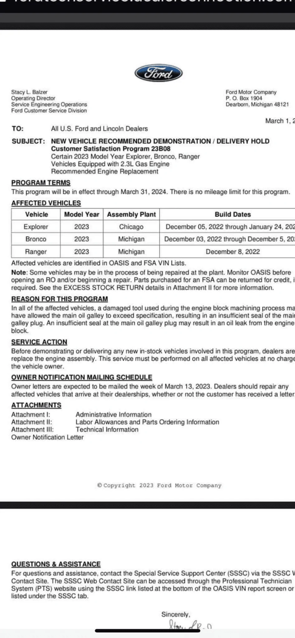

My 2020 had an oil leak at 13K miles. The dealer did the UV inspection and said it came from back of the valve cover. They attempted the fix by replacing the valve cover gasket. That didn't fix it. They pulled the cover and inspected it more carefully. Found a hairline crack in the cover itself and replaced it. I didn't see any leak for 2-3 days afterward before I sold the car to Carmax. I had enough!!! Maybe they did fix it, but I couldn't confirm it for a longer duration.

WOW! That's a major f'-up! Does it read, "Replace engine assembly"?
Truly a huge mess up. Apparently this is an issue with the new f150 raptor. I believe the same tool was used on them as well…
