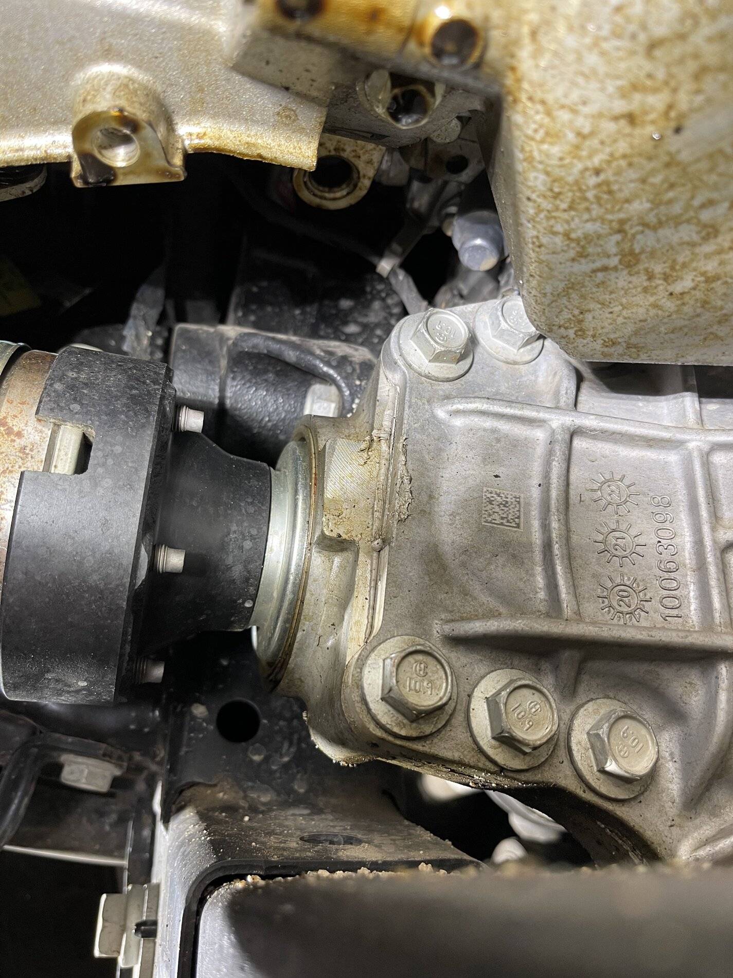

Well the Ranger just delivered a low blow. Discovered an oil leak while doing an oil filter change in preparation for a 15 hour drive for our holiday trip we have been planning for 6 months. Im having trouble finding the source of the leak. From what I can tell it definitely drivers side, rear to mid way back on the block, and coming from mid height. Hard to pinpoint as the air flow from driving has been dispersing the drops all over and I can only see far up in there. Thought maybe I would get lucky and that it was a small drip from the oil filter as it almost seems to be originating in that area, but after cleaning everything up and carefully torquing on the new filter there are new drips already in less than 200 miles since the oil change. Dealer is week and weeks out and essentially of no help. Does anyone know if there is a suspect gasket or seal I can check? Feeling totally defeated on getting this resolved in time for our trip and don't think I can ever forgive this truck if it ruins our getaway.

On further inspection there is oil everywhere, starting to come down both sides of the bell housing, on top of the transmission, blown to the back of the transmission pan. Serious leak and serious problem. Nothing like buying a new vehicle to avoid brake downs just to have your most important trips ruined. I officially now HATE this truck

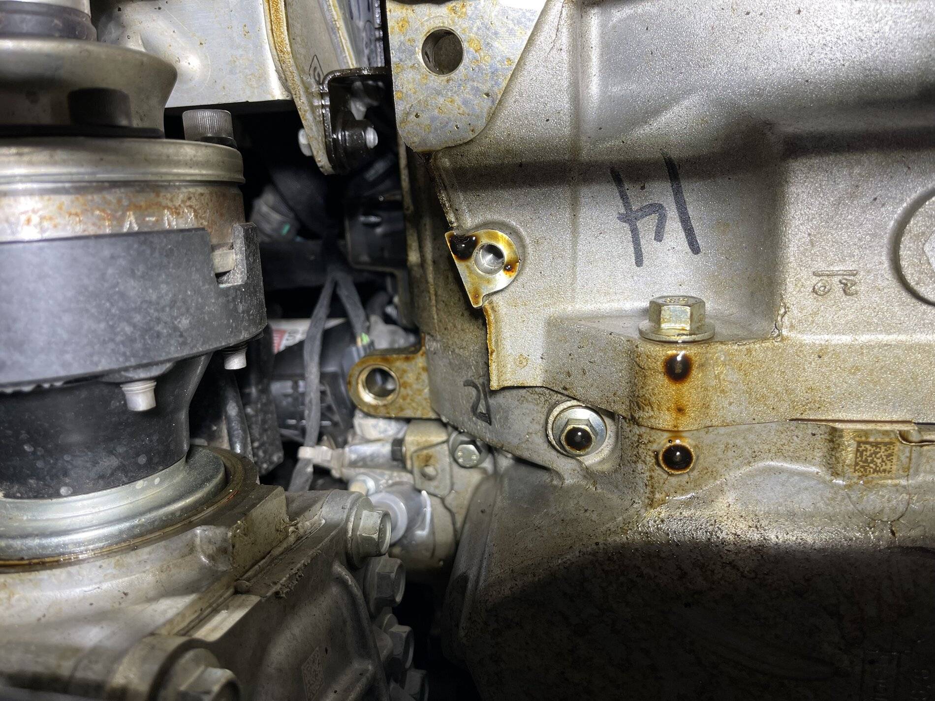

Well I pressure washed and degreased everything to see if I can better pinpoint the source. Its been wet down here with a lot of rain so the road spray mixing with the oil makes it difficult to even see where it starts. I haven't seen a drop in the oil level yet but my truck has always been an "oil maker" so I suppose the rising oil and leak could cancel out. Honestly the fluid is so dirty and watered down I cant for sure rule out transmission fluid.

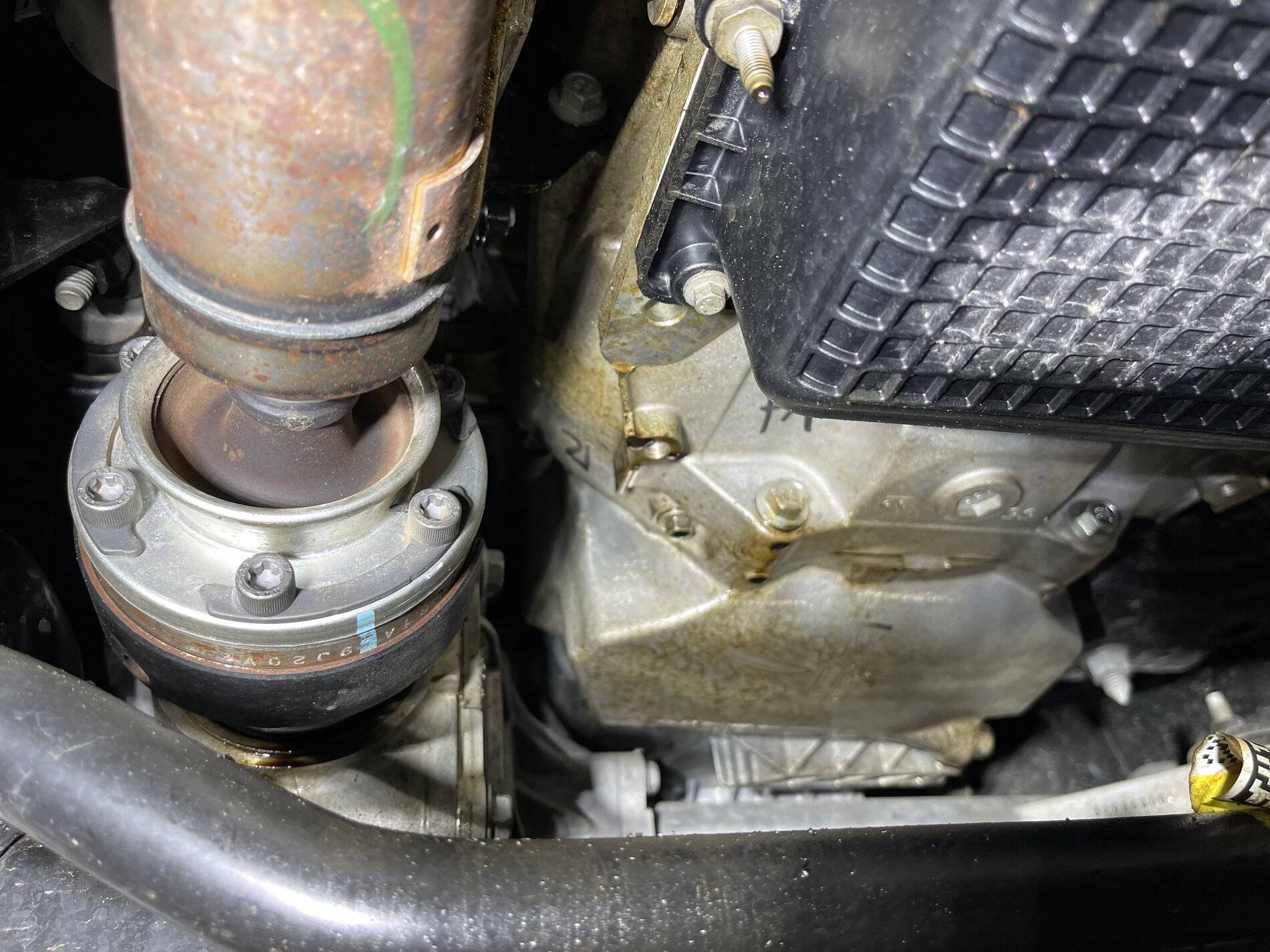

Well I had to go for the warm tranny fluid check. After running all the gears and getting it as warm as i could I was able to get a reading with only minor burns. Fluid is right at 6. I checked multiple times to make sure the dip stick was seated all the way. So it appears my fluid level is low. I have no way to know if it shipped low and has been this way for the last 12k miles or if its related to the oil leak i am chasing. Either way its very disappointing. Anyone have any ideas? Thanks

I was able to get a few new drips already on the bottom of the bell housing just from a short drive last night after I degreased and cleaned everything. With the fresh drips I can tell its engine oil and not tranny fluid.
This is the second oil change I have done. The trough for draining the filer is a great feature i made sure to scope that out before doing the first oil change, no spillage. I have cleaned out both the spout under the filter and the full length of the trough they are squeaky clean. Filter is properly torqued to specification @ 71 lb.in plus 180° , sealing surface on block cleaned, new gasket lubed etc. I would just drive it and keep an eye on the oil level but this is a signifiant enough of a leak it makes me nervous. In just the short amount of tine since I did the recent oil change and discovered the leak it has already dripped all over again.
It looks like the PCV valve is located just above and slightly forward of the filter. Im going to keep a close eye on that area and the two hoses/connection to the PCV valve as that seems to be ground zero.

I have the same leak. It is oil, not tranny, leaks as you described. I was horrified the first time I saw it, cleaned it up. Seems to leak more after towing/elevation (boost). Mine is modified. I solved/minimized the problem by venting the crankcase to the atmosphere. Used the baffled vent from CFM for the 2.0 Ecoboost and a wrist sweat band
Didn't want to take to the dealer and may not be the best advice, but at least I think we share the same problem. Take your trip
