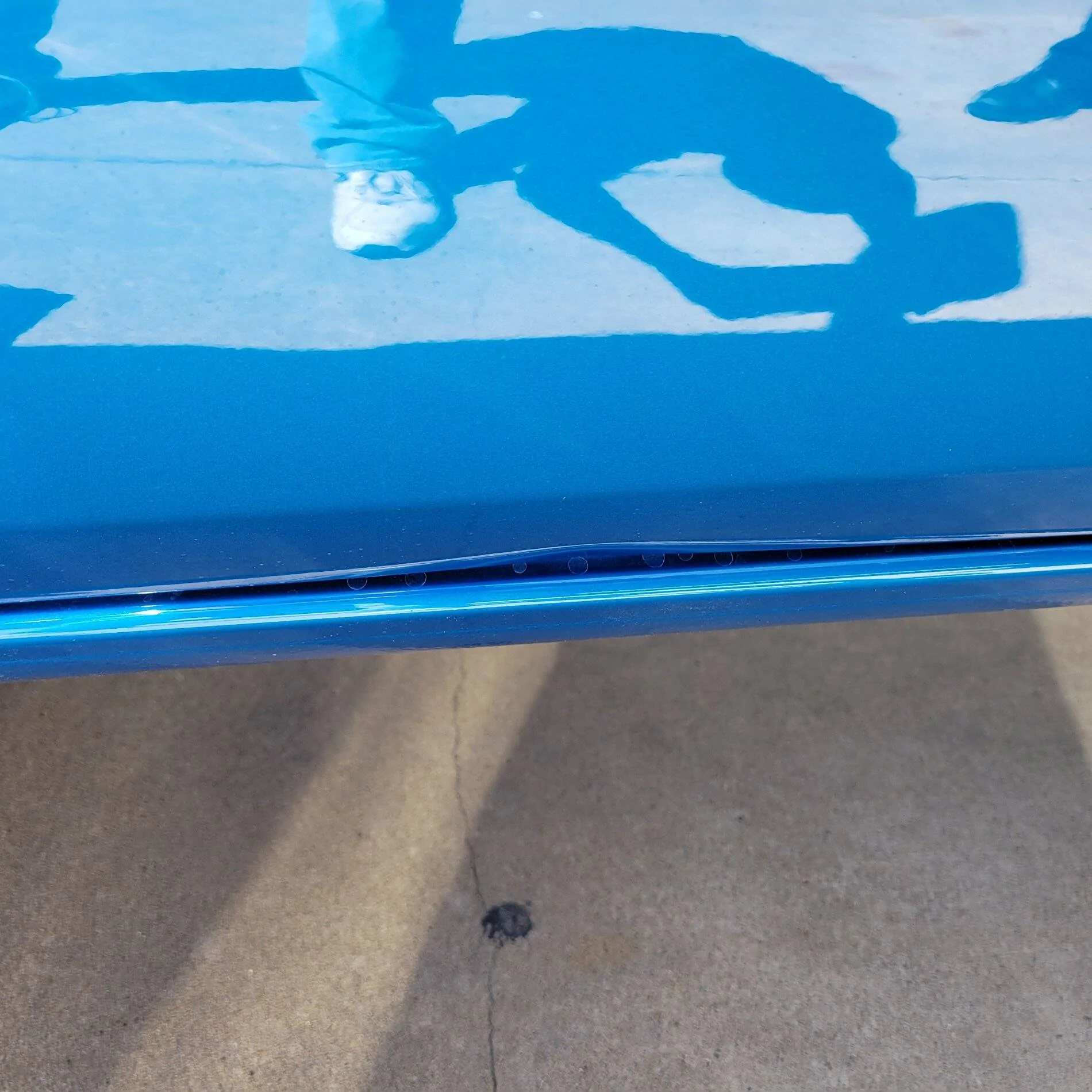

Well, I hate to rain on a parade but I didn't notice much improvement, if any. Perhaps mine was done at the factory. I also have a hard time accepting that Ford would ship vehicles to customers skipping a step of the ABS module setup, but stranger things have happened.
well ford shipping a damaged truck is a stranger thing.
I swear the auto companies are taking anyone who shows up to the front doors and giving them a job in the inspection department LMAO
yeah and at the dealer as they didn't "see" it during the pre-delivery inspection. I spotted it the first time I looked at it. Had to push for them to fix it.
