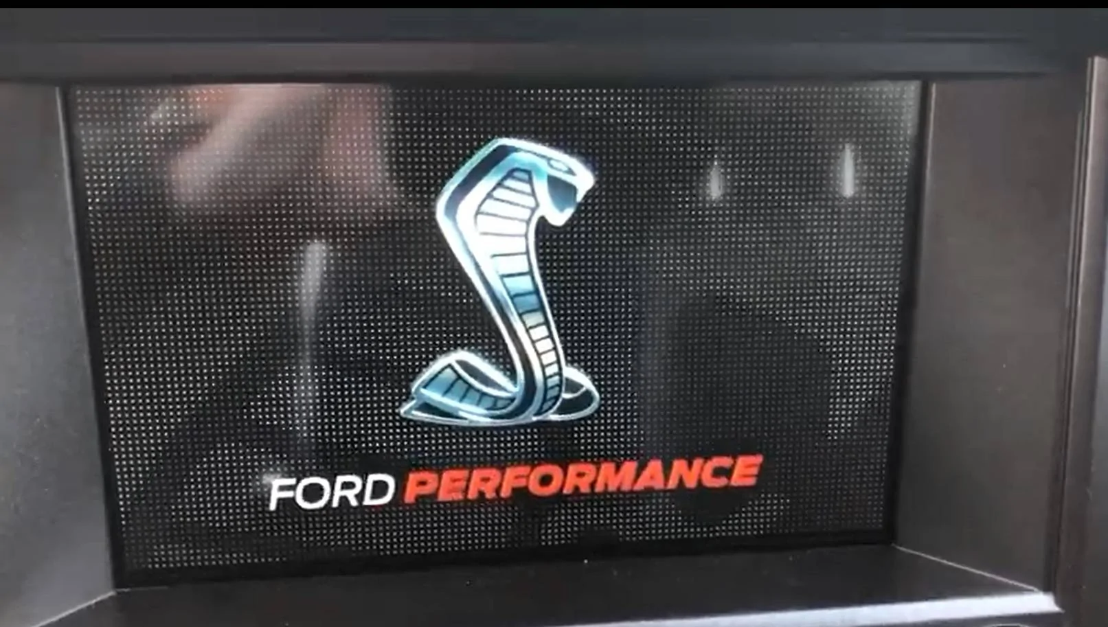

What does the Ford raptor startup look like? I did the Ford performance one. Really digging it.
THERE IS A FORD PERFORMANCE ONE? God dang. I might actually have to use Forscan… I haven’t because I have to flash to stock on FP tune before applying and I’m lazy :( I have the cable and trail management sitting here…
Regarding your question, it looked good is all I remember. Enough to put it on my list to do.

Just did this on my truck. Man it scared the shit out of me when it started!
Definitely an improvement! I also cleared the transmission tables since I was in there too since I was getting some clunks. Seemed to improve that as well, but will have to go on a longer test drive to confirm.

Looks like this
