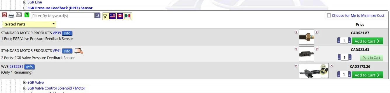

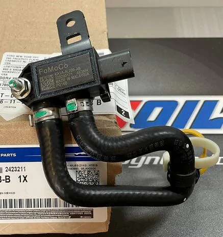

Still looking into this but the price makes me shake my head...
KA1Z5L200A from dealer is 152, but rock auto is 23$ - No hoses.
LB5Z-9J433-B is 173$ - With hoses.
What am I missing here? Is it a problem removing/reinstalling the hoses on the DPFE?
Anyway, no rush for me as the CE is no longer on & no transmission issues, I'll be changing it
in the spring when I won't freeze my fingers.
Those are expensive hoses at $150! Seriously the sensor is all you need to replace.
Buy a couple of hose clamps from amazon or where ever, and use the old hoses. There are dots on the hoses , be sure to align them to the front, and move the hoses one at a time to insure you put the correct hose on the correct barb on the sensor. The hoses are different. Pretty easy job.
The two clamps on the sensor end of the hoses are not reusable. The other two hose clamps are spring friction fit and they will come off easily with needle nose pliers. Buy 2 or 3 of the sensors and stock them away. The next time you change the sensor out will be a trivial effort and take you 10 minutes.
