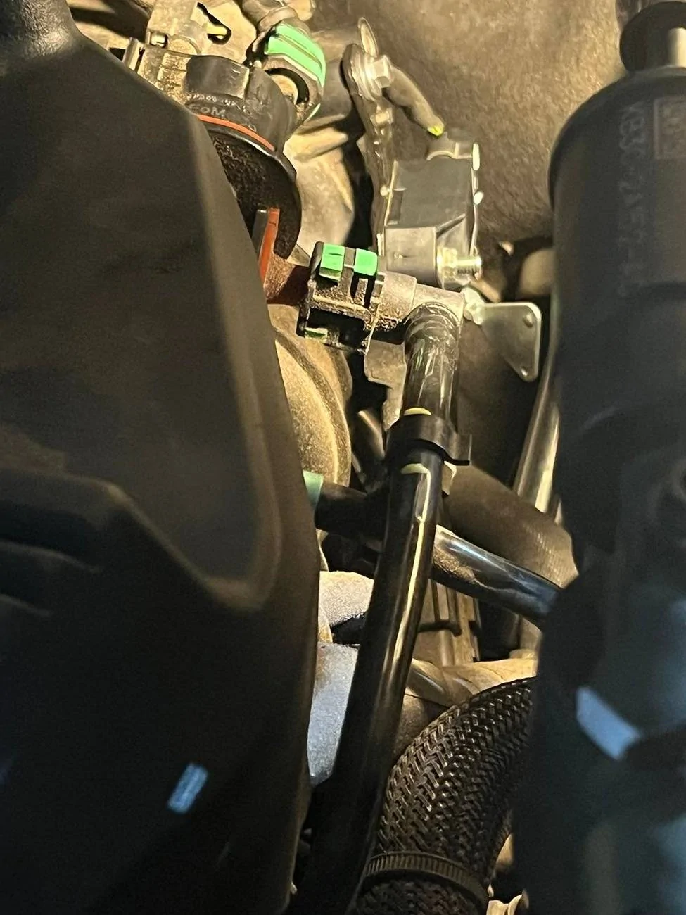

Thank You so much!! THIS was the fix I needed, it solved the Issue with low rpm jerking/stuttering. I am usually on the freeway majority of the time but i just got tired when i was in the city driving between 20 to 40 mph my truck would jerk/stutter when i would keep the accelerator steady at a certain low speed, now no matter at what low speed i keep it at it wont buck/jerk/stutter it stays smooth. my old part did have some water droplet's in it when i took off. Thank you again so much for the guide did this job in 10 minutes and that nuisance of an issue is now gone.

After clearing the moisture out of the lines and the DPFE sensor a couple weeks ago, the bucking behavior is back. I got a replacement DPFE sensor from RockAuto (under $18 plus shipping) but before I put it on, what can be done to catch the moisture before it gets into the sensor? I had thought about using a cannula on a shop vac to suck it out of the two lines, but would rather solve the problem.

I just swapped out the 17 month old sensor, same one I shook water out of two weeks ago, and got more moisture out of the sensor. I rigged my shop vac to fit over the hoses and ran it for a few seconds - no idea if I got any moisture out or not - then installed the new aftermarket part (VP-1 from Rock Auto). The issue, in my opinion, is not the sensor. It is the design of the tubing that samples the exhaust. My truck is almost five years from manufacture date and I will be trading it after the new year. Hopefully Ford will issue a TSB that will fix the problem, but I doubt it.

Just want to say thanks a ton for the info. I just replaced the sensor Ford KA1Z-5L200-A Which is the part without the hoses. I just clipped the old clamps off with some dikes and used some worm gear clamps when going back.
This not only got rid of the surging/bucking but really smoothed out general acceleration.
Of course it was only in stock @ Lakeland Ford but right now they are in stock for 16 bucks at rock auto. Get em while they last.
