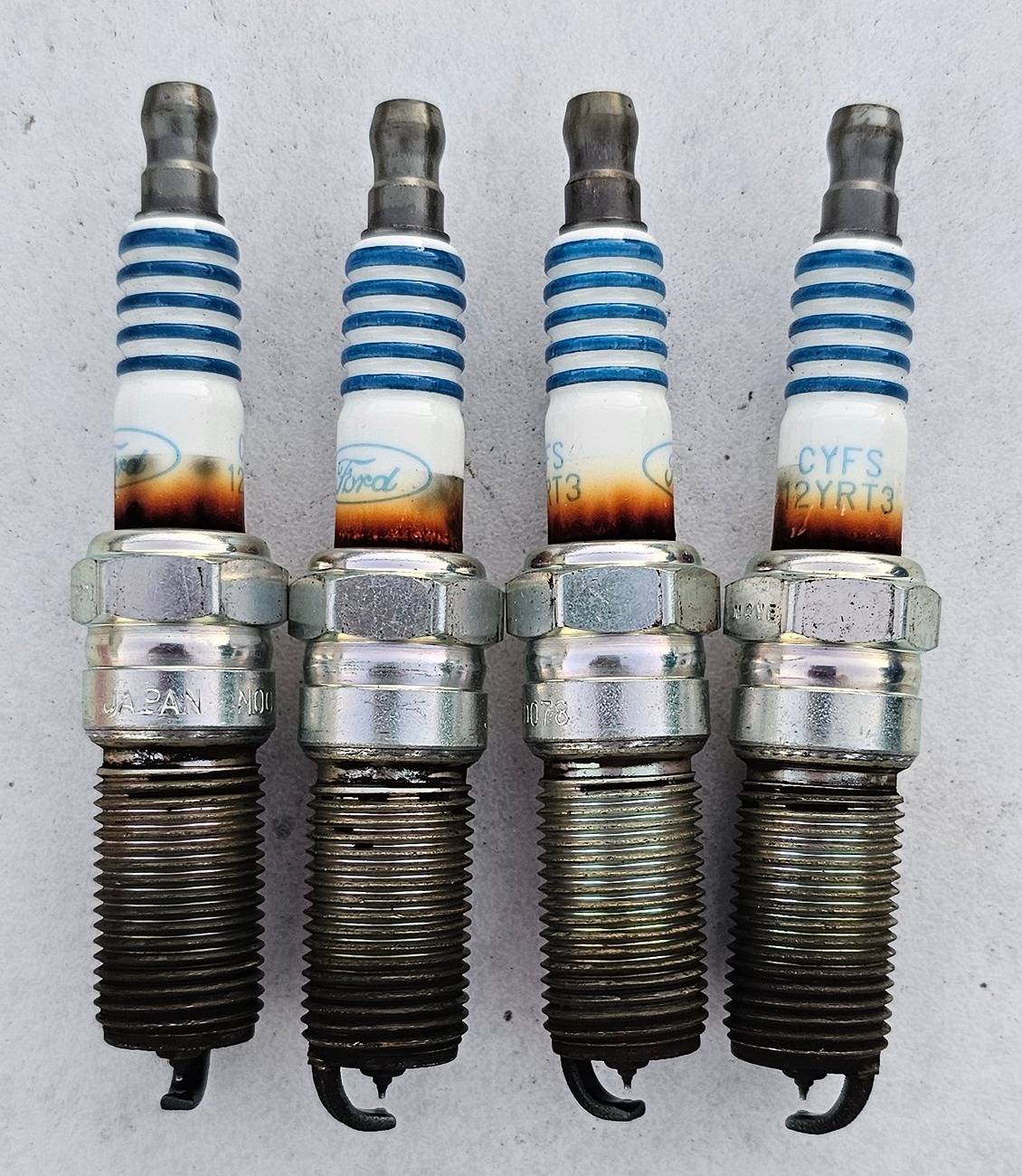

To date what I have done is Plugs, DPFE, MAPT sensor, and IAT.
I had to drop my truck off for weeks at the dealer last summer and they performed the TSB where they reset everything.
I still have a slight hesitation sometimes once or twice a day (warmer months) in the 3rd to 4th gear shift but I’m just not going to worry about it anymore. It seems to be a feature of the truck LOL.
I changed my plugs and left my battery cables off over night. This didn't not change much at all. It seems to be getting worse. No codes pulling from diagnostic. Not sure there is anything else I can try on my own.
