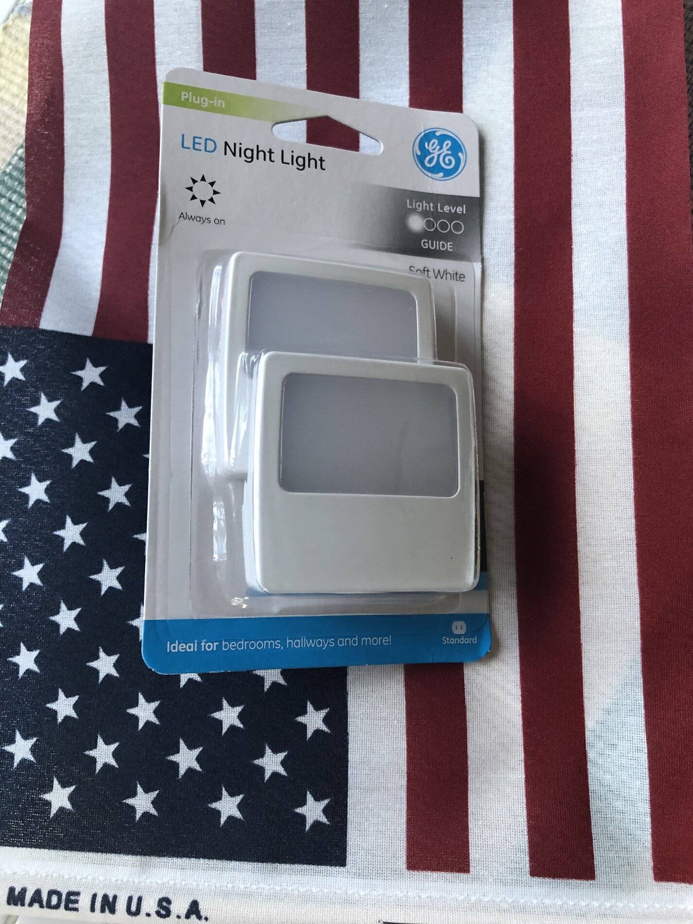

I must be one of those boring old guys who prefers a regular dome light look. I cant take credit for this one because I've seen it in another thread posted by another member.. I was skeptical, but I tried it and it works. For $3.96 it solved the problem and I’m also saving energy costs by replacing the incandescent night light in our bathroom with the spare LED. :giggle::crazy:

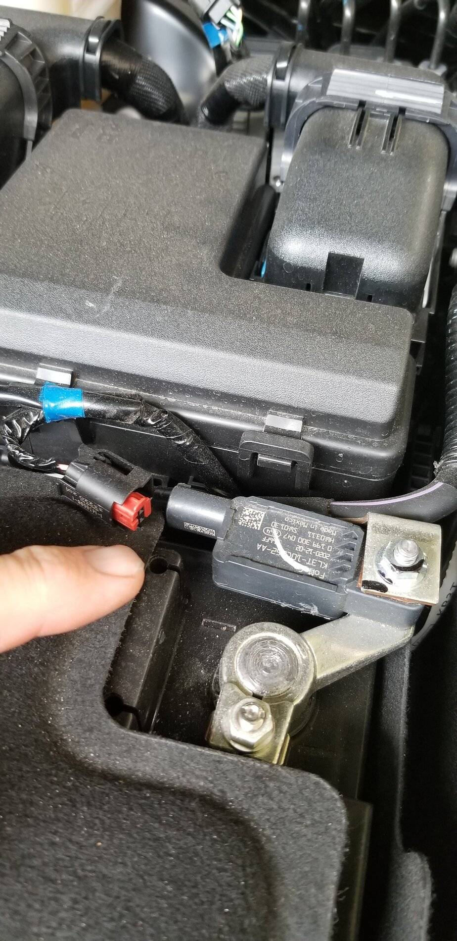

I just unplugged mine from the battery terminal.
Did this over a year ago with no issues. It just makes your charging system treat it like a regular system--always charged vs "allowing it to charge" when it drops below a certain voltage.

i tried this and it seems to work,only a few dollars,it lights up when plugged in
Man, how boring!! You didn’t choose your favorite marvel hero nightlight?! Truly a missed opportunity… :facepalm:
You had a chance to get a USA flag night light… missed opportunity :flag:

For at least 6 months I had the ASS system disconnected at the battery. Everything worked fine and battery was always at full charge and S/S was eliminated.
Got Forscan setup and went to town. Turned off S/S in software and reconnected the battery connection. The other change I made in Forscan is percentage of battery charge. Factory has it set to 75% of full charge. I changed that to 90% and haven’t had a problem since.
Got to say Forscan is the way to go! Allows you to change many other things that you really can’t so easily any other way.
