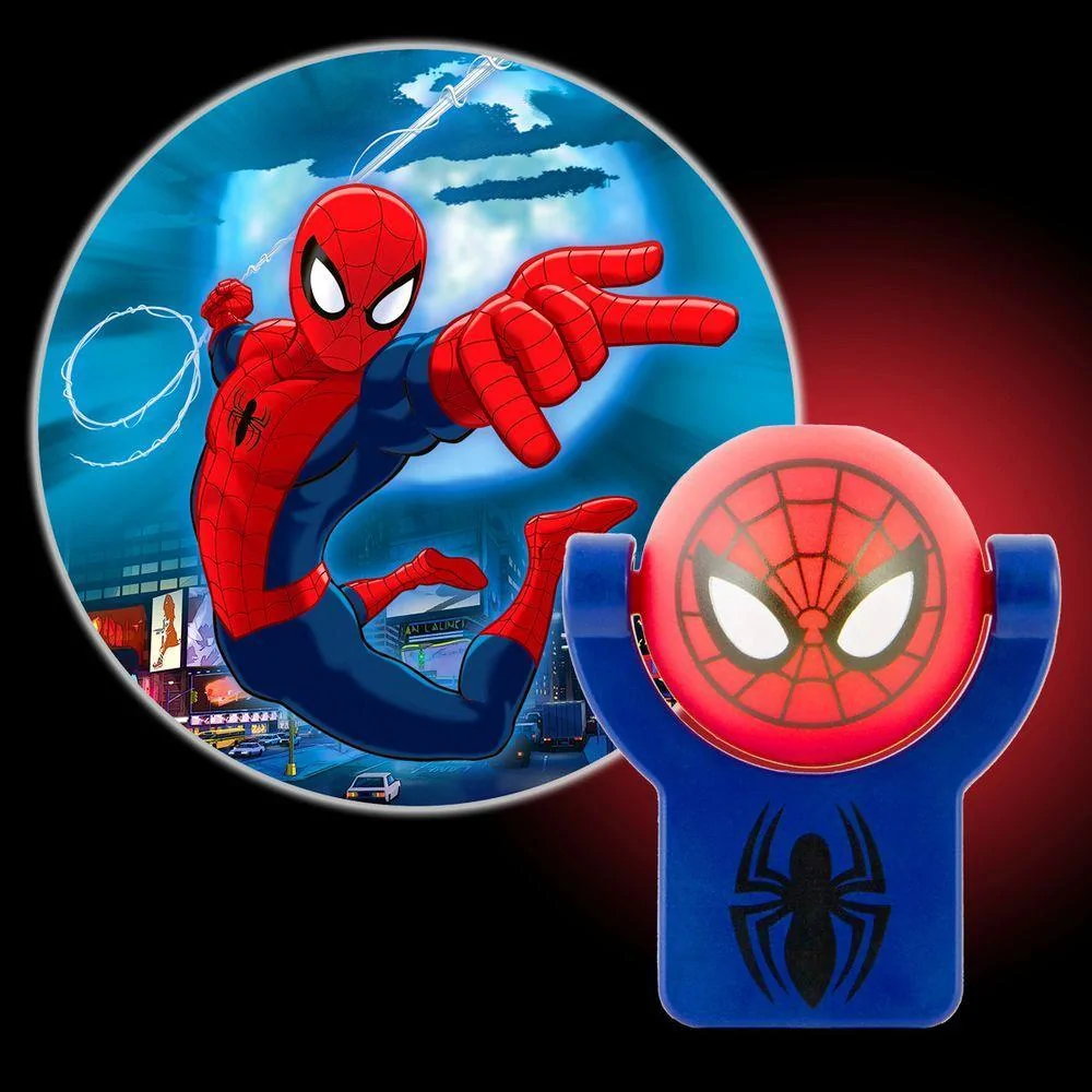

Please post more pictures of different night lights. This is entertaining :LOL: I got a good laugh at thinking someone coming into your truck and asking “hey man, why do you have a Spider-Man night light in your truck?” Quite comical but the nightlight is quite the cheap solution to the problem at hand.
