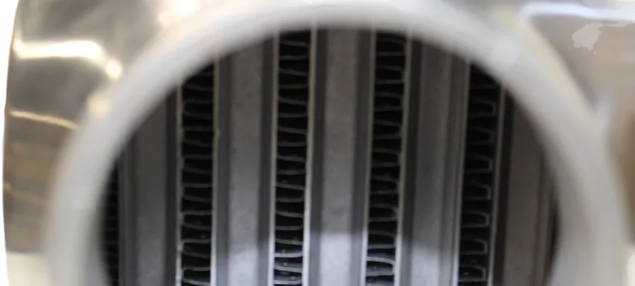

I meant the cross tubes of the intercooler which have a pretty small i.d. and fins internally. Air and fluid can pass through but debris would have a tough time passing through.

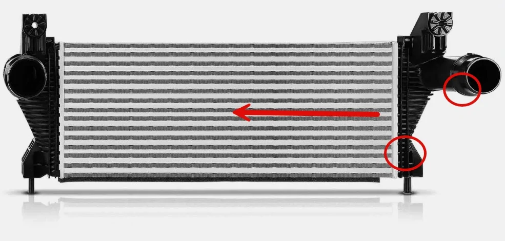

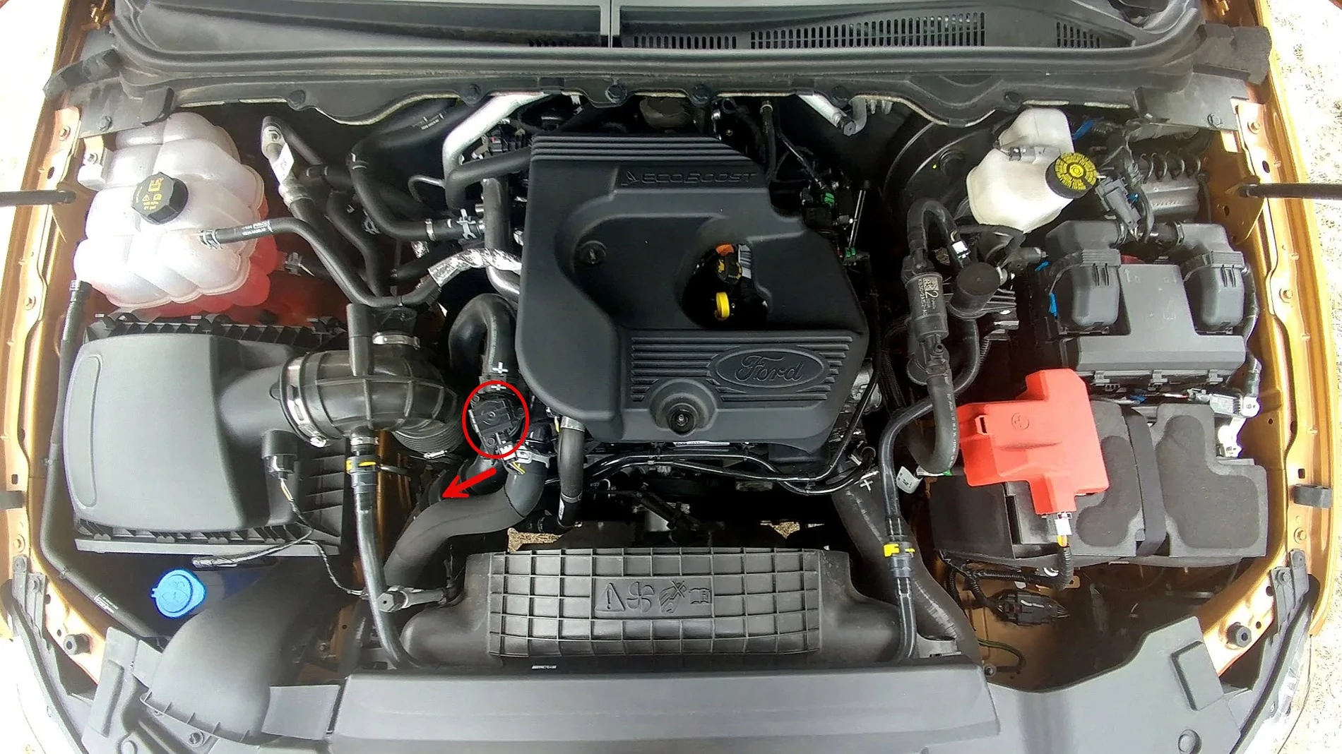

As your basic visual learner...
You were working here:
If it fell into the opening, it 99% probability that it followed the red arrow. If not, it fell out side the red circle and is in the engine bay somewhere (after driving it is on the ground or stuck in your tire which a flat tire will confirm in due time).
If it followed the arrow above, then it is in 1 of 2 places:
resting in the intercooler at the spots circled in red. (arrow is air flow direction).
Remove intercooler, invert and shake vigorously with a plastic baggy over the inlet and there's the fastener.
Good luck.
