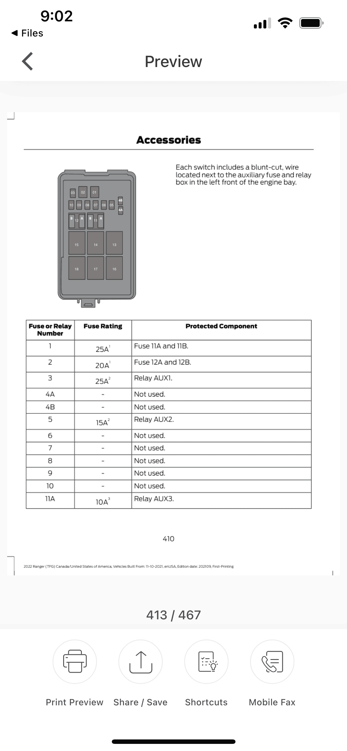

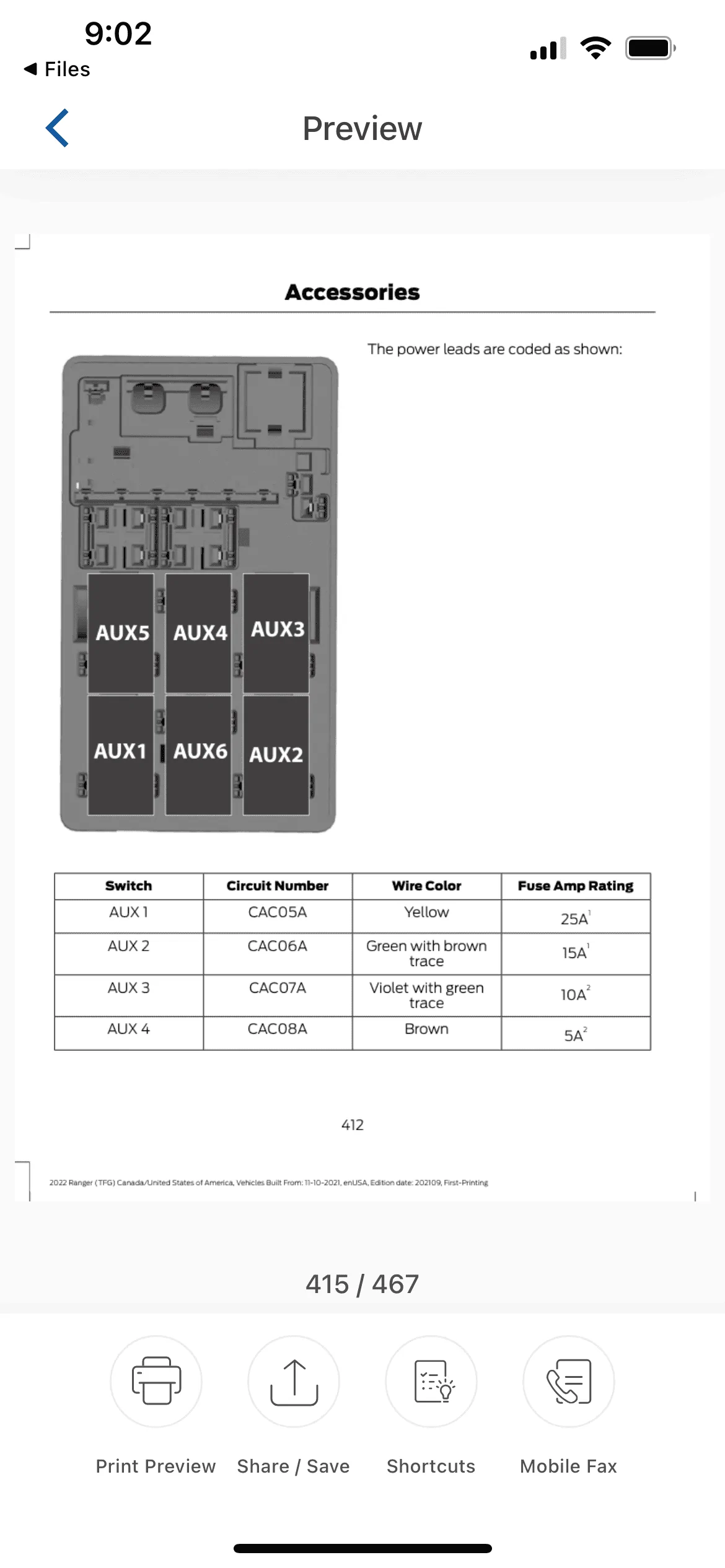

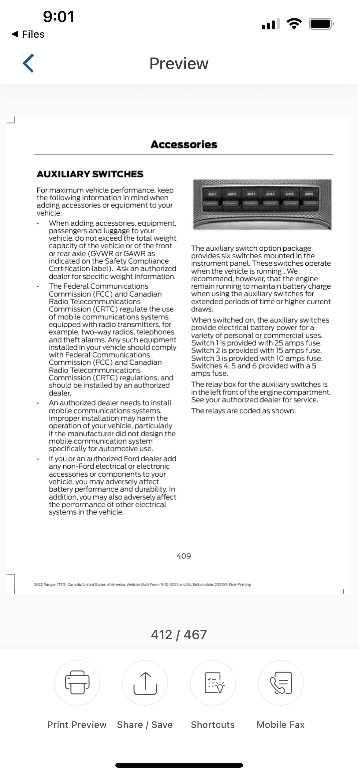

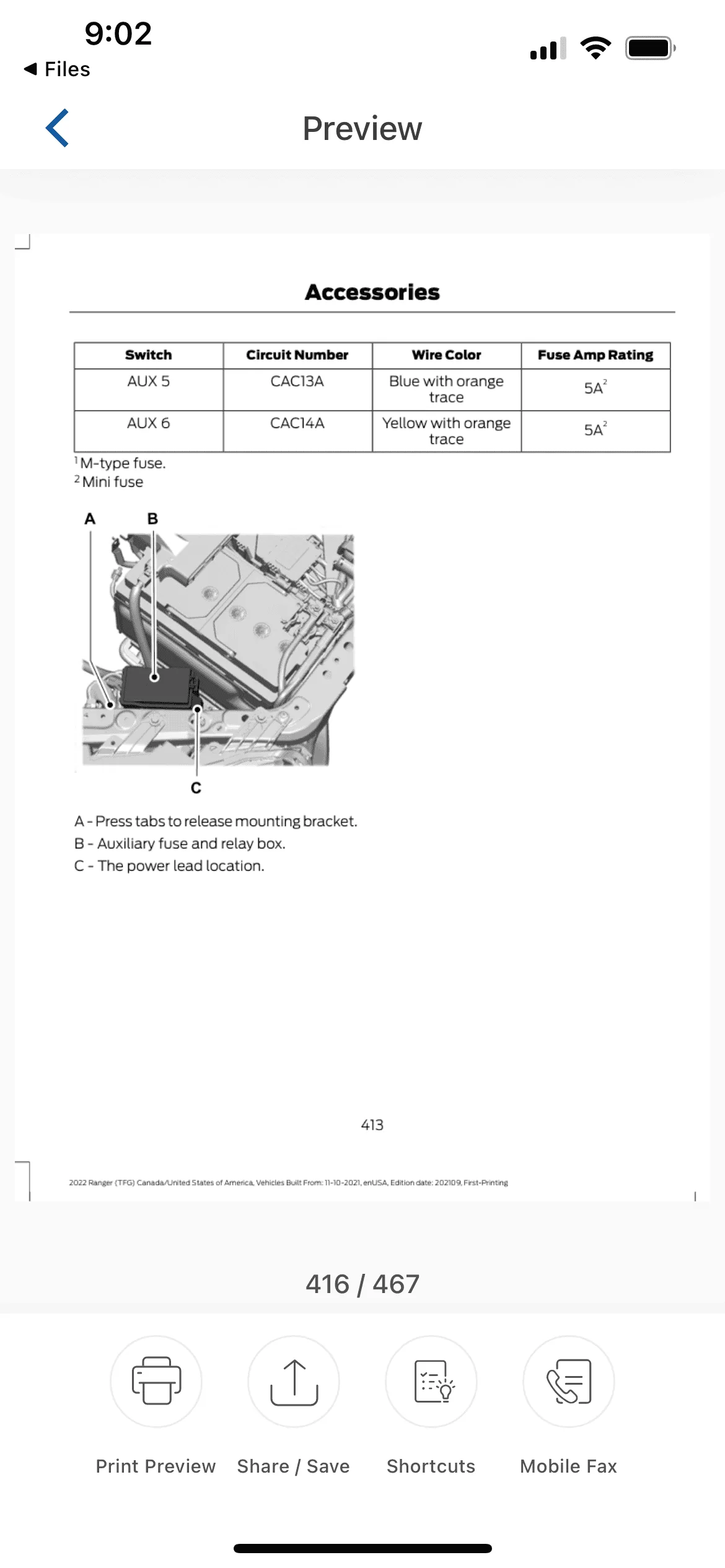

In this case it's marketing speak in the sales brochure. In the place of the small tray on the top of the dashboard there are 6 pre-wired auxiliary switches on the Tremor. So "power pack" is some marketing copywriter's way of saying there is a group of 6 powered switches haha.

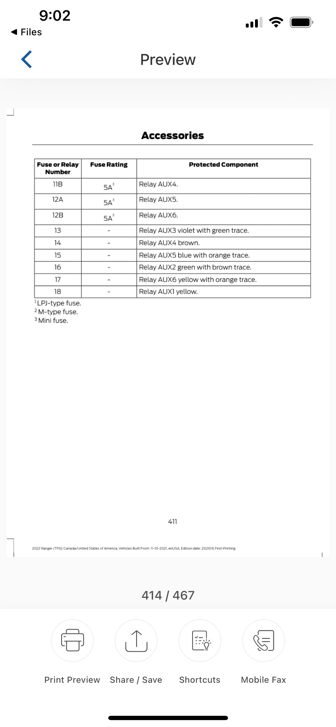

Interesting. I guess these are all 12V?

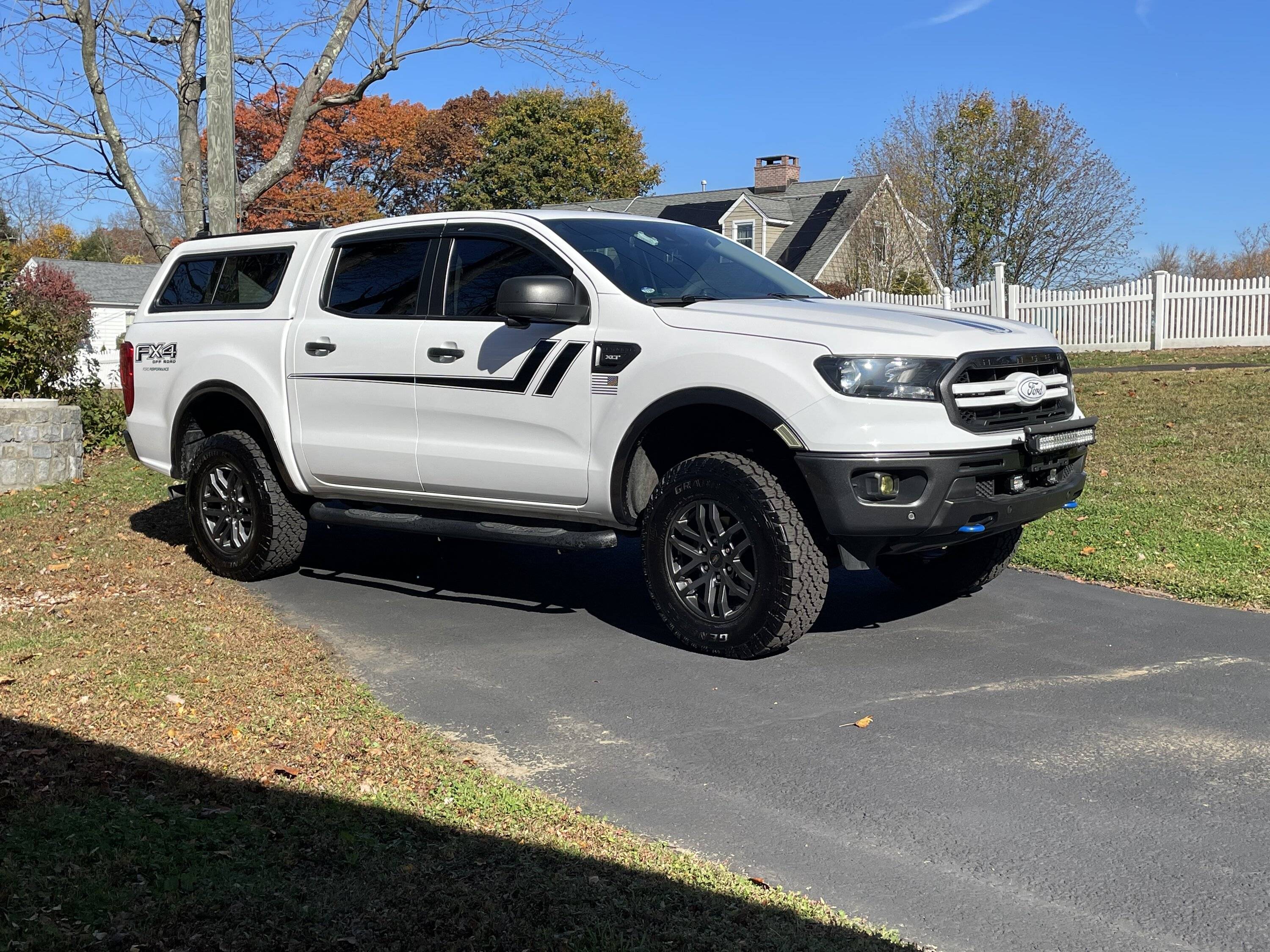

Greg, first off, beautiful truck. Functionally, it would be as good as, or arguably better than a factory Tremor off road. The big differences with the Tremor package are the upgraded Fox 2.0 suspension, rear leafs, bigger tires, wider wheels and bigger alternator. All of which are upgradeable. The rest is mostly cosmetics, many of which are upgradeable too. You did a great job on your mods and I can’t see what you’d gain at this point on the Tremor. Granted, for me, if it had been available in 2019, I would have gone with that factory package, but it was not available yet so I too have since made similar mods to ā€œTremorizeā€ my truck. I plan to wait to see if Ford offers a PHEV Tremor with the 6 g, but for now, Iā€˜m good with mine as it stands. Again, great looking rig.
Hereā€˜s mine. Made many similar mods as you. Tremor Fox suspension, leafs, tires, wheels, steps and grill. The Tremor take off wheels are offset an extra half inch or so and it made the stance a bit wider. They are +42mm offset versus the +55mm offset on the Sport wheels or Ford Performance Raptor wheels, which is a 1/2 inch wider difference. Your truck looks amazing.

Thank you, sir. It sounds like you and I are on the same page ?
