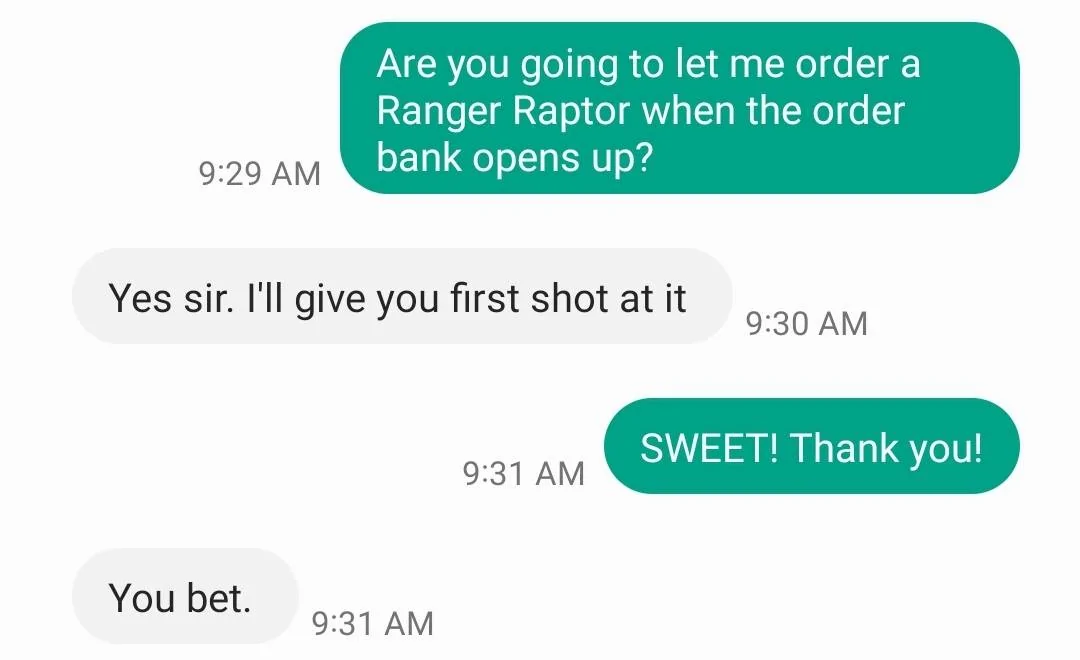

My thoughts exactly. I'm first in line for a Raptor at a large dealership
