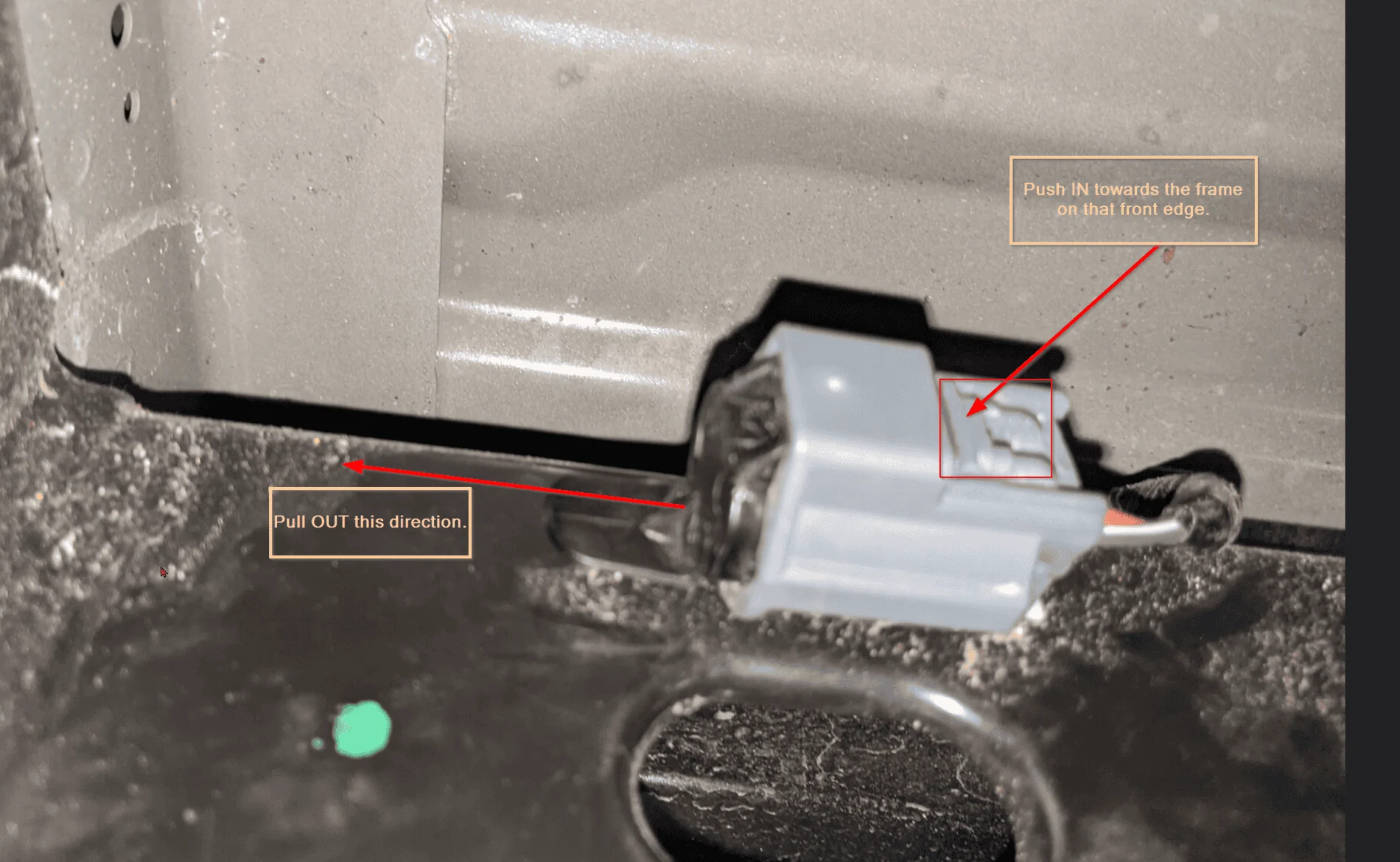

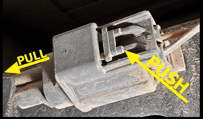

I haven't removed it yet but there is a tab you need to press with your thumb. Don't force it!

You may need to spray some water to clean off grime that can get between the housing/connector body. You can also grab the end of the dummy plug with pliers and pull straight out WHILE pressing in the tab. The first time I removed mine it had some crud making it more difficult.

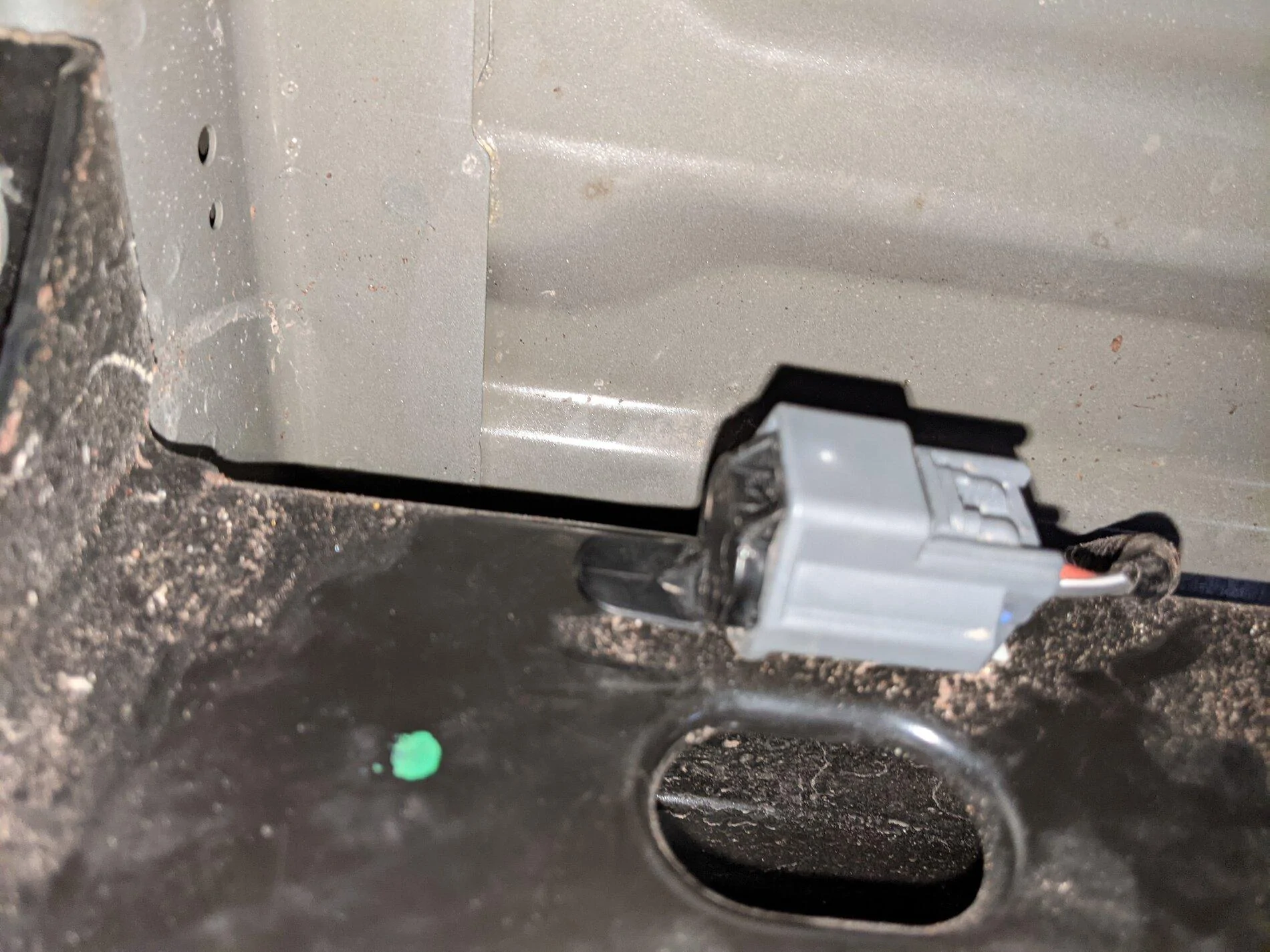

I'm having a rough time getting the dummy clip off. Exactly which way do I push, and do I use a small flat screwdriver pushing inside one of the groves, or what. I cannot seem to get mine off. Also interesting is my dummy plug looks different, but I don't think that matters (I have a 2021) other than perhaps making it harder to grip.
Also, when you get that plug out, can you post or DM me a few pics of it. Looks like ford changed something for some reason. Not that it matters, the plug/socket is still the same.

Thanks WLFPIR8 and Ranger_Rocks. I won't be able o try again for a week or so, heading out of town tomorrow morning. When I get it out, I'll send/post a bunch of pics of the dummy.
I've removed a bunch of these harnesses on various vehicles. Sometimes they are a PITA until you have released that exact one before. Reaching up under the bedside doesn't make it easier :p
