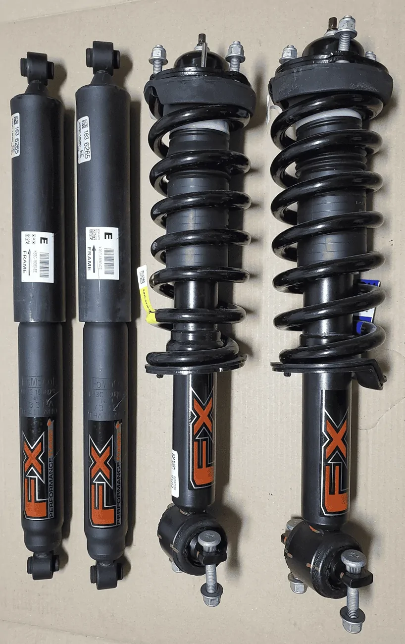

The branding on my FX4 shocks was very bold.
Silver shock body with bold black and red FX4 logo.
The looked nice, but they sucked.

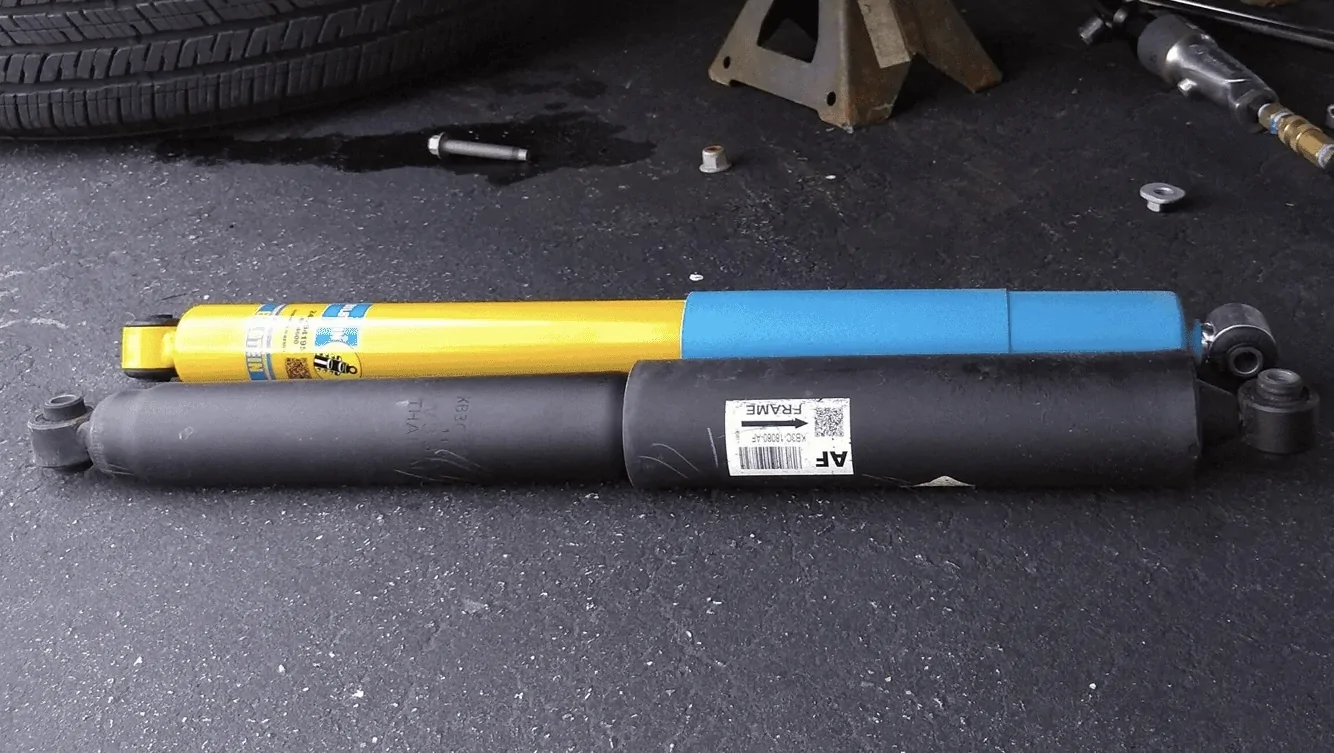

Blackout Package? Do your shocks look like the black one in the foreground of this pic?
If so, they might be standard OEM, non-FX4 shocks. Maybe the previous owner didn’t like the “bouncy” ride of the FX4 suspension and swapped them out? 🤷‍♂️

Hey there! That OEM black shock is at least double the weight of the aftermarket one.
And you said it! It's incredibly bouncy on potholed New England roads, but the Bilstein made a decent difference.
It's still Mr. Toad's Wild Ride on slow corners with holes, but I no longer lose my teeth! =D

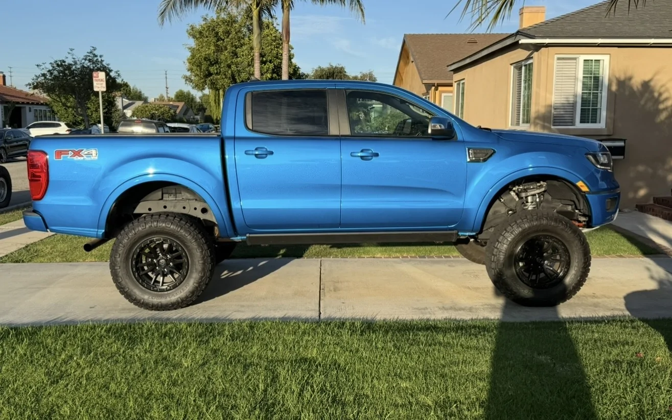

My buddy and I both have 2023 FX4 lariats. We were both surprised that our stock shocks did not have any FX4 stickers on there. Yet the rest of the FX4 package, stickers and the rest of it was all on there….. 3” & 6”……… tires coming…..lol.

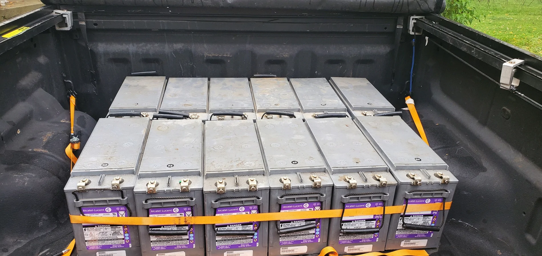

It sounds like a lot to all you parking lot suffers but we deal with a lot of batteries, some of the batteries I deal with are AGM 110lbs each, and I have had 14 of them In The Bed
this is what 1300 lbs looks like, F*** I know guys with an F150 that wouldnt try this and damn sure you aint doing this with a Chevy Colorado, I love this truck .... whats the most you have ever had in the Bed?, I have been to 3/4 ton and still got 16.5mpg doing it
