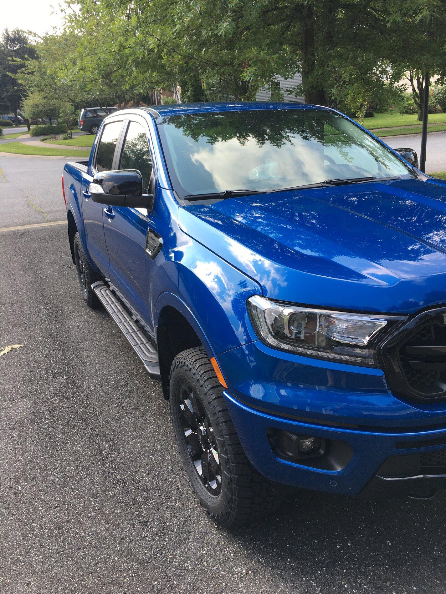

I did not like the stock FX4 suspension's ride, and my understanding is that spacers will give you lifting and/or leveling and allow you to run bigger tires but not really improve the ride (or even make it worse). The Ford Performance Two Inch Leveling Kit (essentially, Fox shocks and coil overs allegedly "tuned by Ford Performance") solved the problem for me, while keeping all warranties intact. You get a mild lift to the front that does not "mess up linkages or bearings" but gives you improved approach and clearance angles, reduced rake, a much better view from the driver's seat, and a greatly improved ride, much more stable and controlled. I decided not to run bigger tires (which eat torque) and so replaced the stock Hankook AT tires with Falken Wildpeaks in the stock size, 265/60/R18, that is, not bigger, but better. Very happy with the ride and the look now! Hope this helps!

Do you have a side profile pic? I was going to buy and sit on any components until it was time to get tires....but if it doesn’t look “wrong” with the factory sized tires, I may not wait.
