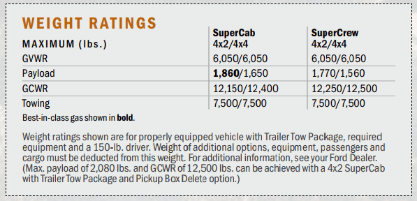

Is the difference the real world fact to haul a load you also need a butt in the seat? Like around abouts 200lbs ish?
The Ford link I shared shows passenger capacity for each configuration. So I'm guessing that's baked into their ratings.
Also 2WD models in each config. are rated higher. XFer case and front diff weight is probably why.
Edit - another thought. The FX4 models have that belly armor, tow hooks, etc. That weight is probably deducted from the payload. Mine is a 4X4 SuperCab FX4. ..I'll go check the sticker.

The clip below is from the 2020 Ford Ranger Brochure.
Does this mean that we do not subtract up to a 150 pound driver from the available payload?
I haven't seen this stated anywhere else.
I read a 150# driver is included. Other passengers, and equipment deduct from the shown ratings.
I bought my Ranger for it's towing and gas mileage. Payload still tops the Taco and Colorado. So I consider that a bonus.
