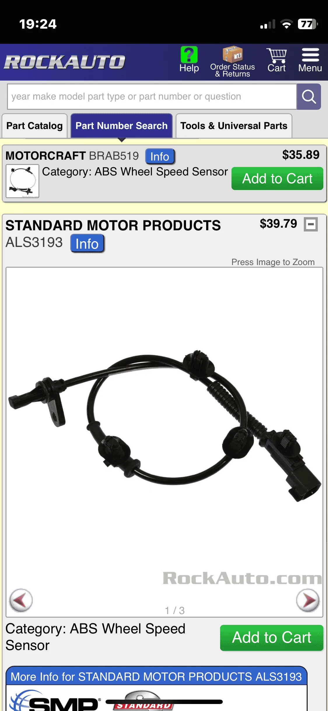

OP welcome to the club man. Mine was a bad rear wheel sensor. I’m still hunting down the part number for another ranger owner on here. Once I find it I’ll share it.
