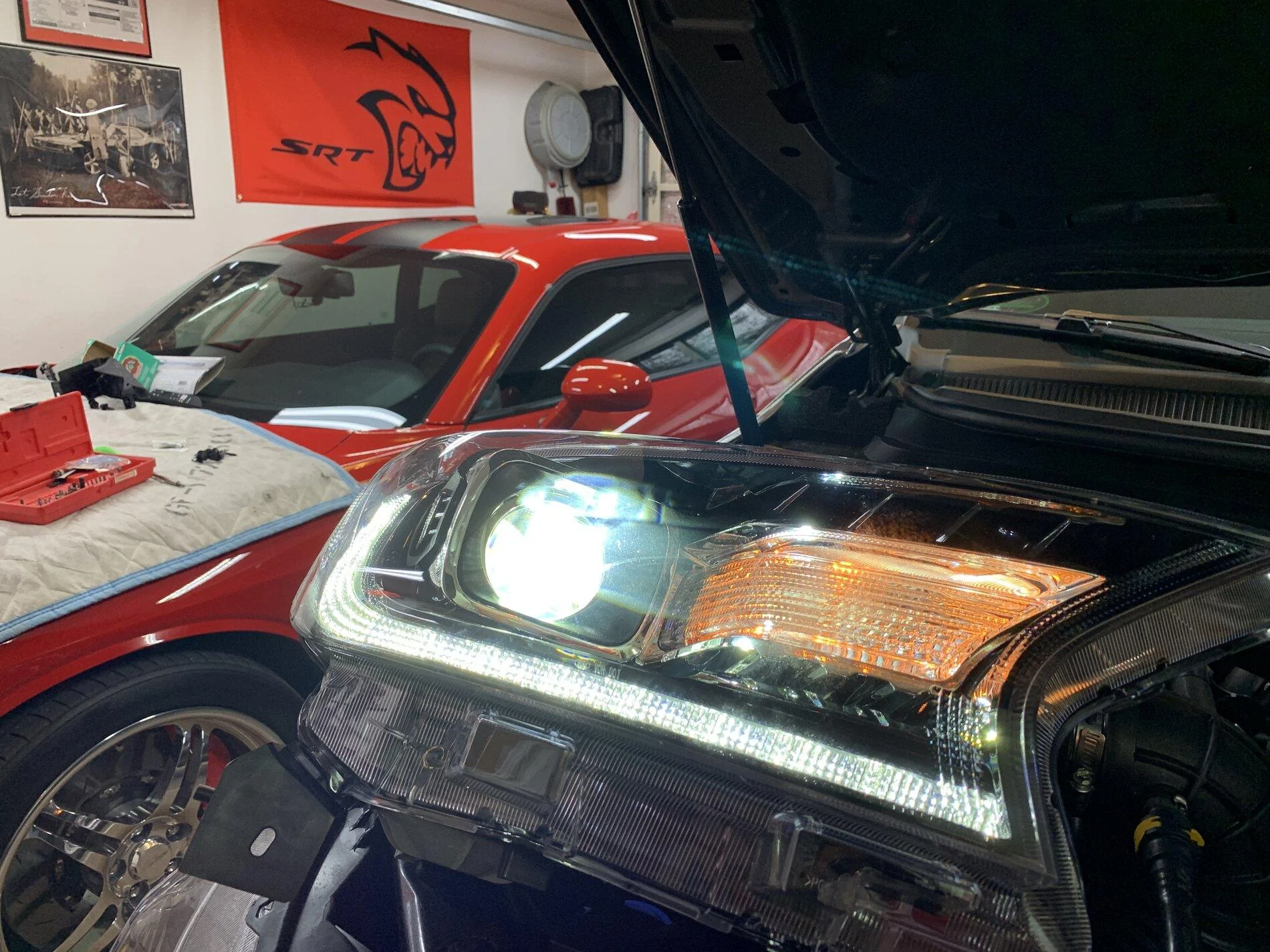

I ended up finding some on eBay for a great price. They are plug and play. The only issue I noticed is that in auto mode during the day, the low beams come on without the DRLs. I'm sure this can be tweaked in Forscan, but for now an excellent appearance upgrade to my XL.
That's because on your XL lights the low beam was your DRL. Yes you need to go into Forscan and change your DRL options to set them to the outline LEDs.
Big Blue
Lee
May 5, 2020
3,930
9,368
Retired mechanical designer
Just checked. My BdyCM configuration spreadsheet. I believe the setting you need to change are:
Allowed DRL Options to Dedicated DRL or All Options
DRL Configuration to Dedicated DRL
There are other options but I believe are the ones for the standard Lariat setup. Maybe someone will correct me if I'm wrong. I'm still running my XLT lights.

Thanks for the info. It's nice to know what to look for before digging into the programming.

Read the XLT thread - and use the latter settings.
Swapped mine and love it. Do need to re-aim, mine are too low so no hurry. But hardest part is findindg some place to do it. Need to be 25ft away from a wall and level. Or I am using a projected laser level line.
Anyway, well worth it! And watch ebay for deals, I got mine for $400 for the set. Broken tabs is common, but depending on which ones not an issue.

I used the wall behind my local grocery store late at night. A tape measure and some masking tape got the job done in about 10 minutes.
