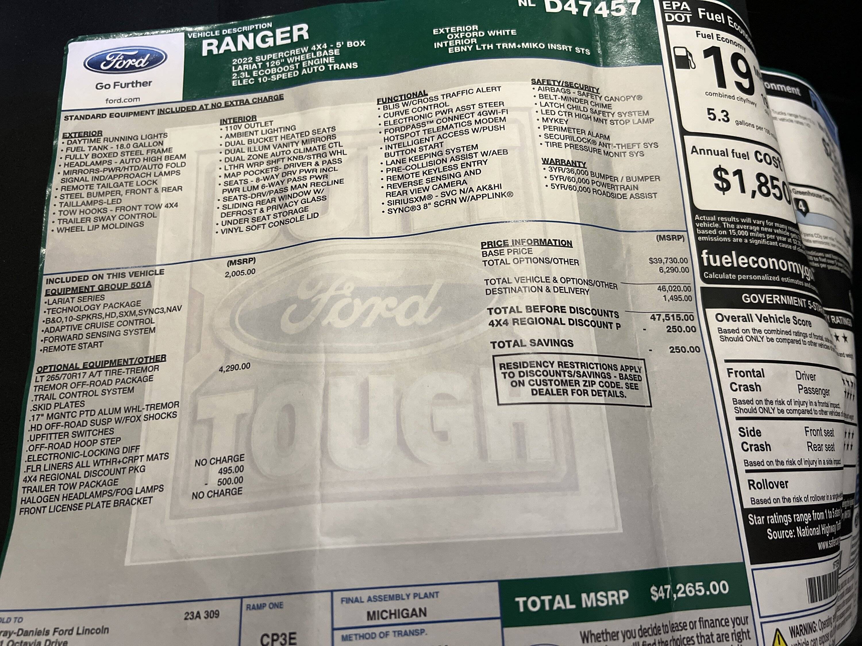

It is a lariat, but it was made with halogens.
Not sure if this helps but here’s the original sheet from the original purchaser.
OK, just wanted to be sure what we were dealing with. In the case of aftermarket lights I would say your flicker is a problem with the lights, not with the setup. Yours appears to be one small segment of the LED bar and only one side. If it was a setup issue it would be the whole bar and both sides. Unfortunately I don't think your dealer is going to do much for you unless you can talk him into getting you a new set of aftermarket lights.
