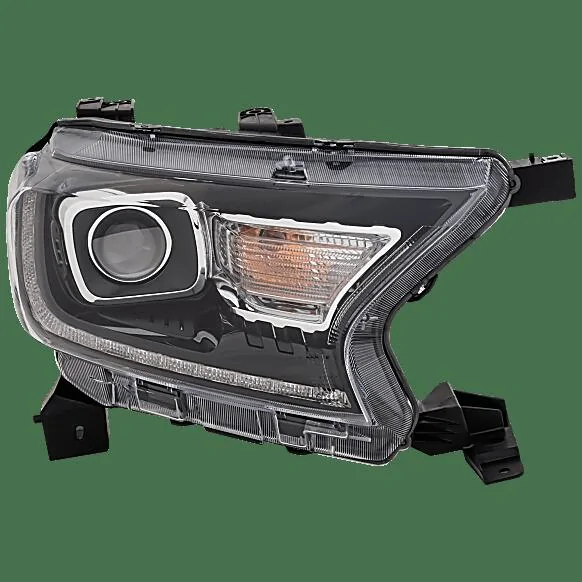

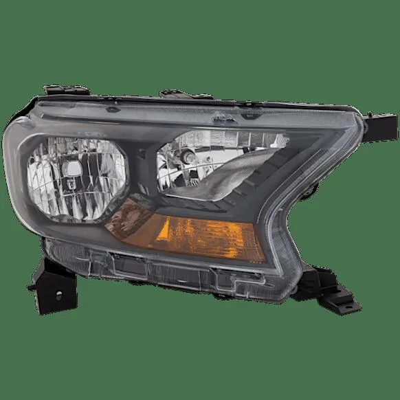

I am wondering how to remove the headlight bulbs out of 2020 ford ranger lariat? I have assemblies like the first picture, not the usual halogens I'm used to seeing like the second picture. Are they HID or factory LED or just a fancy halogen? Any help is appreciated!

The only replaceable bulb in the Lariat housings is the Turn Signal, if you are having issues post what the issue is to determine if it is the assembly or wiring or BCM control issue.
OEM replacement new is $1100-$1700 each depending on where you get them

Are you sure the second one is a factory headlight? My 2021 Lariat's lights are like the first picture.

The first picture is the factory LED headlight, used in the Lariat models, as was said the headlight has no removable/replaceable bulbs except the turn indicator bulb.
The second picture is the factory halogen headlight, it does have removable/replaceable bulbs for high and low beams as well as turn signals.
As @airline tech said if you are having troubles with the headlights it maybe wiring or troubles with the BCM. What are your lights doing or not doing. Have you scanned for any codes.
Hope for you that it is something simple. The factory assemblies are rather expensive to replace.
