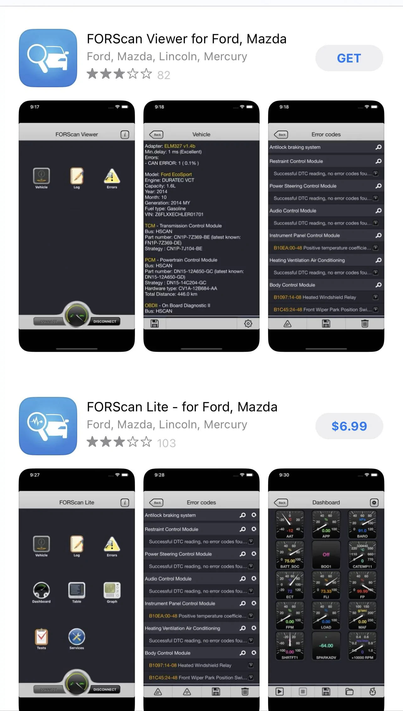

Does forscan lite for iOS do what I need it to do?
airline tech
Aug 24, 2022
4,505
8,599
Midwest - KS
Aircraft Tech
You need to be able to get into the Configuration and Programming to see the AS-Built Files and I don't think the lite version can do it.

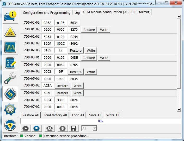

I did a quick search and could not find exact screenshots but here are examples of what you need to be able to view.
Example Shot only, the BCM is in Module 726, and you need that little blue microchip icon on the left side of the pic

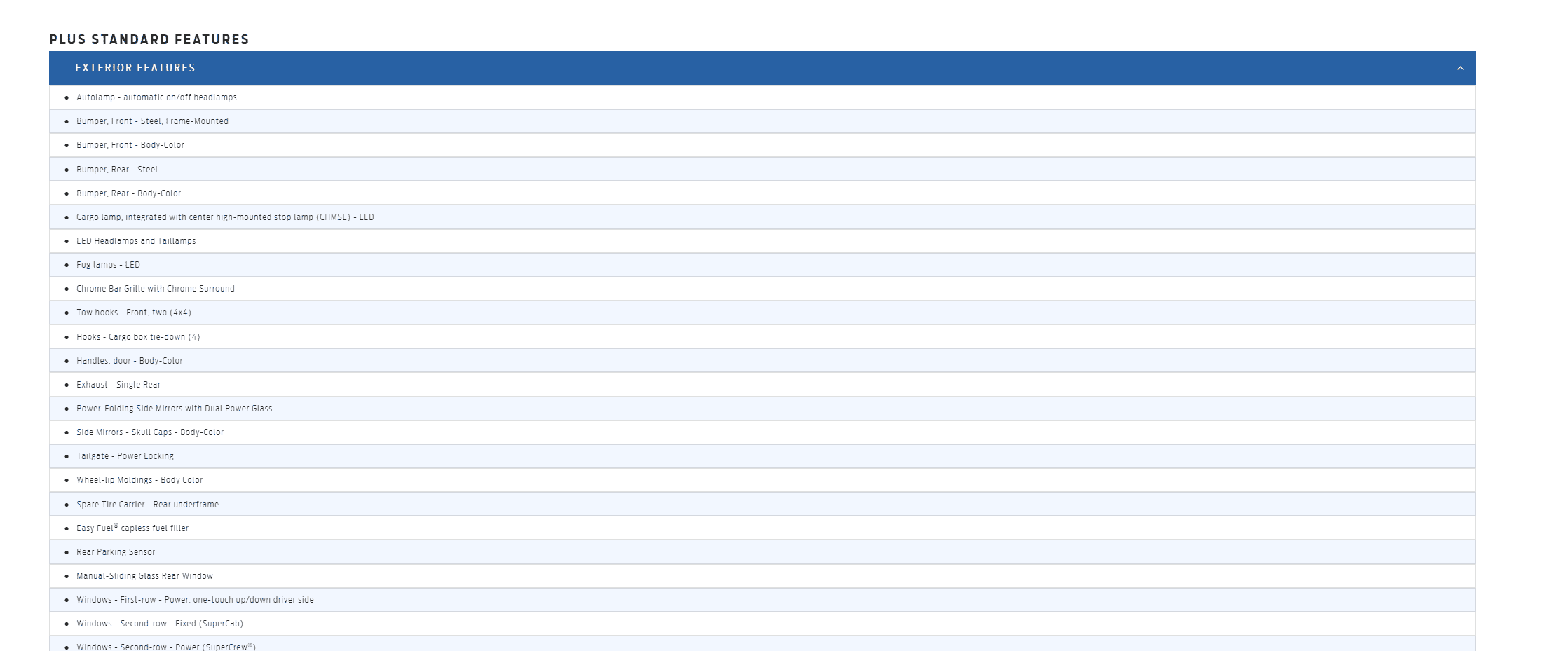

Could you inquire at another dealer? Or ask corporate what they think of your situation? Because here on the ford website...
dondonbabyraptor
Brandon
Jan 27, 2021
2,194
6,249
San Diego
2020 Ford Ranger Lariat
I/O Psych MSc student
All they offered to do was replace with an oem halogen since that’s what it shipped with.
here is another example of lariat, there is no build you can do with halogen. this is standard when you build a lariat ranger.
