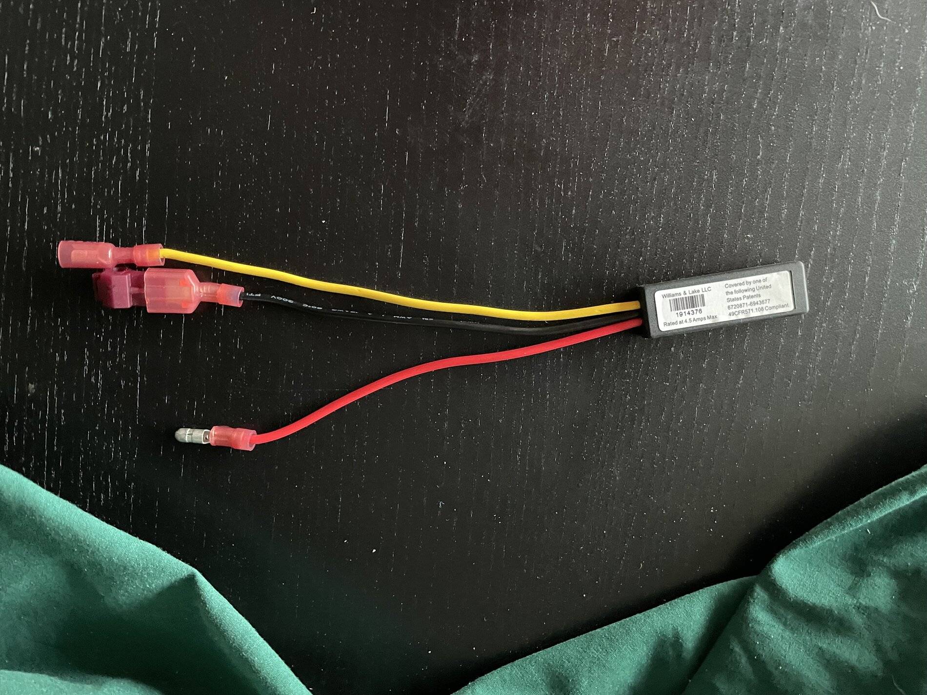

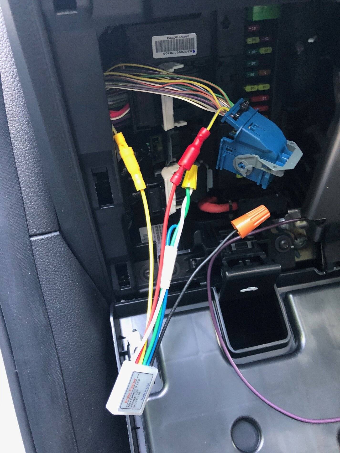

Someone asked offline about the other wires so this is to clarify. The module has 6 wires, 3 for power, and 3 to adjust the speed of the strobe.
Red - connects to the 'hot' wire from the brake peddle
Yellow- connects to the wire going to the light/LED to supply the 'strobe'
Black is ground
White, green, and blue are used to control the speed of the strobe. Slow, no wires connected. Medium, connect the white and green (that's how I have it wired). Fast, connect the white and blue. In my pic I just have the blue wire taped back out of the way using white tape.
Also in my pic, the black wire isn't connected, but it connects to that purple wire in the pic which is tied to a ground tap out of frame. Just below the BCM there is a metal bar with a few screws for ground taps.

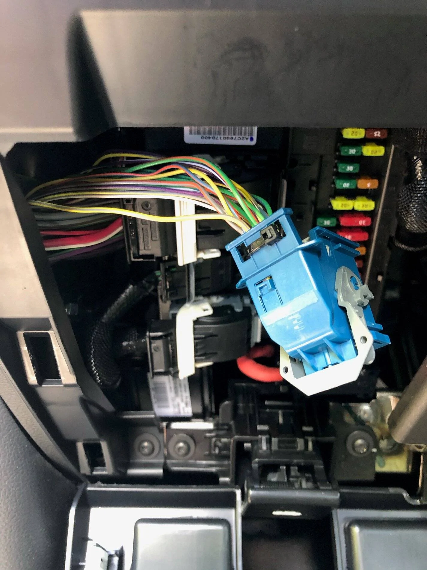

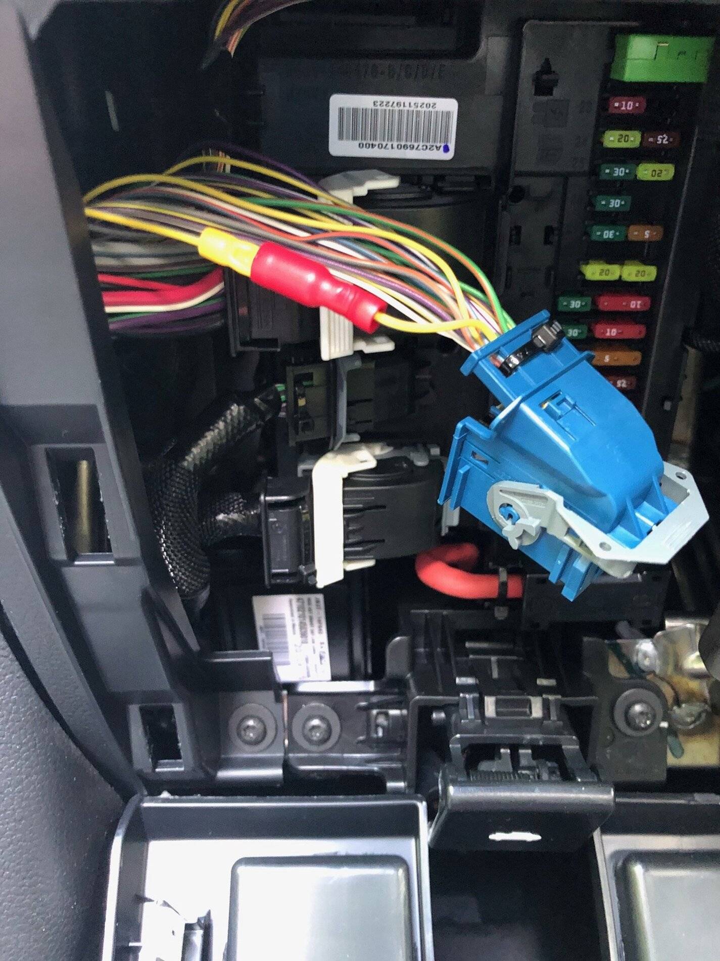

I have a thread to collect information, but since I can't edit the topic name I will make a new thread in DIY. Original thread https://www.ranger5g.com/forum/threads/3rd-brake-light-wire-location-in-bcm-under-dash.13217/
I have LED lights so couldn't just add a strobing LED bulb. I used this module, and there are others available. http://www.3rdbrakeflasher.com/brak...1.html?zenid=3375bb80e2a9a1dd9c8d510dba623ed1
It took all of about 10 minutes to install, once I figured out the wiring. See the original thread for info. The 3rd brake light uses the yellow/gray wire in the top left connector on the BCM. There appears to be 2 yellow/gray wires, or maybe I can't see the other color correctly, but the wire you need goes to pin 13, so run it back to be sure.
I used bullet connects so if the module dies I can put it back to stock easily. There are 3 different flash speeds you select by connecting certain wires on the module. I used the medium speed. It flashes 4 times in 1 second and then stays on constantly.
I'll try to get a video, but you get the idea.

Just want to make sure I understood what you did.
  1. You cut the original yellow/gray wire on pin 13 and then added your controller in the middle (using the controller's red and yellow wires)
  2. To put back to stock, you just connect the red and yellow "plug and socket"?

Correct. The black wire also connects to ground and you control the speed of this particular module using the other 3 wires in the configuration you want to select the speed of the flash.
BCM is body control module, and that's what that blue connector is plugged into.
