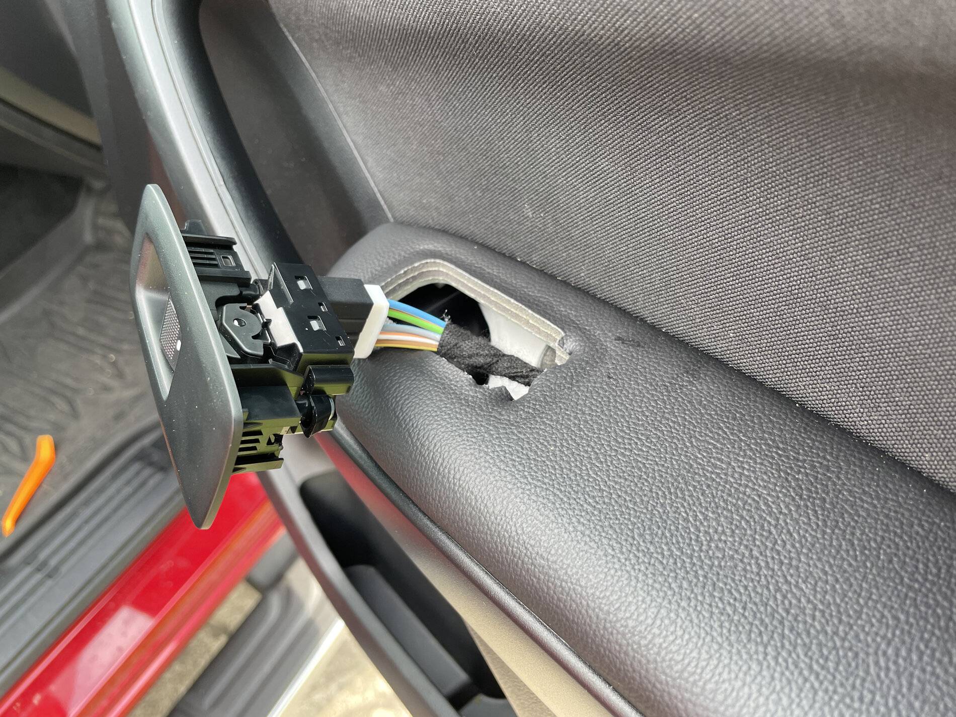

I installed my module yesterday in my 22 tremor, it works great but even with you (Jedadiah) explaining how to take the switch out without breaking the clip, I broke the clip, so I'm wondering, the part number you gave is the one I also need
I have a Supercab, so that was the piece for my passenger door. I can't say for sure if the Supercrew has the same part. I was able to find the number on a Ford part's site and then asked Benny LevittownFordParts.com to double check that I was right. He was very helpful.

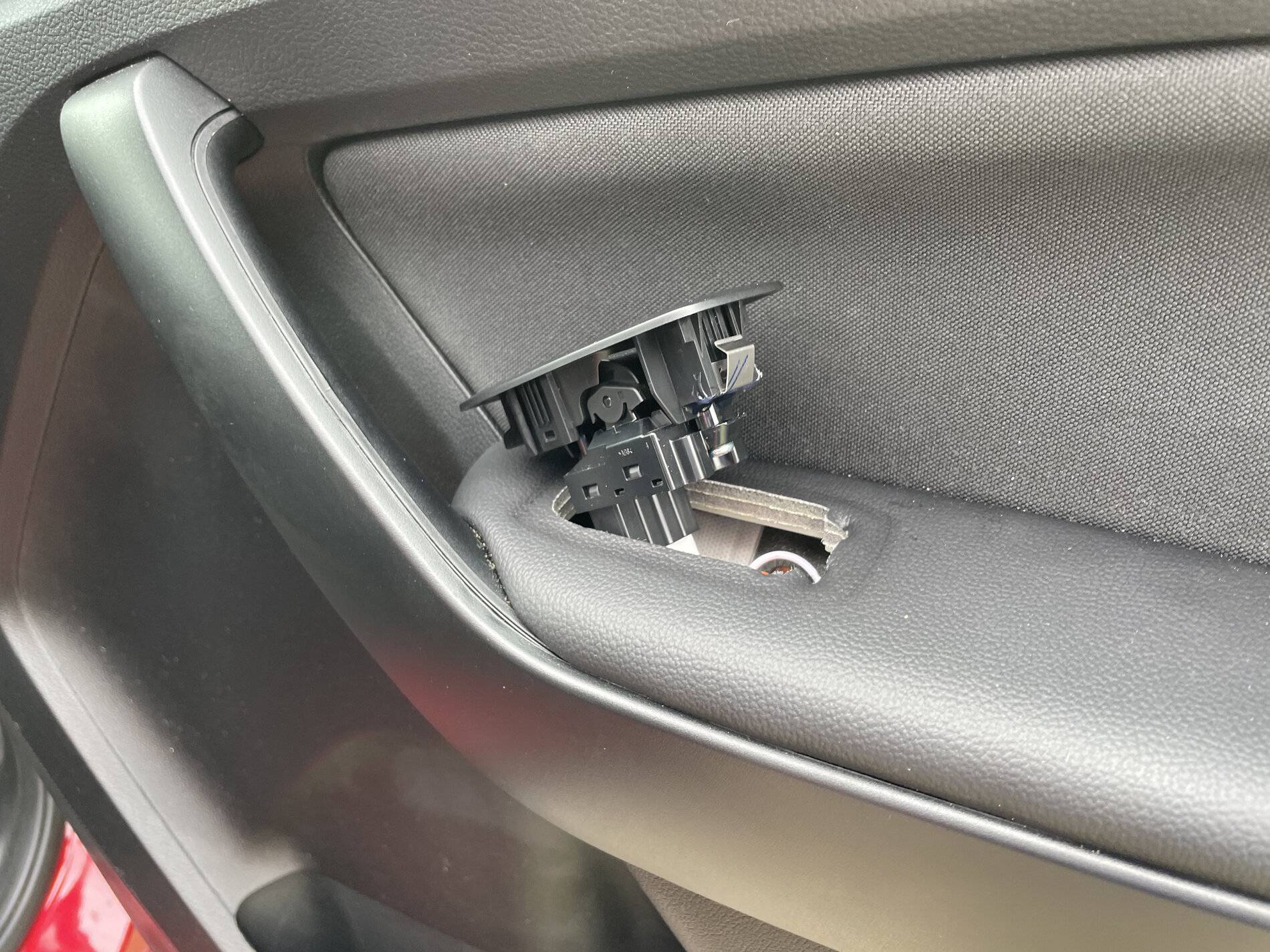

FWIW, I purchased the 3 pack of modules to do all the doors in my screw cab. I started with the left rear. The switch came out without breaking the plastic clip mount but the clip came off and fell into the door. Luckily it landed on a flat surface where I could see it and was easily fished out with a magnet. The right rear door was the same but the clip fell down out of site. Went fishing with the magnet but where ever it landed I didn't get close enough with the magnet to recover it. The front passenger switch the plastic the clip attaches to broke but the clip staid on. I put the clip on the right rear switch and moved it to the passenger door and put the switch from the passenger door in the right rear.
I went on Quirk Parts to check on getting a switch housing but they only listed a complete switch assembly for $35. Since the switch without a clip is staying secure in the arm rest I have not bothered ordering a new switch assembly.

No problemo, Benny gave me the part # for that, AB3Z-9922023-A.
I placed an order, and of course they are on backorder hah. I was armed with knowledge of the clip shape, a right angle pry tool, etc. and still snapped it. Figured the headache of removing the entire door card was not worth the $5 ($20 with clip & shipping), but now my switch is a little proud. oh well.
