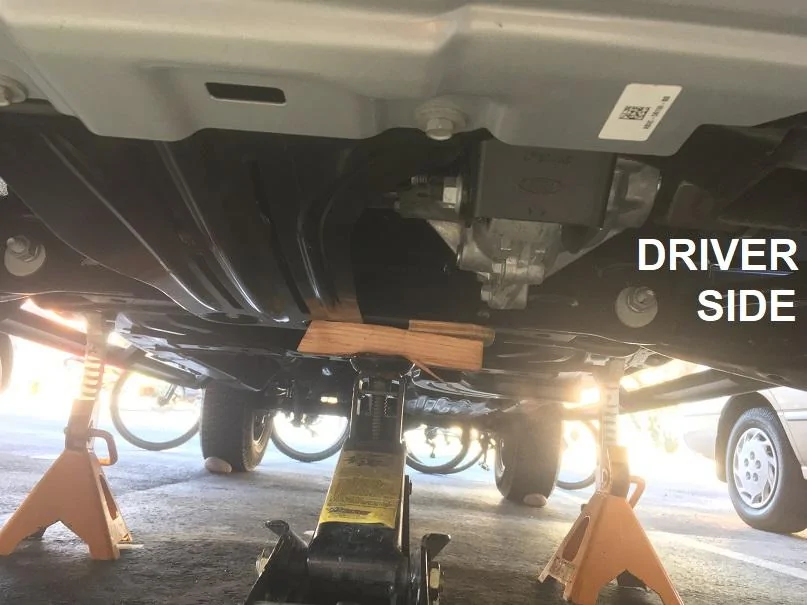

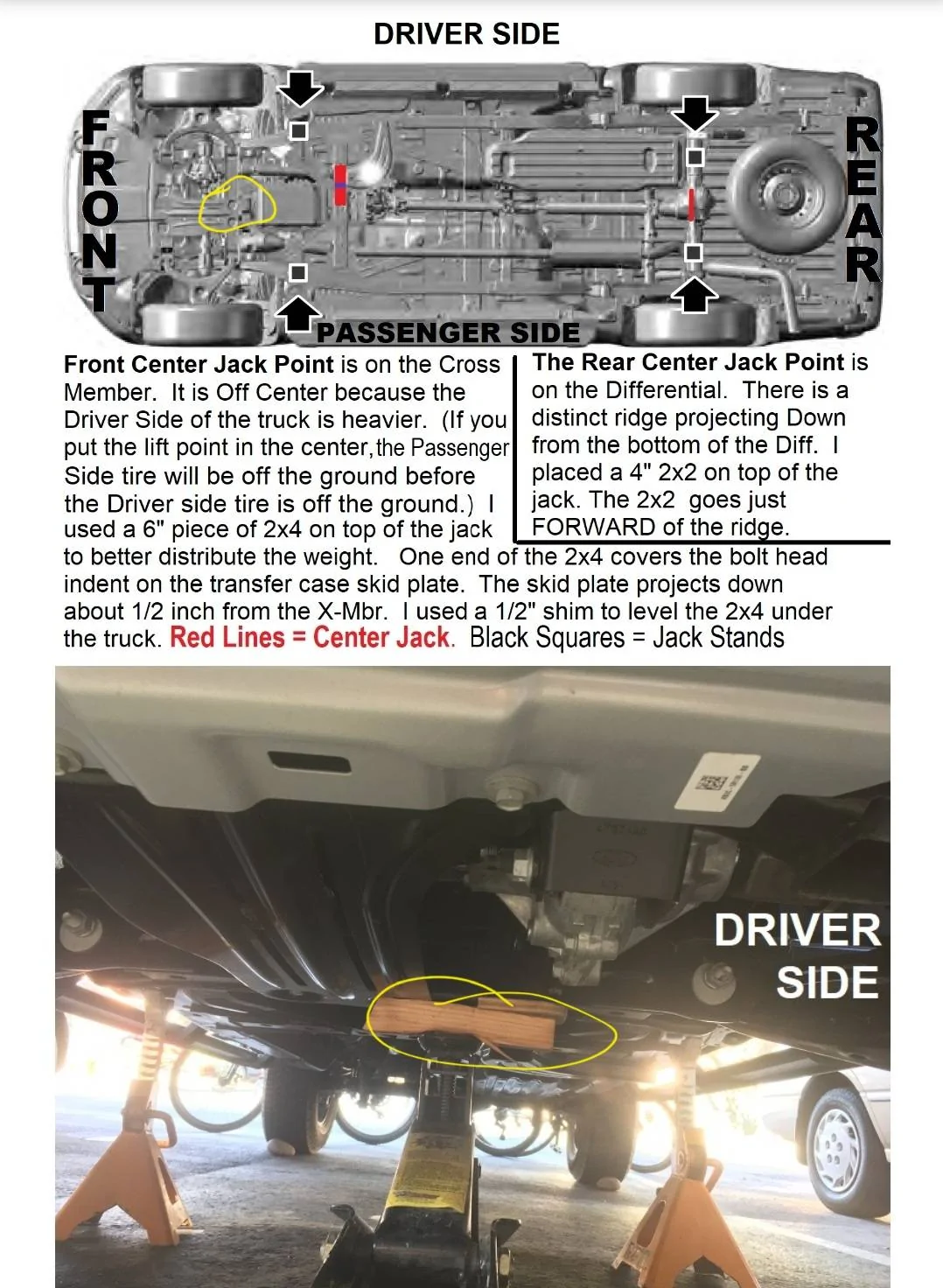

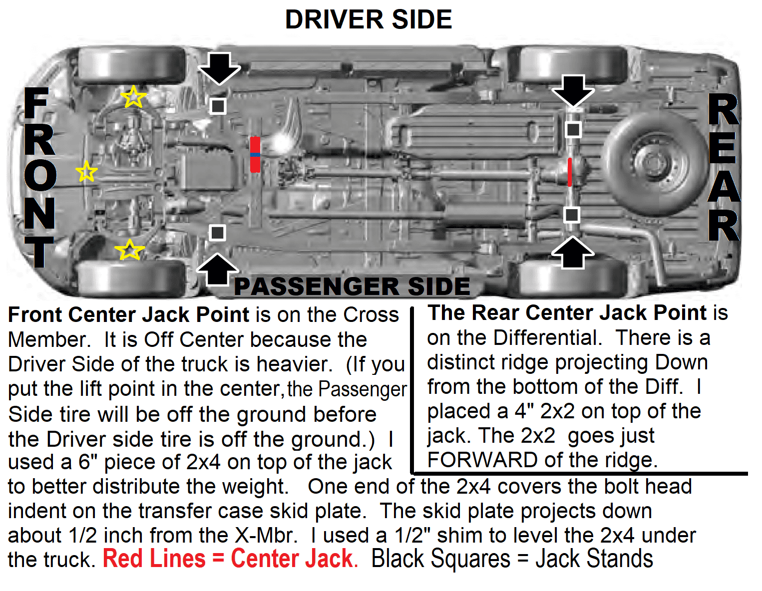

I could find ZERO Posts about where to locate a hydraulic floor jack to lift the front and rear of the vehicle before placing it on jack stands. Sorry if there is one already. Here is where I successfully lifted the vehicle using a hydraulic jack. Yes I have read that these are not sanctioned points and could break the truck. My truck did not break, nothing bent. I lifted up and down VERY SLOWLY.

Something to consider is the manual is written specific to the factory jack, and designed for the lowest common denominator user.
I never use the front factory recommended jack locations, until last resort. If I am lifting one wheel, I jack under the LCA, because it doesn't change the load on the vehicle. Two inches of lift gets the wheel in the air. The vehicle remains very stable, and the jack is all but impossible to kick out or displace.
Whereas jacking under the frame, require 8+ inches of lift to bottom out the suspension, before the wheel even starts to lift. Then the wheel will drag toward the center of the vehicle, because of the pivot angle and drop even more. This changes allot of load on the vehicle, and creates a higher, less stable jack. More work, and less safe.
If lifting both front wheel, I use the forward most cross member, in front of the wheels. It's where the bumper, winch, & skid plates all attach, and more than capable for a lift point.
Lifting a single rear wheel, I use the recommended locations. For both rear wheel I go under the diff.

the rear is likely right under the diff.
this is pretty sketchy, but it did get the job done.
what did you need it up on 4 axle stands for?
i personally like the round rocks as wheel chocks, and i assume the bikes at the back are for stopping it if it rolls the other way.
Right under the diff, yes. Sketchy, yes. 4 stands as needed to remove all wheel to install 1.25" billet spacers to fit 295/70R-17 tires. Bikes to camouflage the work from prying HOA spies ( : o

Will the diff housing crack being on a jack stand? Seems Ford should put "feet" on the frame for jack placements. I'm about to rotate the tires...
No trouble w/ diff after setting it back down. 5000 miles later.
