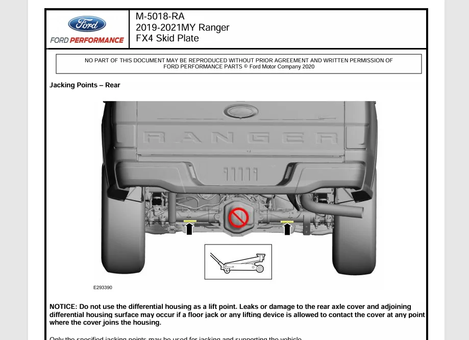

Sorry, old thread. I just wanted to share this thing I found while looking up jack points. I thought maybe that you weren't supposed to use rear diff jack point, but it seems they are just worried about the diff cover.

Oh well...I'll be using the diff to jack up the rear end till it break then...Ford should be more worried about their tranny breaking under normal use...
