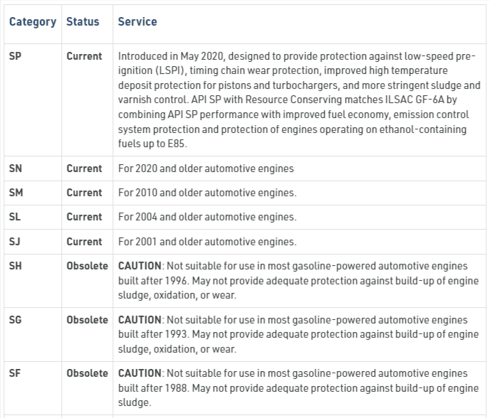

I'm general you are not wrong. It was recent that I got a good lesson in Oil from Motul(French Oil Company) when it comes to choosing the right oil for a vehicle. I learned that it was.more.than just the Oil Weight that you wanted to look at. For Gasoline Engines there is an API rating that has changed over the years. Most modern vehicles(I think starting after 2019) are currently using SP. Older vehicles require something different as it has a bit more stuff for additives and what not.
Here is a chart that was given to me by Motul. Kinda interesting when you get down too it.
Yeah, agree.....but I didn't want to open the API can of worms.....whole nother thread along with the usual syn vs dino/how often/filters/....on and on and on.....
