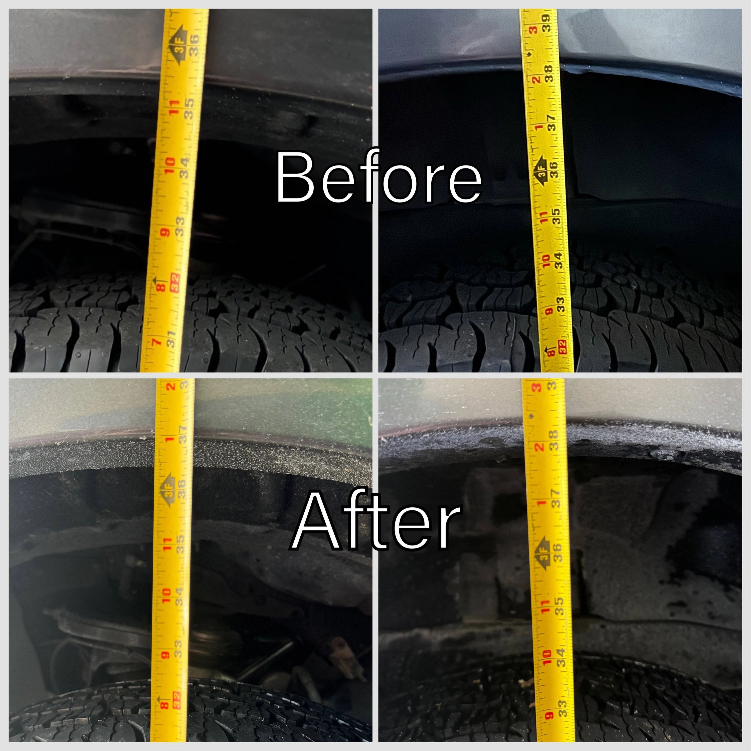

I went with a 2" ReadyLIFT leveling kit and got 1.5" height increase. I have a slight rake and it is what I wanted as I plan on having the occasional load in the back.
if I remember correctly from what I had read when looking into it, 3" would get you leveled but might be nose high with a load in the back. Of course if someone chimes in with a 3" leveling kit on their truck, listen to them.
Hope that helps!
Original post that shows the height difference.
Got a 2" ReadyLIFT leveling kit installed and an alignment done today.
Not the straightest measurements but close enough
