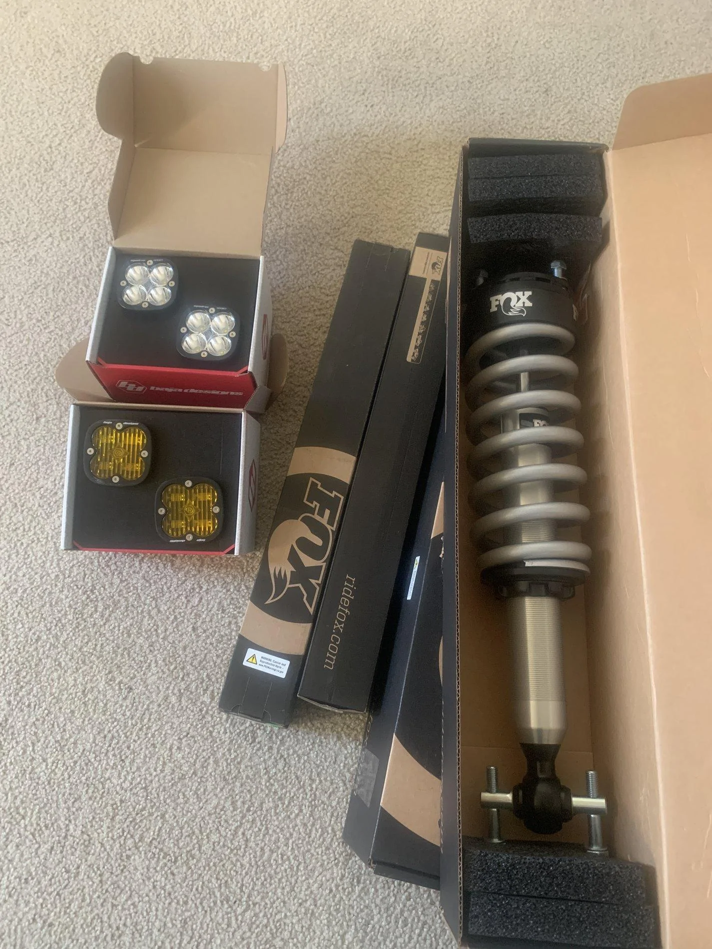

Front coilovers came in today! The rear shocks arrive tomorrow.
I'm a bit frustrated though. I got them from stage 3, who said they were in stock. Apparently the UCAs are on backorder. No one told me. I only found out because I called today to verify what was in the second package coming tomorrow.
If I hadn't asked, I would have been surprised and confused (and a bit pissed) tomorrow when receiving the second shipment.

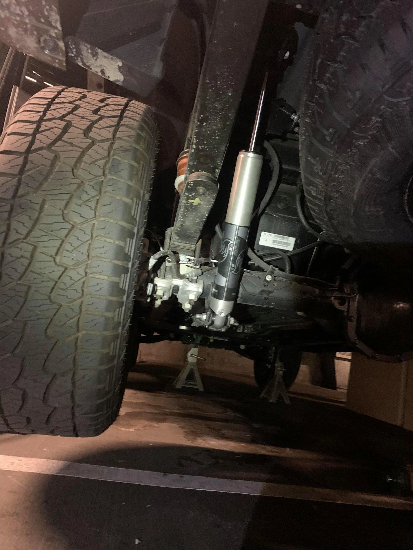

I decided to go ahead and install the rear shocks on my truck this evening. Man, it was kind of a pain in the ass. I removed one without putting the truck on jack stands no problem. When I bolted the top of the Fox shock, I used the nut for the bottom which doesn't have the square washer.
Unfortunately I tightened it enough that once I realized my mistake, it was threaded into the nylon in the nut. Which meant I couldn't loosen it by hand. And the nut just spun and spun. After messing with it a bit I realized the bolt was long enough for me to push it out and get enough of a grip on the nut with a wrench.
The next and way more frustrating part was compressing the shock enough to get it mounted. At this point I decided to put it up on jack stands which made it way easier. Lifting the truck up dropped the axle enough that I only had to compress it a couple inches.
The other side went much easier now that I knew what needed to be done. After that I uninstalled the useless running boards.
It's kind of a pain to lift with this high lift jack - I had to sort of shimmy it up, raising each side a bit more each time. Does anyone know if the trailer hitch frame is safe as a jacking point?

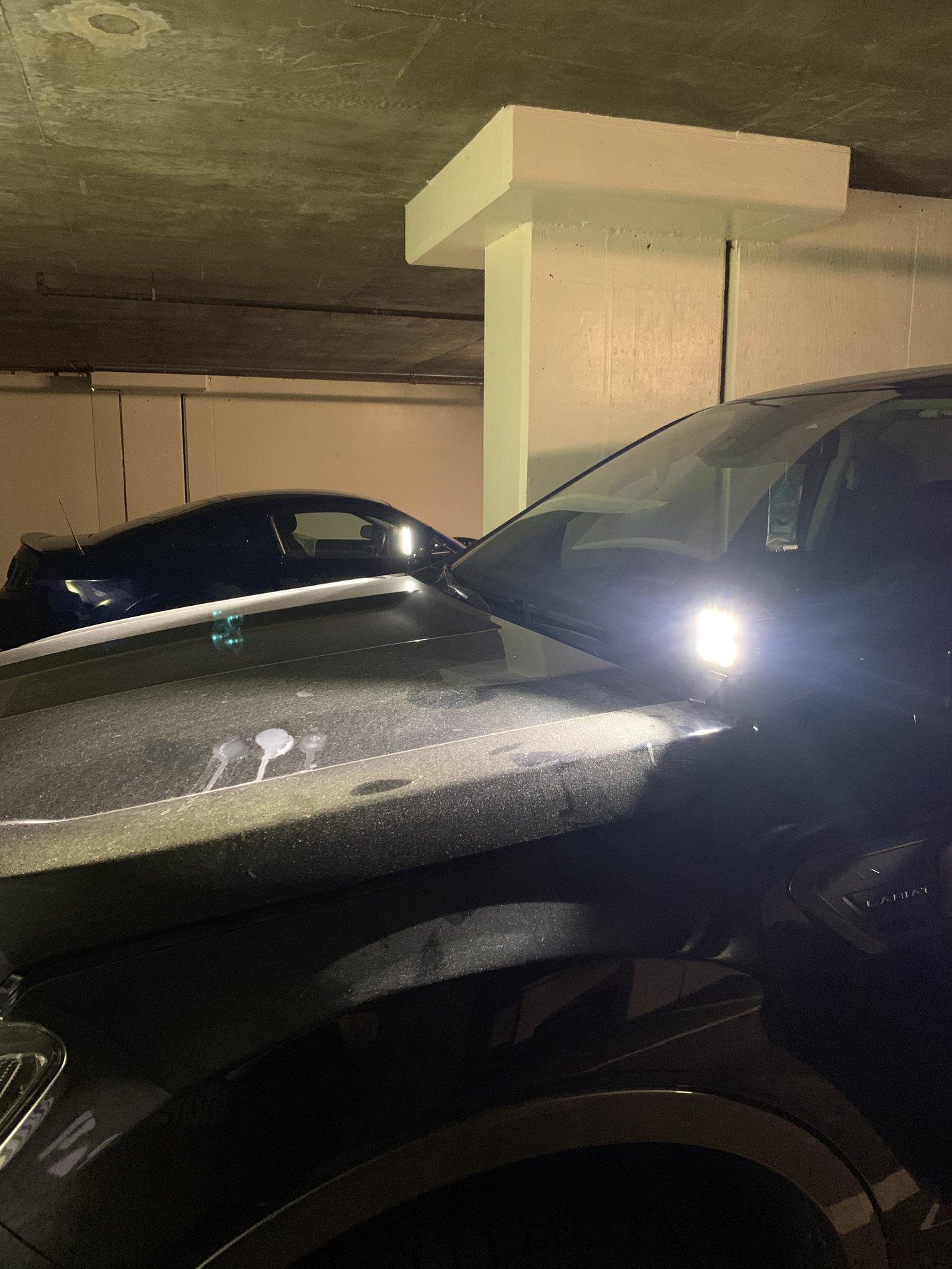

Still waiting on exhaust. It got delayed for some reason. But I did install my ditch lights this evening. I haven't figured out where I can run the switch through to the cabin, so I disconnected them for now.
Here's how they look on my dusty boi. I'll wash it after I install the rest of the suspension and get the new wheels/tires.
A bunch of guys used to run a drop hitch so they could jack the truck up from the rear. The drop hitch added extra height, so the jack didn't need all the work. Jack it up and place the jack stands, should be good.

Thanks, appreciate the help. I've decided to just hold off until I get the Trigger relay :)
For jacking, are you saying the trailer hitch can support the weight in the rear? If so I can find/make a shim.

I don't want to confirm the Ranger hitch can support the weight, but the Raptor hitch definitely did. You can absolutely use the pumpkin (diff) to jack up the truck, then place the jack stands and lower the jack. I assume you don't want the axle jacked because you'r trying to drop the axle to install shocks. But either way, use the jack stands.
