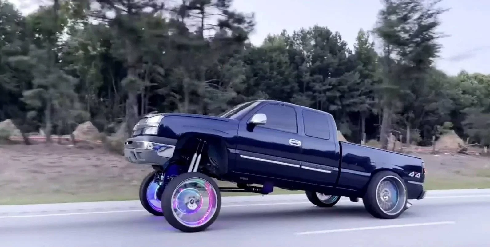

For the love of the sweet baby jesus, please don't perform a puck-based carolina squat on your truck.
Not only is a three inch lift going to stress the hell out of your CVs, ruin your ride quality, and limit suspension travel, but you really can't just modify the front suspension only, call it "a leveling kit," and leave it there. Different, conflicting spring and damping rates front to rear are going to cause your truck to handle and ride like shit, impact stability etc etc etc etc.
Optimal dumping position (and who cares if the tailgate drags on the ground). =)
