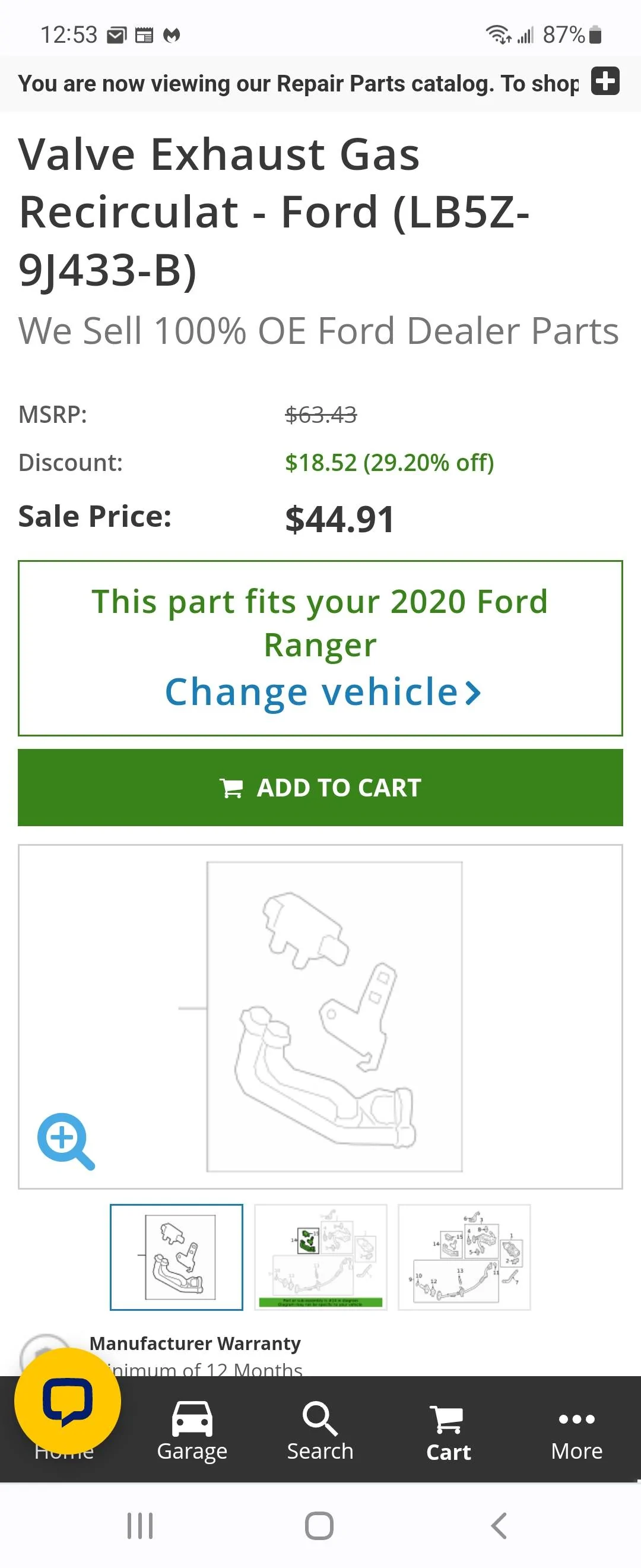

Is this the part that everyone is talking about and its fixing the buking issue? Attached is from LevittownFordParts.com, Benny is in the forum here. I think I'm ordering one cause I feel a bit of bucking .
+1 That’s as cheap as you’ll find it.
Just my luck too, I ordered one off eBay last week because my dealer was out of stock and it was a few dollars cheaper from a eBay Ford dealer in FL.
Not sure if this fix my stall but I’m going to give it a try.
