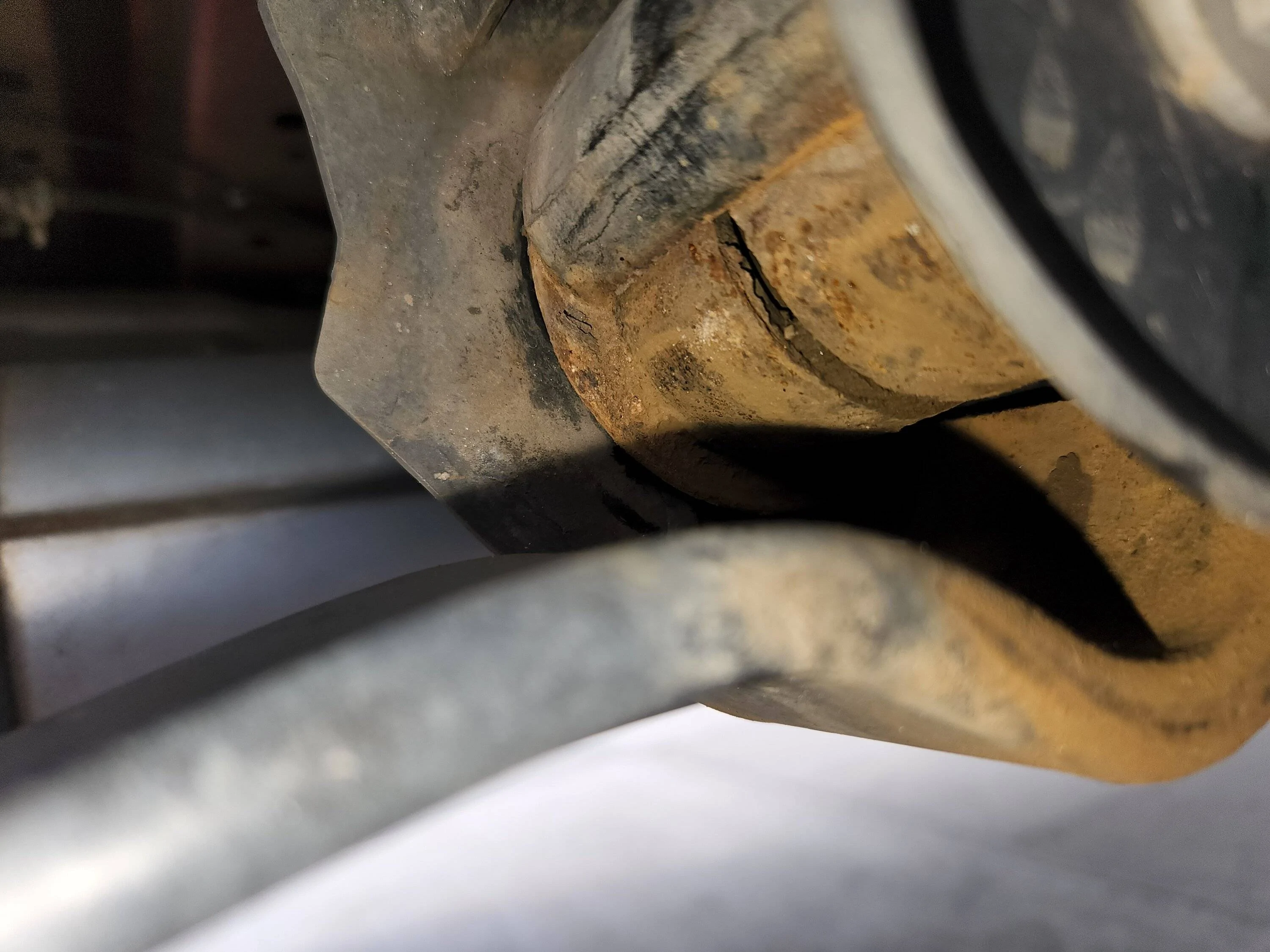

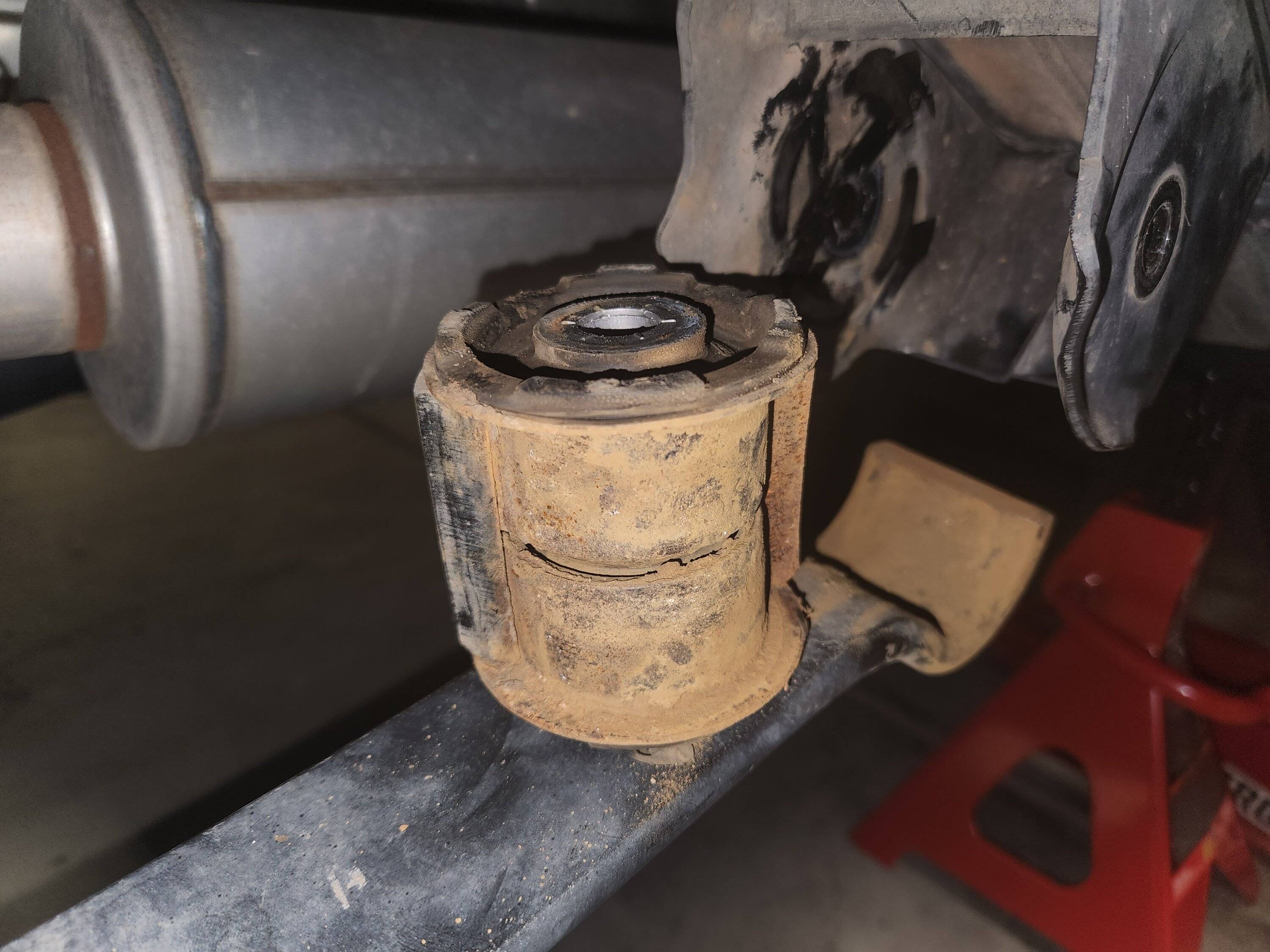

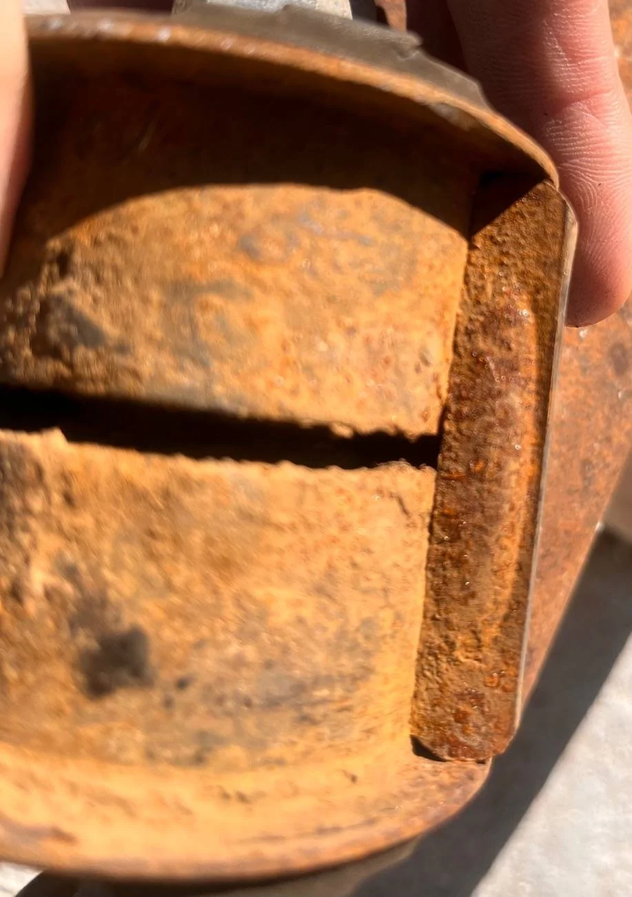

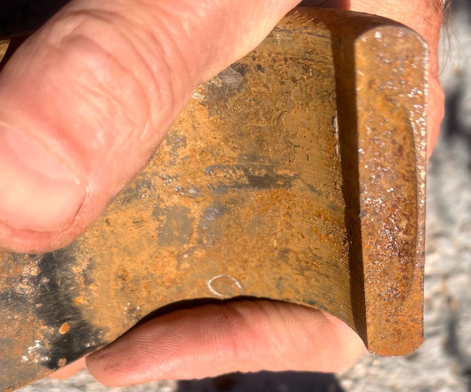

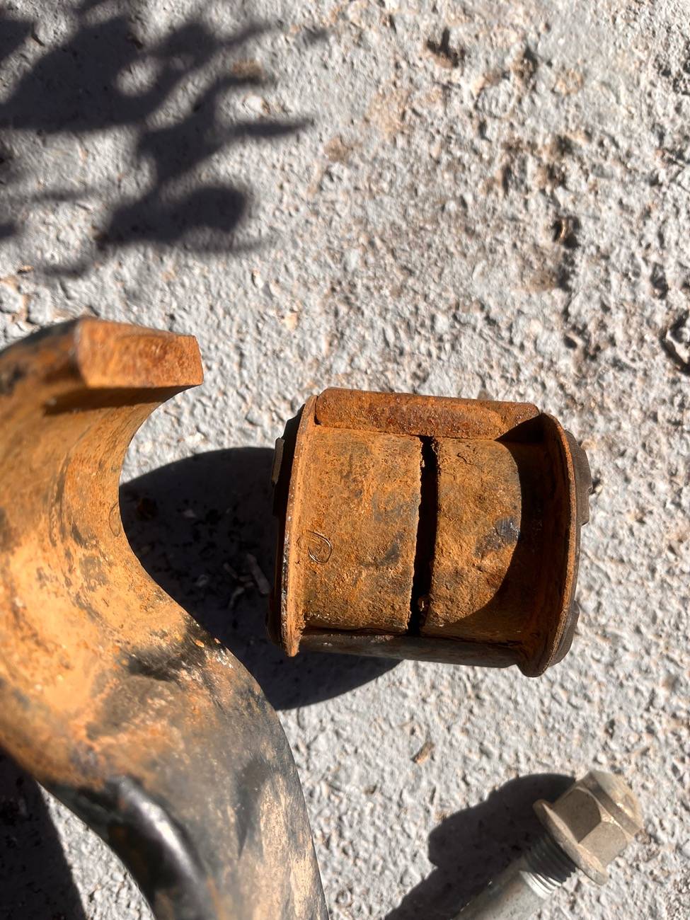

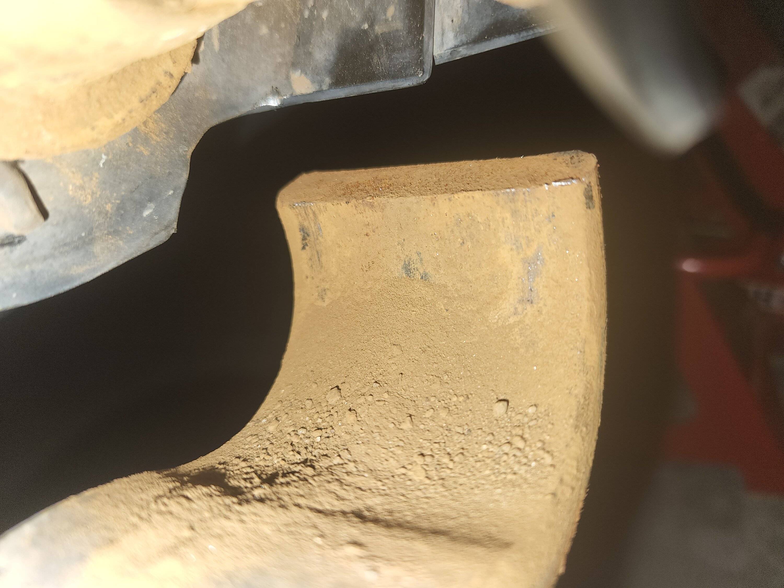

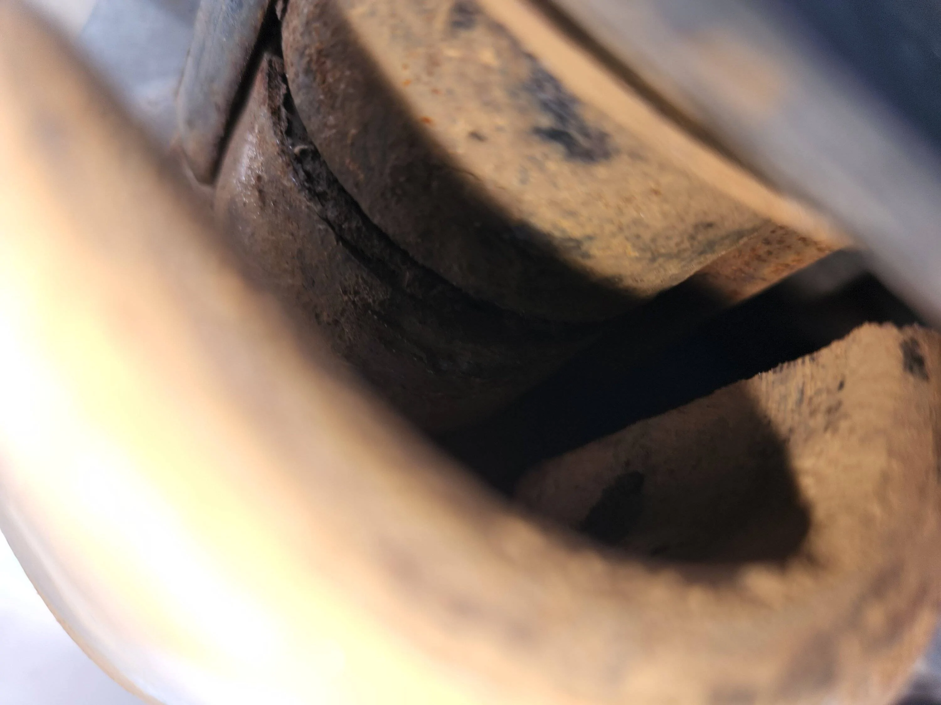

ouch! I know someone will likely say you must have been jacking it wrong ( lets not get into that lol ) . However, I would not expect it break. I would try warranty for sure and see what happens.
My situation is different but worth mentioning. few months ago i had a decent spin out of control and went into up and over the median with a pretty stout curb. then into some sign poles. truck was not hurt too bad mainly bumper damage from the poles and lots of scrapes. but the accident did bend and shift my leaf springs and hardware nearly a full inch on the rears. the side that got the curb first was over a half inch out of the norm. my point in that story is that even though i bent up the rear leafs and hardware none of it broke. The trucks full weight plus all the inertia from the speed i was traveling etc hitting solid concrete off angle is more force than simply using a jack to lift the truck or any average driving damage you could have done.
If you look closely at the spring you will see it is rusted a positive sign it has been that way for awhile. So no he did not do that by way of a jack.

Considering the small sample of owners represented by this forum and the frequency of this very specific issue I think we've identified another issue common to the 5G that needs to be addressed... and Ford should be fixing it at no cost to owners.
More than a few of us moved off the monoleafs for other reasons already.
They will not even own up to the transmission issues they have and they well know there is a issue with them.
